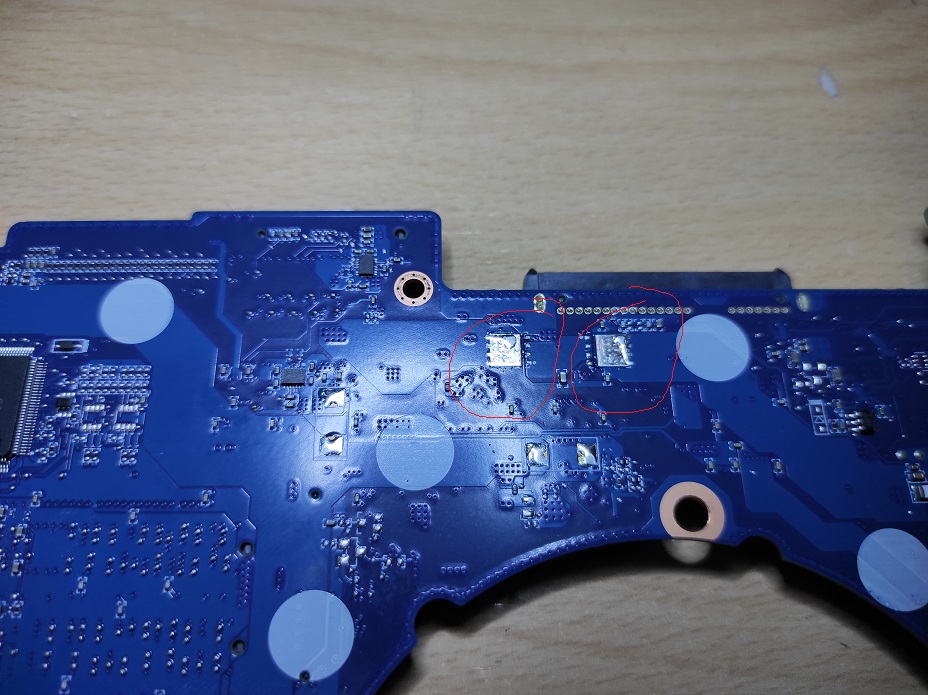

        Hello friends. Im have got a asus fx504gm-en480t with board dabklimbaco rev:c
        I buy it yesterday.The guy said me that dont work. When I open and see the board dont have got two mosfet and chip for charge the battery. Its possible schematics for repair?
        • mon2
          • Dec 2019
          • 14002
          Re: Asus rog fx504gm schematic/boardview
          Unable to find schematics but post clear and zoomed pix of the area that is missing the mosfets / parts.
          Also post clear pix of the charger IC that is missing. That way, can know the # of SMD pads & package on the device.
          Perhaps it will help.
            Its pictures of components.
            DABKLIMBACO REV:C
            I dont know that ic need. Thanks

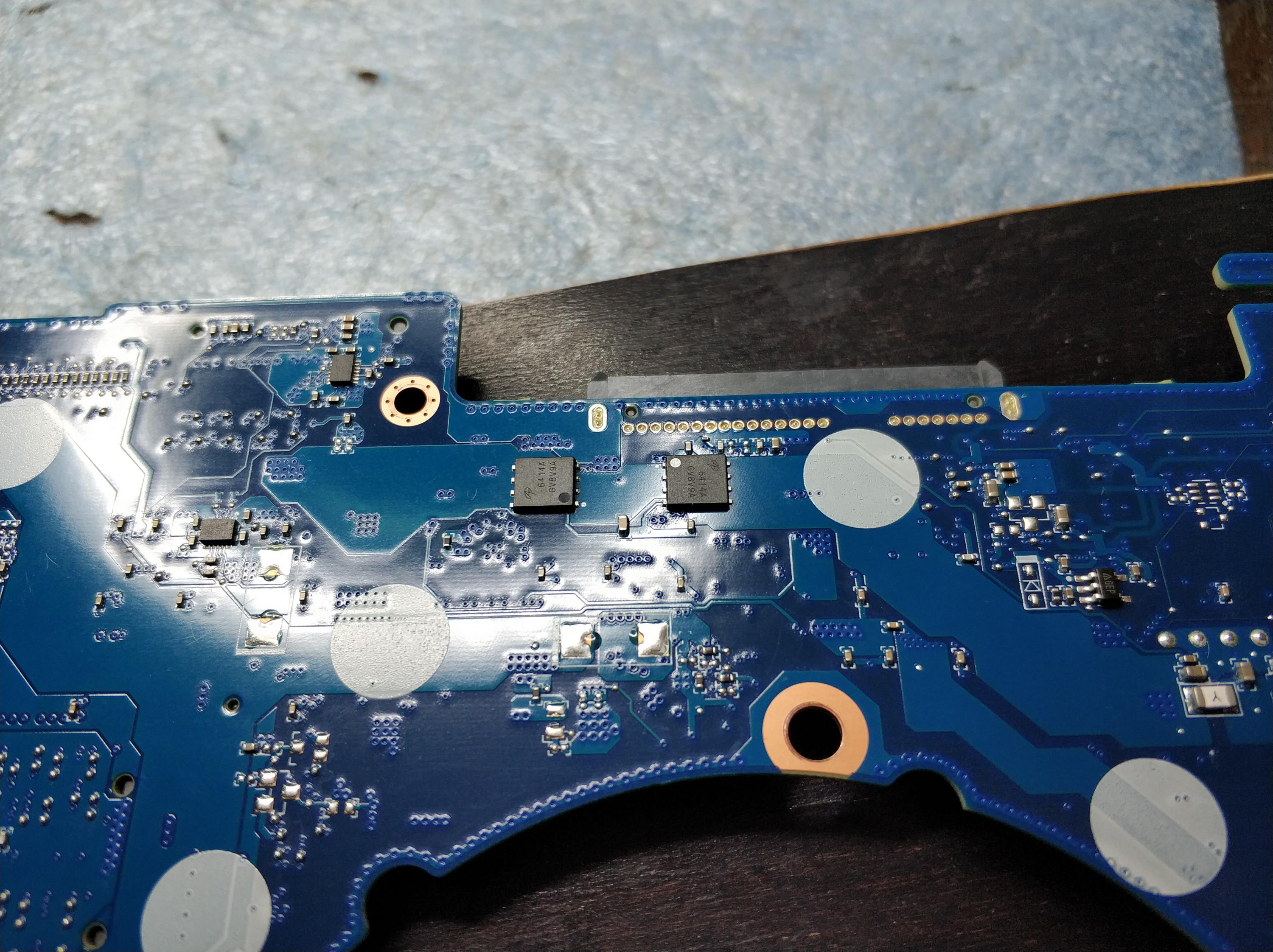

              @codigopin: hi man; if you still need it, here it is; only, be carefull, my mainboard is DABKLIMBABO REV: B, but i think is the same, for the chips you missing.
              Asus FX504GM
              Mosfet near cpu is 6996, dual mosfet.
              Those two near hdd connector are the same, simple mosfet 6414A.
                    Asus FX504GM
                    Very thanks!
