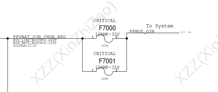

        Meter in DC volts mode (20v or higher scale is ok). Measure the voltage to ground of PPBUS_G3H @ fuse F7000 or F7001. Do measure both sides of these fuses with the power adapter connected (for now, disconnect the battery).
        If there is no voltage present here, remove all power (no adapter / no battery) -> meter in resistance mode. Measure the resistance to ground on each side of these same fuses.
        Post each measurement.

          Hi mon2, thanks for your valuable help and sorry for the delay, I only have access to the lab in the morning these days.
          I measured the voltage both sides of the two fuses, always measuring 12.6V​
          • mon2
            • Dec 2019
            • 13908
            This is a good voltage. T2 has booted and the SMC has boosted this rail to 12v6.
