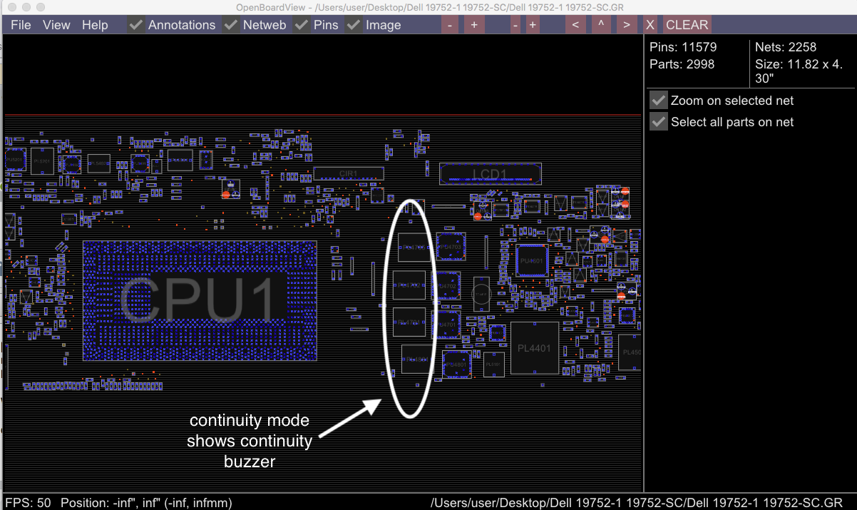

                      #30
                      Cpu core inductors resistance to GND will show very low values like 3-6 ohms and its normal. It seems you are making conclusions in a haphazard manner without grasping the technicalities involved-perhaps 'coz of lack of experience.That's why i dont like the idea of a non technical person attempting a sophisticated repair and blowing things away.Its always better to seek help from an expert in the field and most often it turns out cheaper then the expensive damage.
                      What i've stated is a general observation and in no way under estimates your capability (honestly i dont even know about your technical understandings).
                      continuity shows the row of inductors are short ? or is this normal?
                        You cant check cpu coils on diode mode.It'll always buzz. Set your meter to ohms lowest scale(say 200),short your meter probe,note the resistance between probes and then put black probe to GND,red on coil. What's the reading on coil and reading when you shorted the probes.
                        As stated earlier, cpu coils will show very low resistance and thats normal.

                                #35
                                coil from top to bottom in the pic
                                3.9ohm
                                3.9ohm
                                3.9ohm
                                5.9ohm
                                shorting probes is .7 ohm

                                  #36
                                  So that proves there is no short on cpu coil. However, since you injected 8V on a 3.3V rail, your PCH is very very likely fried.
