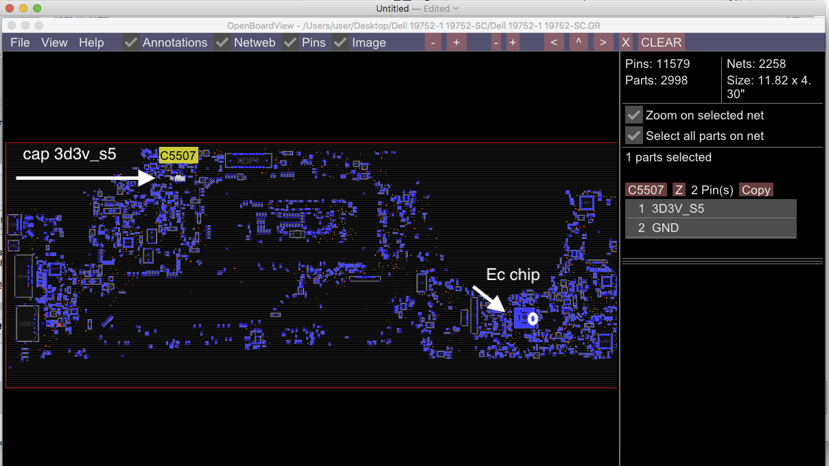

                                i inject 8v and 1.9amps into the 3d3v_s5 capacitor and the EC Chip is heating up quick ?? does that mean the EC IC is short or a capacitor?

                                  the EC chip is heatup with 8v 1.9amp injecting in the 3d3v_S5 capacitor circuit it is no near the EC chip, image added
                                  the circle in white shows area is heating up with 8v injection on EC

                                    is this the short or did i inject too much voltage and the ic will heat up too much viktage injection

                                      Who suggested you to inject 8V? I advised to inject 1V
                                        The main issue here right now is that you did not read what was repeatedly advised and even worse you formed wrong conclusions caused by lack of experience. Example: A quick look at the actual physical location of Pin17 would have clarified instantly that it is tied to Pin16 by design. And from where the hell originated the idea to inject 8V into a power rail which is supposed to run with 3.3V max?
                                        Now you likely don't deal with only a dead EC but also with a lot more dead components..
