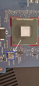

    Hi
    Totally new to this website/forum, so apologies if not the appropriate place to ask, but.....
    I'm trying to diagnose my son's laptop motherboard.
    Power jack led on, power button led on, but I think post fails. CPU cold and no voltage around CPU graphics card.
    I start to suspect power rails, or PCH or CPU.
    I did a close visual check and find an inductor that looks in a sorry state, next to what I think might be the PCH. I can only see 2R2 I (or L), but from reading, this is not enough to identify the various specs required to get a like requirement.
    I have no board schematic or board view.
    Can anybody help with what to look for? I don't want to blow up the PCH, CPU and/or graphics card by guessing!

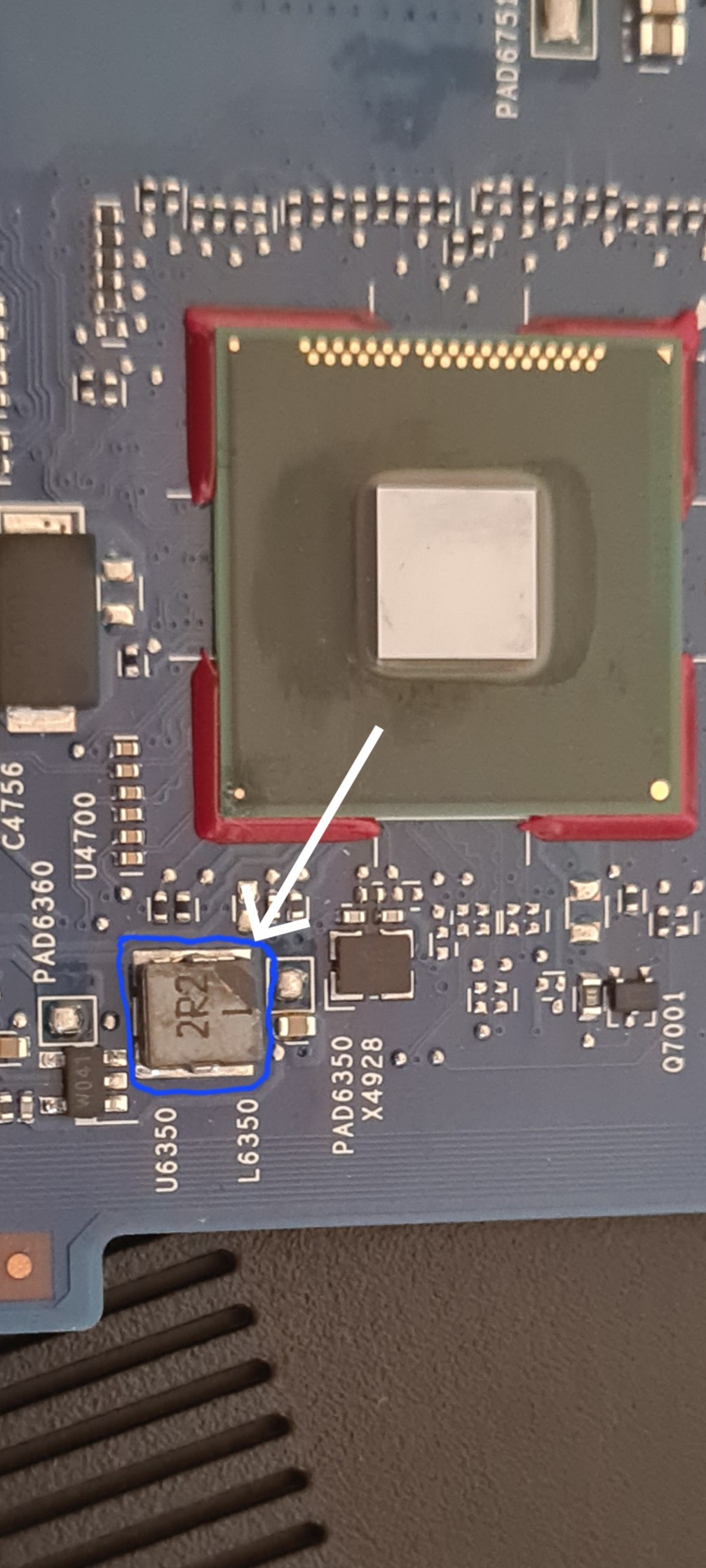

ID:	3206134 Location of PCH and bad inductor
      • 22264
      Post the motherboard model number
      https://www.badcaps.net/forum/troubl...r-s-guidelines
      1.1.3 Motherboard model number

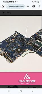

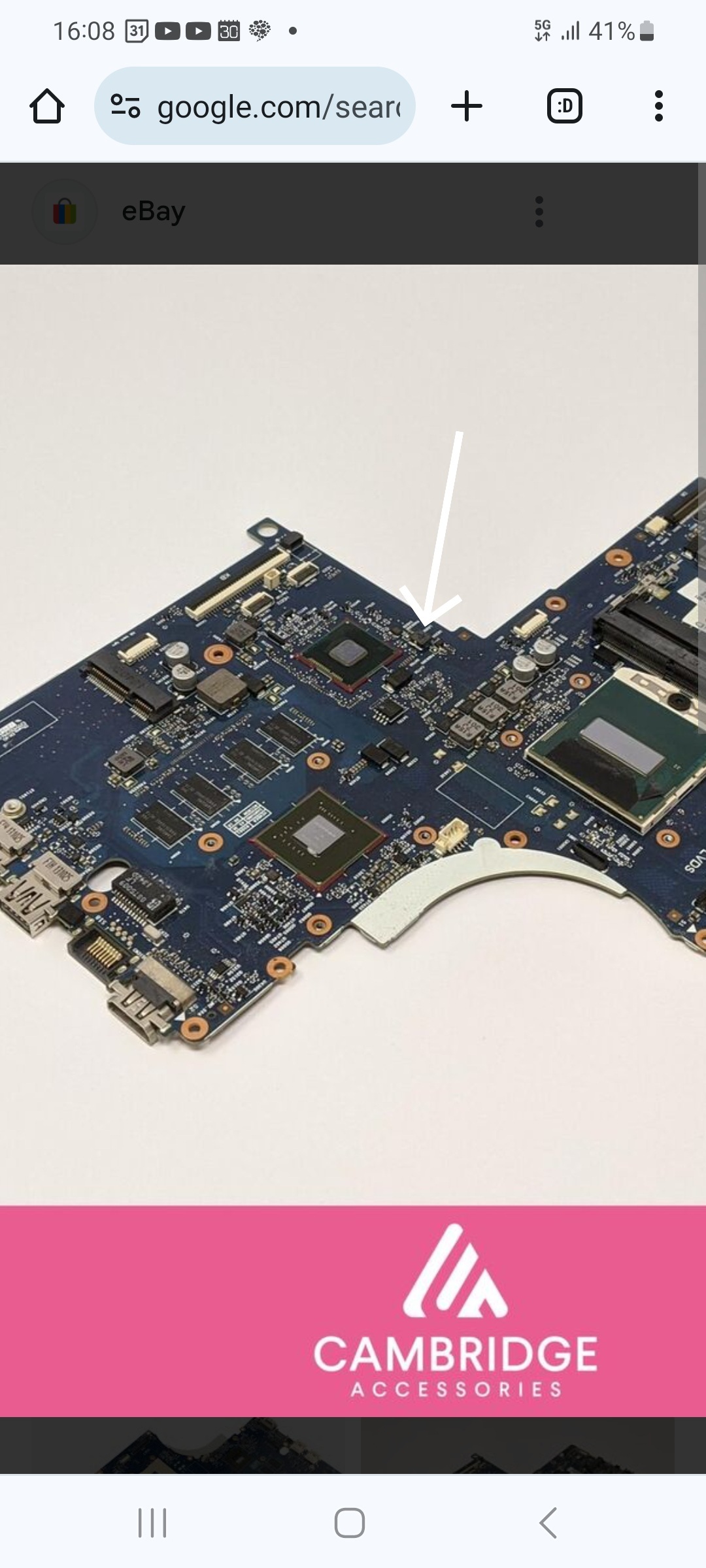

        Wider view Click image for larger version
        Not the bad board, I lost the photo. But this is the same location on the actual board

          I believe the bad board with bad inductor is:
          For HP ENVY 17 - J184na
          SPS 720266-501
            • 22264
            SPS 720266-501
            Inventec 17SBGV2D 6050A2549801​ ,there`s no schematic available. The inductor is 2.2uH ,desolder it completely or on one side and lift it so the its not touching the pad, then measure the exact resistance to ground on both pads and post your results

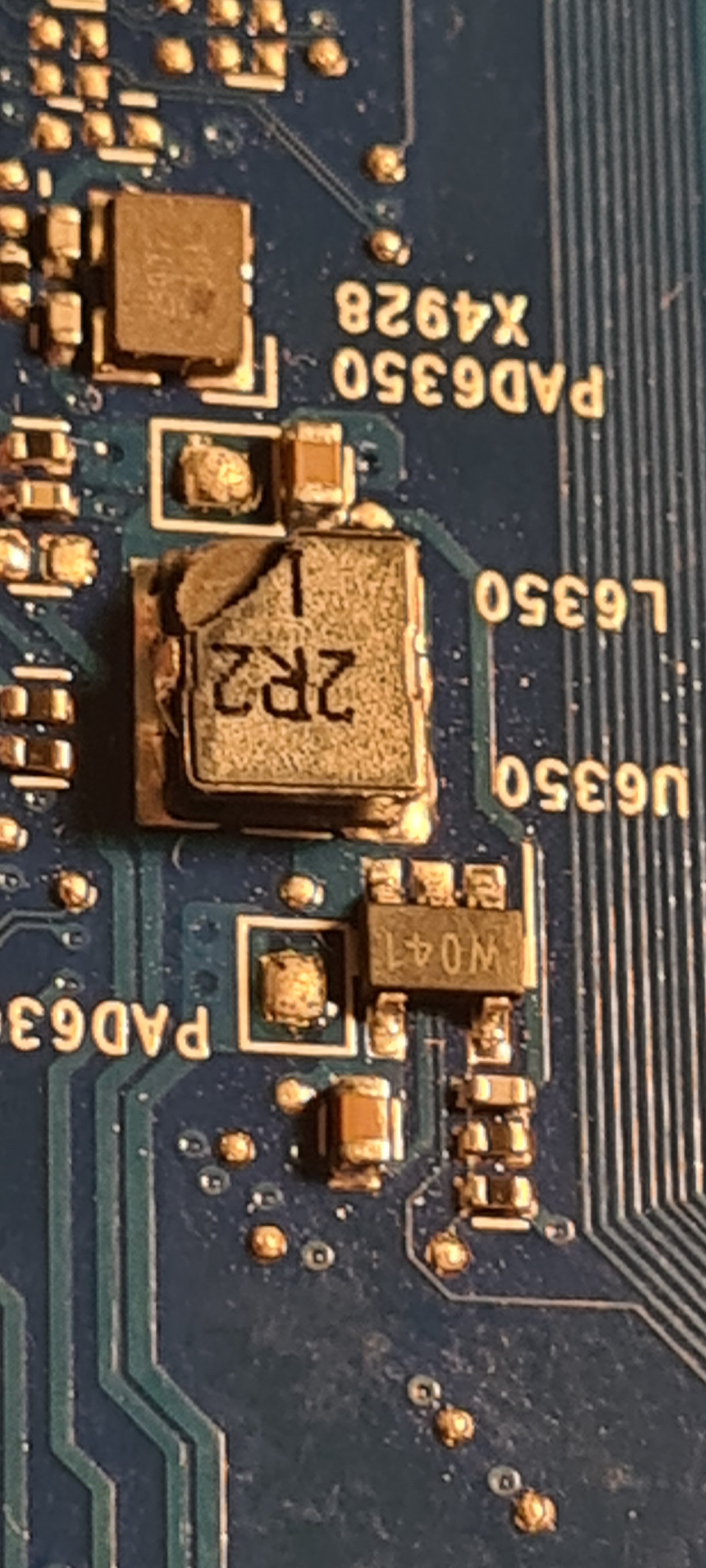

                  • mon2
                    • Dec 2019
                    • 14832
                    To me, the inductor does not appear to be defective. The broken corner looks like the shield casing was chipped from a physical drop of a tool or similar event. Inductors are available in shielded and non-shielded variations. This is a shielded version.
                    remove all power. Meter in resistance mode. Measure the resistance across this inductor. It should be close to 0hms.
                    measure the resistance to ground to check if the power rail is shorted or not.

                            • mon2
                              • Dec 2019
                              • 14832
                              Share the physical size of this inductor. We know with 2R2 = 2.2 uH. We have found that brands like Bourns / Pulse and a few others offer higher current rated parts than offshore companies. Do also measure the height of the part. Then can go on the hunt for a suitable device. The inductor will have a normal operating current rating and then a saturated current rating. At the saturated point, the current will heat up so will be an increase in temp over ambient. We do not want this logic board to become an air fryer so best to find the highest rated device for the physical footprint.

                                  • mon2
                                    • Dec 2019
                                    • 14832
                                    The inductor is required to complete the DC-DC switching regulator (BUCK mode) design. Without it, this power rail will be off.
                                    The following should be suitable (just a bit taller) - do confirm if the height is acceptable to your enclosure.
                                    SRP4020FA-2R2M Bourns Inc. | Inductors, Coils, Chokes | DigiKey
