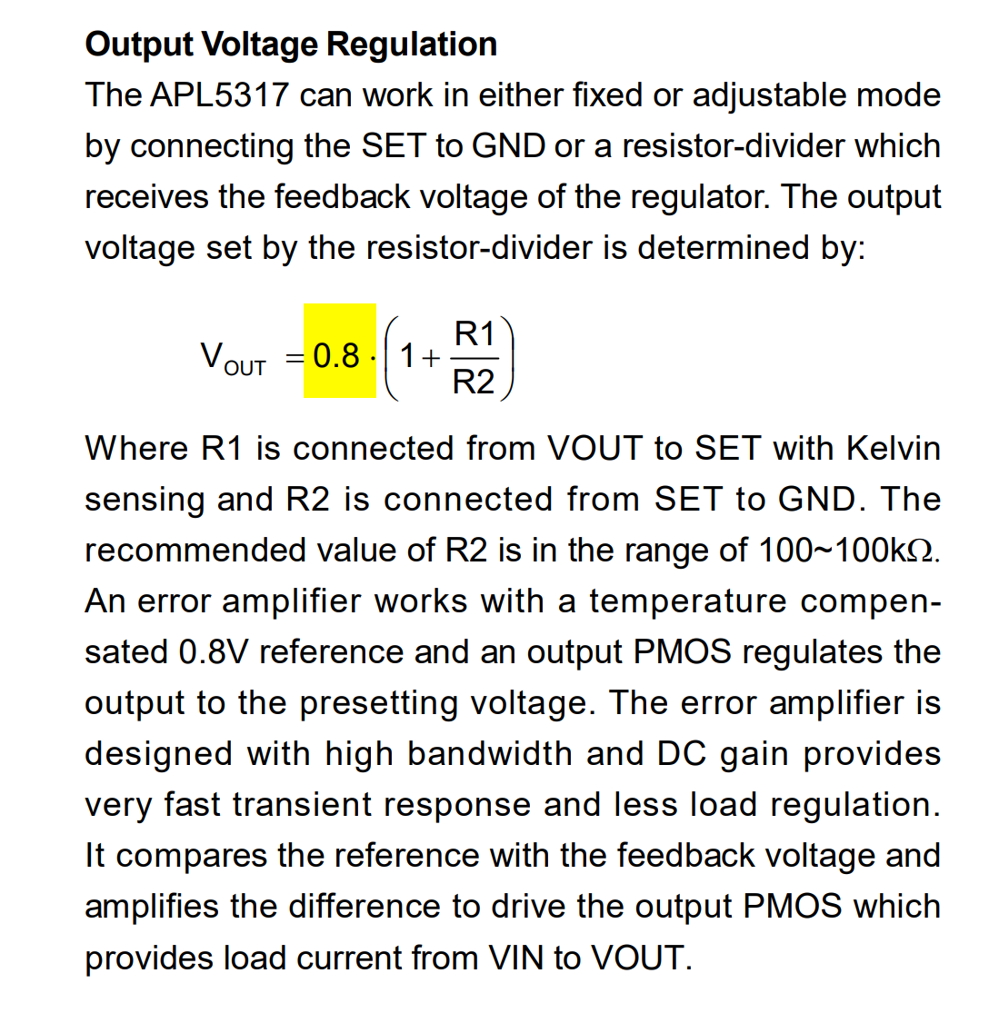

    EQUIVALENT OF IC APL5317
    HI EVERYONE
    HP ELITEBOOK 2540 SHORTED ON +5VLP LINE I FOUND PU303 APL5317 IS THE CAUSE
    I DON'T HAVE THE REPLACEMENT OF THIS IC
    IS THERE ANY EQUIVALENT IC ?

    Post a clear pic of the original part on the board. We need the full part number to determine if this is a fixed or adjustable ldo. Yes the part can be replaced with others but need to confirm a few details. Also the replacement part should be ceramic cap friendly.

      according to the datasheet is Adjustable Output Voltage Mode .

        So this is an adjustable SOT23-5 positive regulator.
        The full datasheet is attached.
        It is important to review the Vout formula on page # 9.
        It is:
        To replace this part with another - the regulator must be:
        1) SOT23-5 ; very easy to source
        2) Same footprint ; should be easy as well
        3) 300mA or higher ; common
        4) positive LDO ; common
        5) The formula is the same as above ; be careful here since many LDOs use 0.6 as the multiplier (not 0.8). If using a 0.6 volt LDO for the multiplier, the resistor values will have to be changed so that in the end, the SAME Vout is created.
        Share the details of the next LDO before proceeding.
