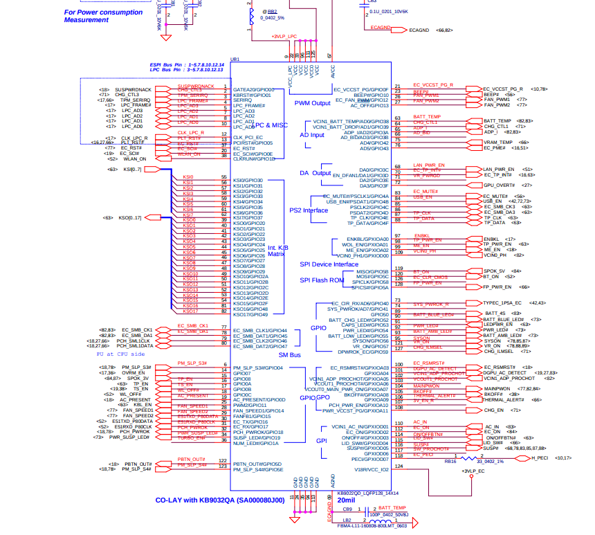

              I have measured the voltage at the fan connector and seems like the PWM line is changing from 3.5 - 5v. The only problem is that I couldn't find the chip that is controling the voltage.

                check here, maybe this gives you a lead:
                https://www.badcaps.net/forum/troubl...pter-connected
                Maybe you have a similar case with a defective temperature signal mosfet on the smbus lines to PCH...
