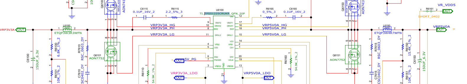

    Hi all, got the following issue. As soon as I plug in the AC power adapter or the battery, the laptop comes to life and the fan is spinning full speed. Wifi and audio mute button are lit, however the laptop is still off.
    When I press the power on button, the laptop runs normally until I put it to sleep or shut it down. Then I am back to the fan running at full speed and a lit Wifi and audio mute button.
    I've looked around, and it is basically the same problem as in this thread:
    https://www.badcaps.net/forum/showthread.php?t=93574
    I am wondering whether TPS51225CRUKR (U6100) is causing the problem in my case.
    Could someone have a quick look at the schematics and give me a clue, please?

    Re: Probook 640 G1 turns on when adapter connected
    Check Pg19.Pin3 voltage of Q7050/7100?? fan etc are running even in off condition 'coz your dc-dc transfer is happening without turning on. So something wrong in Pg19 circuit.
              TPS51225 is your 3V/5V PWM IC. Q7055 gate should be High so that ground(pin2) travels to source(pin3) as its a n channel mosfet. Once the ground reaches pin3, it will block P15VOA line and voltage wont be transferred on Pin4 of Q7050. This should be the boards behaviour in off condition.SLP_S3_5R status in off condition?
                  What i wrote about voltage transfer on Q7050 is absolutely correct. You seems not to understand it. SLP_S3_5R must be 3V in off condition and it should pull low only when turned on. So you need to findout why this is so.

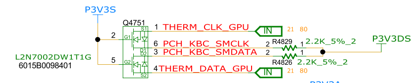

                      Finally got round to have access to a proper scope and upon closer inspection, I found that
                      Q4751, which is some sort of temperature signal mosfet, has got visible corrossion on all of its legs. The 640 G1 has no dedicated GPU, nevertheless, could this chip be the reason why the fan goes haywire as soon as the laptop gets voltage, but works normally when powered on?
                        Yes. The dual mosfets are acting like bus switches for the smbus lines which are feeding to the PCH.
                        In the absence of the thermal data, the fans can go into hyper mode.
                        Best to flux this part and reflow it with high heat but low air pressure so the small parts do not go flying.
                        Good catch to find this fault!
                            Just to close this thread. The original dual mosfet was defective.
                            Replacing Q4751 fixed the issue. Laptop works normal again.
