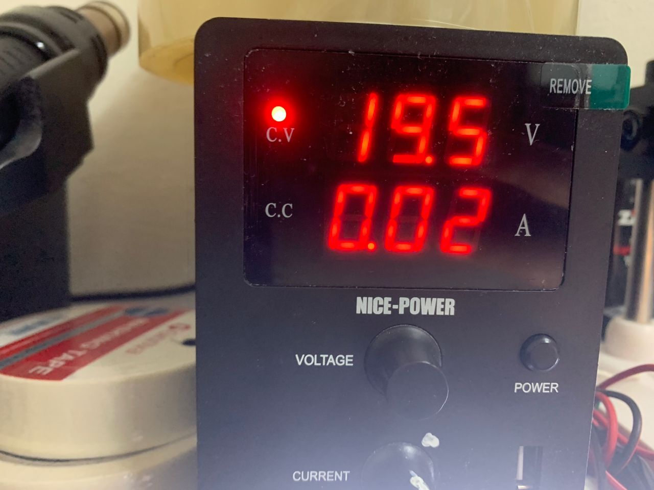

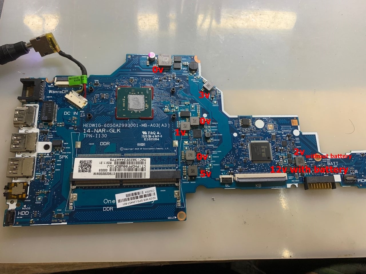

    hp 14s-cf0125tu wont turn on
    board number hedwig-6050a2993001-mb-a03 ....i cannot find the boardview nor schematic for this model ....the problem is laptop wont turn on....current load only read 0.020ma when press power button (standby 0.00ma)...here i attach voltage reading on every coil

    i try flash bios but still not working...1.8v present on bios chip
    • mon2
      • Dec 2019
      • 14662
      Check the resistance to ground of each inductor. Checking for a shorted cap on a power rail.

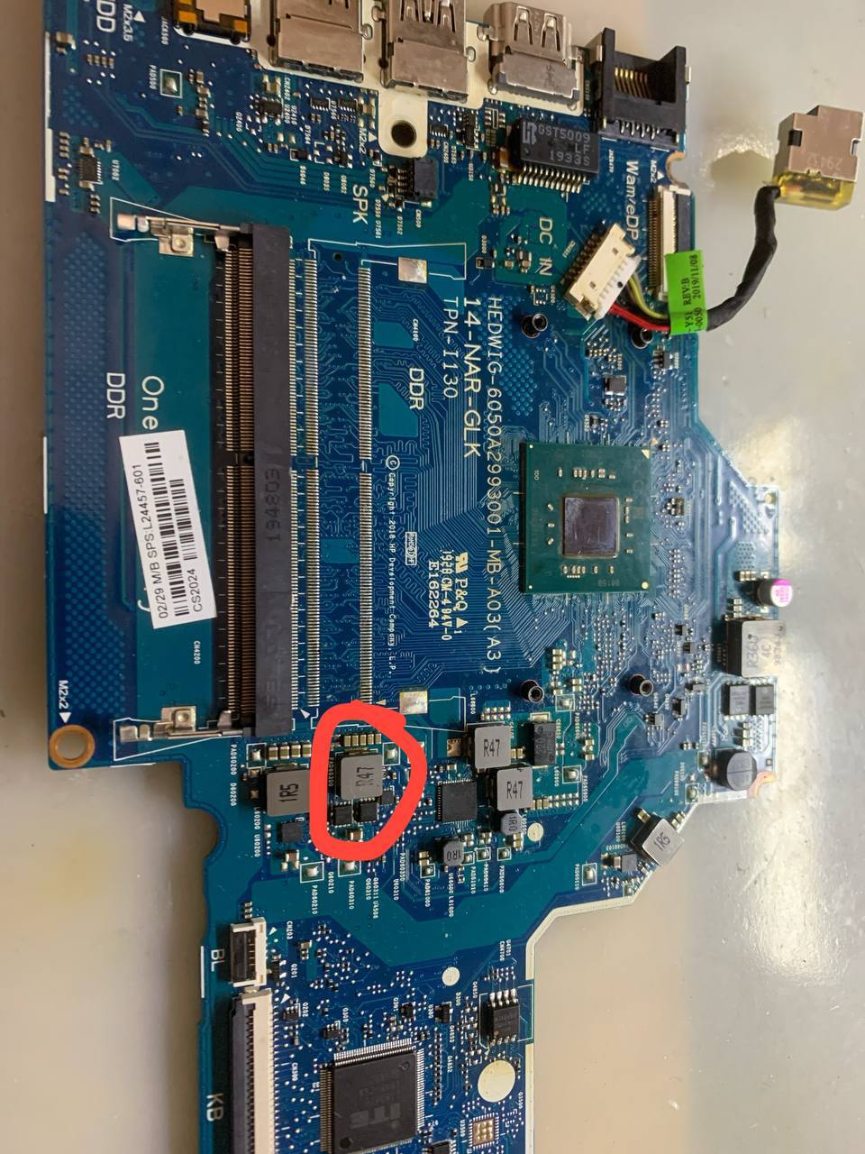

        no shorted cap on power rail....but i check on this ram coil no voltage at all...it should have 1.2v right?
