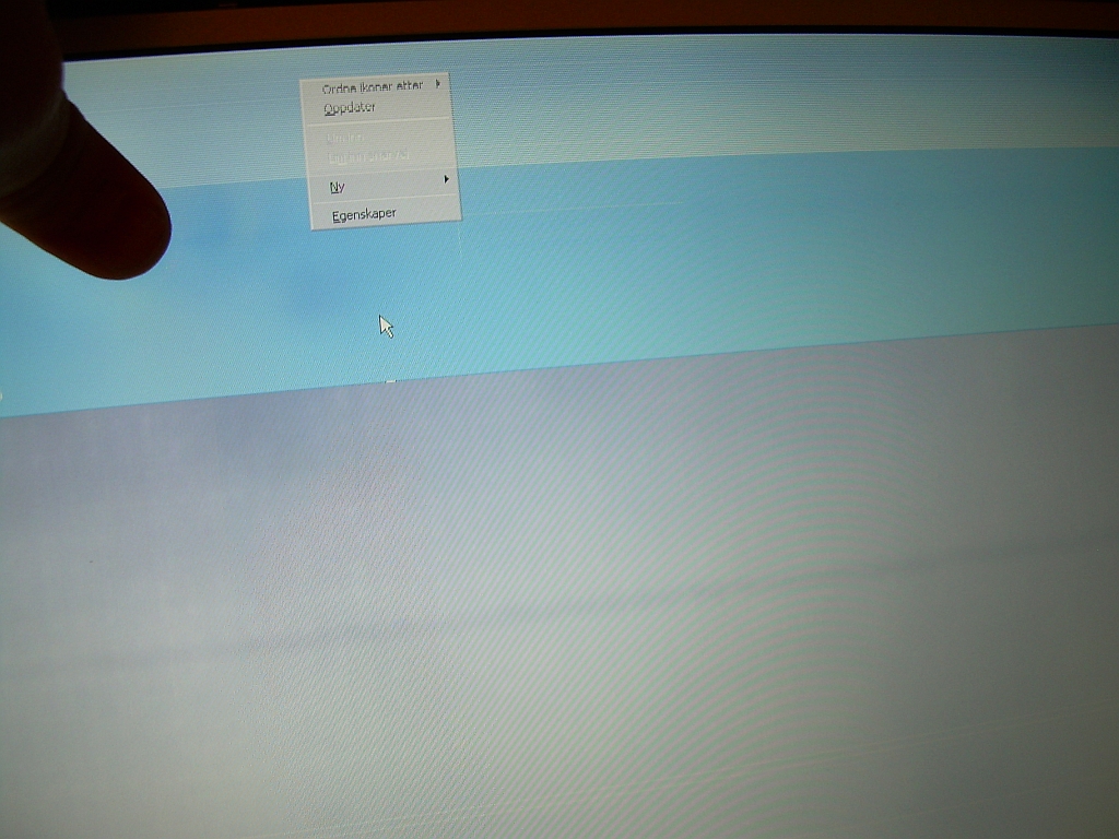

                    I got the 410I with intel using 1440x900 - as I understand it there are problems with these led screens according to my service center.
                    Had to replace my screen.

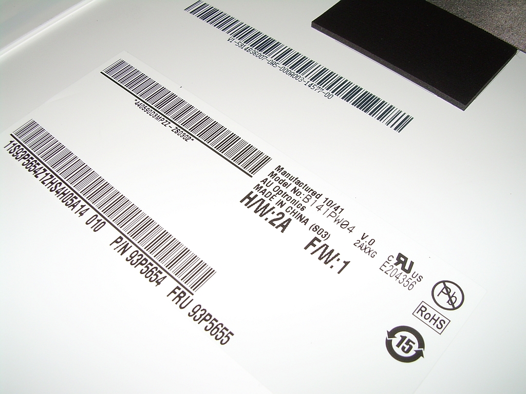

                          The b141pw04 have different connectors, some b141pw04 have 30,40 or 50 pin connectors.
                          The Dell won't fit at least they did not on my laptop, I don't remember but I think I ordered a monitor with 40 pin connector.
                          You should take out the screen and see if you have a 40 pin connector, even though you find a screen size with the same aspect ratio if might not be compatible.

                              The problem with that Dell screen is the backlight. It's CCFL, you need one with an LED backlight, as your ThinkPad won't have the extra power connector or an inverter for a CCFL backlight. Just pay the extra and get one that's actually advertised as being compatible. Basically, any higher res screen for a newer laptop is gonna be much more expensive than that.

                                      Well, since these screens have a high failure rate I did not want to buy a used or low quality screen so I payed 250$ US for a brand new one .. .. with warranty.
                                      Some users say the screen problem has come back even with a new panel.
                                      I did not replace the cable so I guess my cable is perfectly fine and only the panel was defect.
                                      Youtube
                                      Lenovo community
                                      Trust me like - just like c_hegge says you have to pay around 170 and up for these.
                                      There are no 30,40 or 50 pins adapters that I know of.
