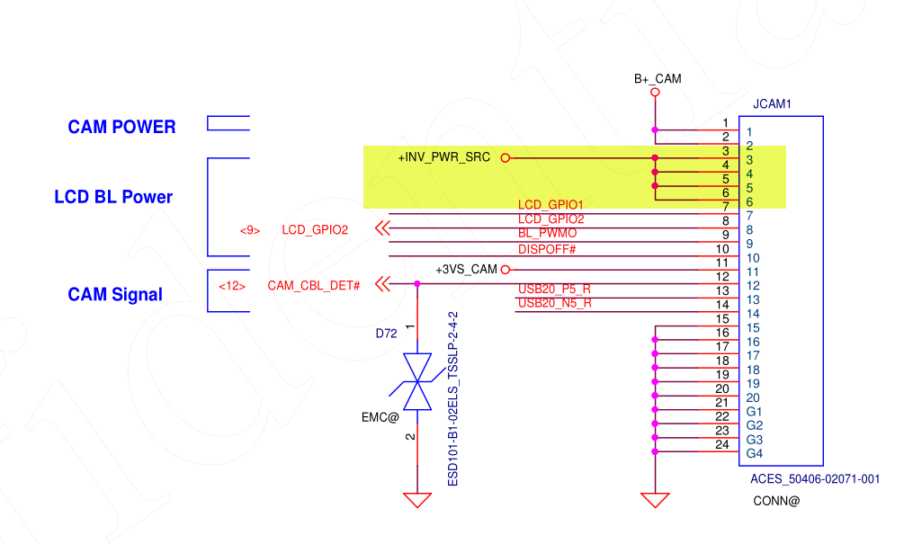

              on the Jcam1 socket I don’t find any voltage. I don’t understand why and if I need all the lcd cable plug on the motherboard to have a voltage. In the attachment I put the jcam1 picture

                Remove all power. Meter in resistance mode. Confirm the positions of pins 3-6 on the JCAM1 socket. Each pin should be shorted together so the resistance should be ~0 ohms (ie. meter on pin #3; next meter lead on pin #4 - should be 0 ohms since it is a short on the PCB). This is the backlight voltage from the load switch.
                See attached partial schematic.

                  With no power, meter in resistance mode, check the resistance from the jcam1 pins 3-6 to Vout on the same load switch ic. This is to confirm there is no trace break from the Vout pin to power the display's backlight. That is, in the end, if the voltage is present at Vout then the same voltage should reach the pins on jcam1 connector. The display is not required yet since we know the load switch is having the voltage at Vout pins.

                    Ok for the first test I have 0 ohms like you say. Interesting think I found the fuse F3 is blow again. I changed it again and now I have 8,80v on the JCAM1 but no change on the lcd. I think the lcd have a trouble

                      Hello i finaly found out. Thank you for the help.
                      The First trouble was the Fuse no doubt about it, and the second trouble was the lcd itself the flex pcb is totaly dead.
