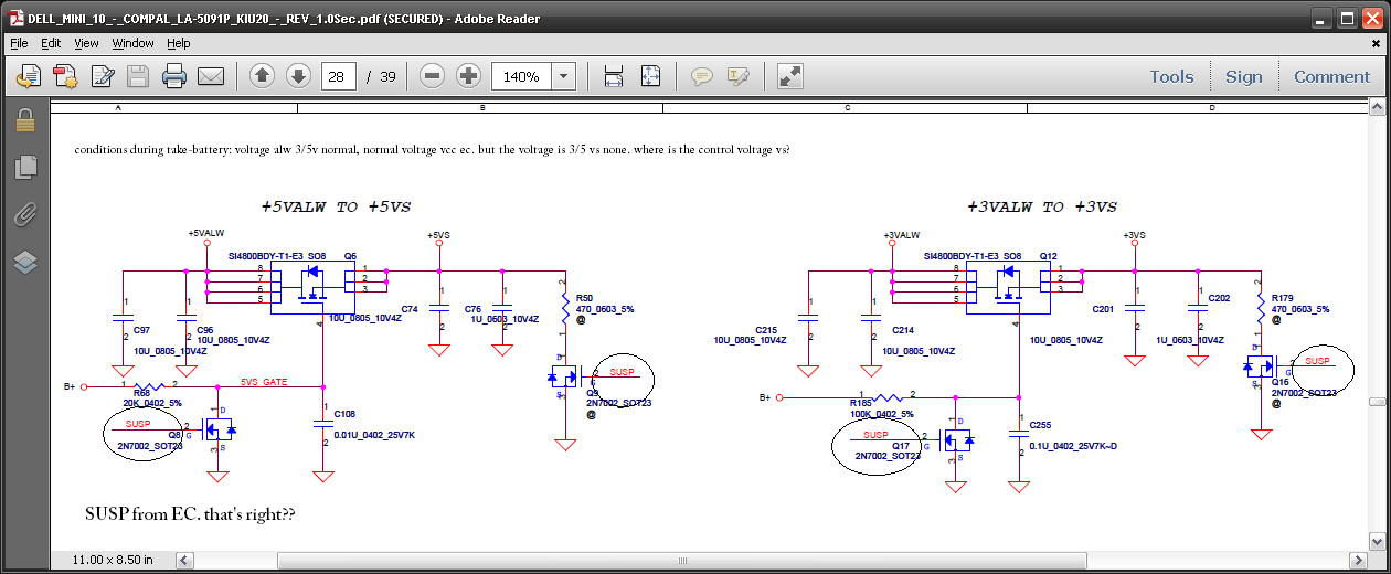

          Re: dell inspiron mini 10 cases
          conditions during take-battery: voltage alw 3/5v normal, normal voltage vcc ec. but the voltage is 3/5 vs none. where is the control voltage vs? maybe a problem at embeded controler (ec). help me give suggestion!!! thank you
            this schematics vs
                  I've change ec, but the problem remains the same. if anyone can add this problem?
