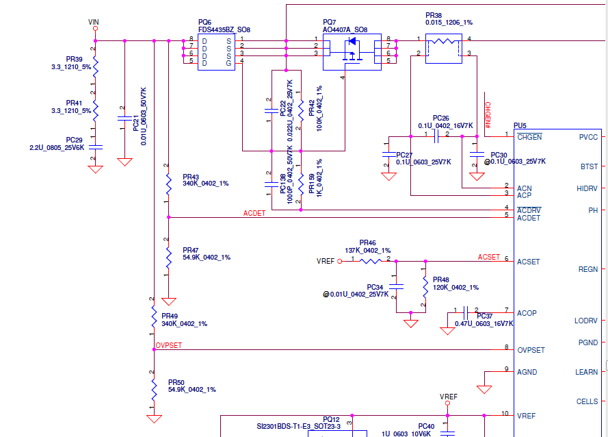

    Got this one this morning, board's clearly had a rough life. CMOS battery removed, lots of sticky residue (looks like some is from a reflow attempt and some is from the removal of mylar tape but I need to get it scrubbed off eitherway)
    Full schematic is here:
    Component PF2 (on battery connector) appears to be missing. According to this picture it's some kind of fuse, I should be able to grab it off another board. (Bottom left by batt connector)
    Voltage at the adapter oscillates from 1.4v to 1.6v. The adapter works fine (I am using my L300 from it now). A high pitched oscillating squeal comes from the board a few seconds after plugging adapter in.
    Components PQ6 and PQ7 (shown below) get very hot. PQ7 appears to be short. Nothing nearby seems to get hot.
    To do:
    Replace PQ7 - AO4407 MOSFET
    Replace PF2 - 15A 65v Fuse
    Replace CMOS battery
    Any other suggestions?
    Cheers

        Nah, haven't replaced the MOSFET yet. Can I replace the AO4407A with an AO4407?

            yes you can. any 30v P channel mosfet would fit.

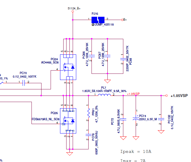

              Also, found another two, these are both scalding hot, and 0v through both PQ24 and PQ26. PQ26 is shorted (single digits on diode test, same as before). neighbouring PQ23 and PQ25 are fine so it doesn't appear to be related to TPS51124.
              It's also worth noting that PQ24 and the adjacent ceramic cap are sort of misplaced, like they've slid during a reflow.

                Also, is it normal for the non-shorted MOSFET to be hotter in the pair? It's the same in both cases.

                    Re: Toshiba L450 Completely dead - hot MOSFETs
                    Replaced PQ6 and PQ7, ACIN is now 4.2~4.7 volts. PQ7 nearly burnt my skin off when touched - should I replace it again?
                    PQ24 and PQ26 also heat up.
                    There's now a stable 3.1v near the BIOS chip (as opposed to 0.45 before), though. That irritating 0.8~1.1v oscillation is still there.

                        Seems to be infinity. There is a brief flicker on the DMM display when changing to 200ohm or to 200kohm settings but nothing reliable.
                        Also, PQ26 changed, no change whatsoever. I think this low ACIN is key though, what could be dragging it down from 19v to 4~5v?
                        Only thing I can think of doing is replacing PQ7 again, the AO4407 that practically burns your skin off when touching it.

                          Resistance at VIN, PL3? Check PQ8, PQ9.
                          • spleenharvester
                            • Mar 2010
                            • 921
                            VIN resistance to ground appears to be about 56kohm.
                            PL3 resistance to ground appears to be infinity, with only very brief displays on the DMM when changing settings.
                            Resistance across PL3 is 1.2ohm.
                            PQ8, the diode test is working both ways? Is this normal?
                            PQ9 not present, this seems to be normal looking at images of other identical boards.

                                      Checked every FET on the board, only ones I found shorted are PQ26 (which has been replaced as it showed as shorted before) and PQ25.
                                      EDIT: Also, the ticking sound I mentioned earlier - it's not just coming from the above fets, it's coming from loads of different areas on the board.

                                        PQ8, gate-source and gate-drain resistance?
