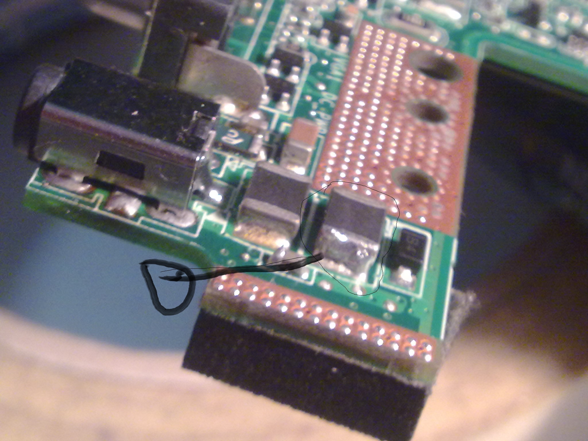

    hi guys this is my first post i upload imag of mother board
    i havedata sheet but cant understand some one help us to which value is that ??
    this motherboard no voltage cm out from dc jack near dc jack this caps (i think) is broken senier members most experienz person suggestion will aprisciate thanks,,,,

    These two black components are inductors .It looks like melted solder (someone messed with it ?). Have you checked the voltage of power adapter ? If no voltage comes out from dc jack then you should resolder it or replace it .

      no these r capsor smd cremeric cap i ceck with data sheet i will check if i will find them &risolder...

        Are they marked Cxxx or Lxxx (xxx is number) on pcb ? I've never seen ceramic cap with black color .

          on data sheet is 3 caps and 1 diod they dont marked notthing

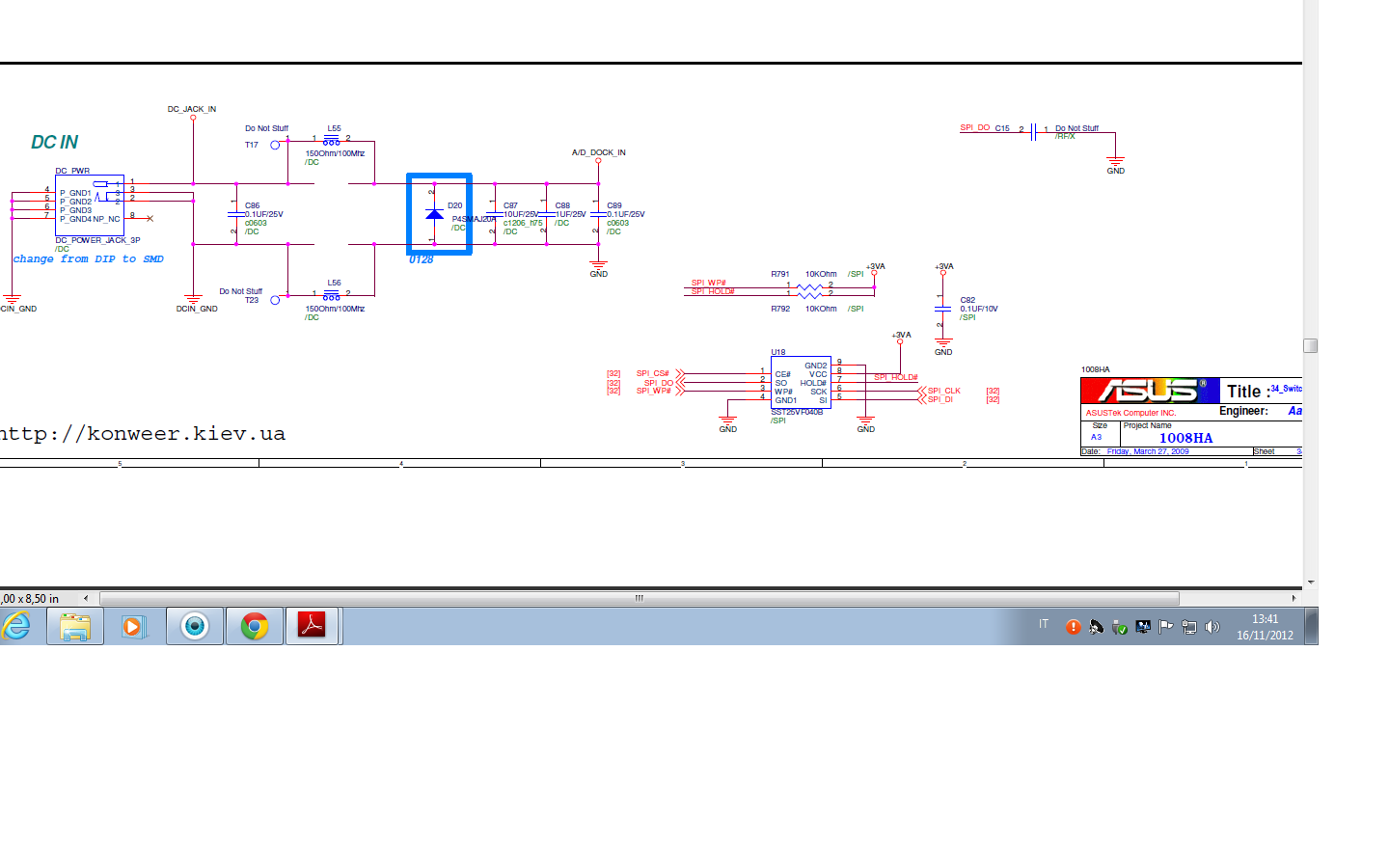

            You attached the wrong part of the scheme. Find where is AC_IN or similar and attach that. I will then tell you what to measure.

              I know this is a bit silly, but Asus netbook often had problem with the jack it self. Broken pins. Do checked it. I came across a few units. Change the jack and power is back.
                here can u help us ...
                  i find this

                    i try old one jack is broken i chang sold new one nothing ;(
                      Re: asus 1005ha net book
                      The schematic looks like incomplete.
                      Anyway I think netbook there isn't a lot of mosfet, have you tried check if those mosfet shorted?

                        Measure voltages on PQ622A and PQ622B

                          tehzeeb,
                          those are inductors indeed. i can see it with the scematic you posted.
                          that is L55 and L56.
                          1. check first dc output voltage from DC adapter plug. if voltage present
                          2. check dc voltage on L55 with respect to ground.
                          3. if no voltage present, remove L55 and test pin 1 of dc jack. if no voltage, check c96 for short.
                          4. if c96 good, replace dc jack
                          5. if voltage come out after step 3, check d20, c87, c88, c89 for short
                          hope this helps

                            guys i retried resolder dc jack buy new supply charger now problem is this no voltage cm out suddenly 5 mis or else they trun on automatically led off display work yes all work fine if i wann shut manuly doest turn of mauly doest wat u think guys ? in short trun some time plug in power u leacùv trun on automatically no shut down

                              Try to touch SMD Cap between fan and usb port , if you hand get hot while charger plug in , replace that cap and your done ( been there before )

                                that case for ASUS 1005P
                                  degutji... thanks a lot... capacitor is shorted
