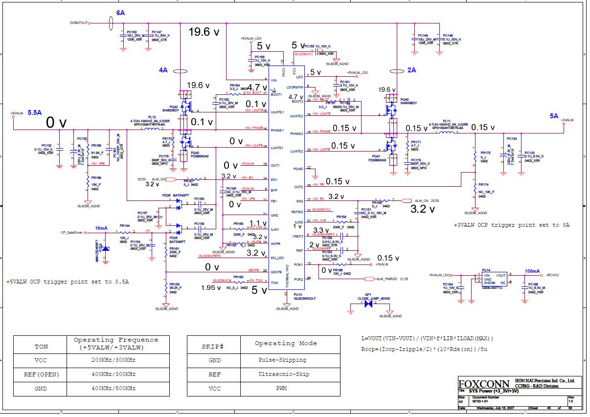

    Hello everyone
    I have a VAIO mainboard without "ALWAYS ON" voltages. Laptop was operational before with a broken dj-jack. After disassembly, an inductor fallen from mainboard, without a reason (pressure from my side or hit). I resolder it with a 25W, fine tip, lead free solder. After that, mainboard is dead.
    Below the inductor are four MOSFETS, so i am thinking that something has to do with them.
    As you can see at attachments, i measure all voltages around power chip..
    Fallen inductor was the PL12 and the MOSFETS i'm talking about are PQ40, PQ41, PQ42, PQ43.
    Any ideas?

    Re: MBX-182, Always ON (3V, 5V) voltages are missing
    try replacing isl3286
      replace the dc-dc ic as the en1 and en2 supply is okay alternate check for 3alw and 5alw short resistance with ground.also check bios.sony vaios have this problem
        Thanks for replies
        I think that both of you mean the ISL6236, thats the dc-dc ic, am i right?
        5ALW is at pin 10 (OUT1) and 3ALW at pin 30(OUT2)?
        I'll check it!
        How can i check bios with dead mobo?
          Originally posted by Nightwalker
          Thanks for replies
          I'll check it!
          you need to make 3.3v and 5v ok first before you can check a BIOS
            Pls check the mosfets for short first and replace isl6236 dc to dc controller.should restore your stdby 3.3 and 5 always.let me know i tell you further
              I order them, both mosfets and dc-dc controller. When parcel arrives i'll post here for results! Thanks!
