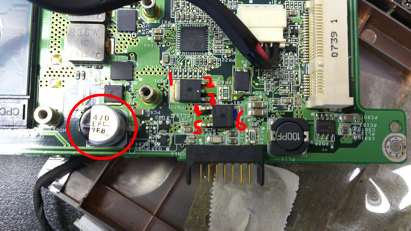

Adapter LED flashing, laptop not switching on

    Hi thanks for checking, I have taken a closer image of the chip, i cant find anything that means anything to me through a google search, maby you'll know more about it than me. Heres the pic anyway.
    Yep, you read it right, it is an ISL9504

      Cheers, I'll order 1 from ebay n see what happens after replacing it, just before I do I tried takin' the resistance readings again to see if I can get anything and now i'm getting something. I have numbered the pads and reuploaded the image so you know what pads im on about (I did remove the components, just reused the image for convenience)
      1 - 44.2 for a second then changes to 1.2-1.1 average (then stayes at 1.1)
      2 - anything from 76.4 to 114.8 for a second before just displaying -1
      3 - nothing
      4 - between 38 & 48 for about a second before displaying average 1.2-1.1 (then stayes at 1.1)
      5 - 0.09
      6 - 53 to 93.x before stabelizing on 0.06
      It wouldnt give me any readings when touching the chassis with 1 of the multimeter prongs, so I touched 1 of the heatsinks screw cylinders instead which I figured would work, you can see what i mean as you can see it on the picture inbetween the circled capacitor and the cpu plastic holder.
      is any of this info useful?

        Hi, finally got the power IC which I have swapped, but still doing the same, think ill call it a day with this machine now. Thanks for your help.
