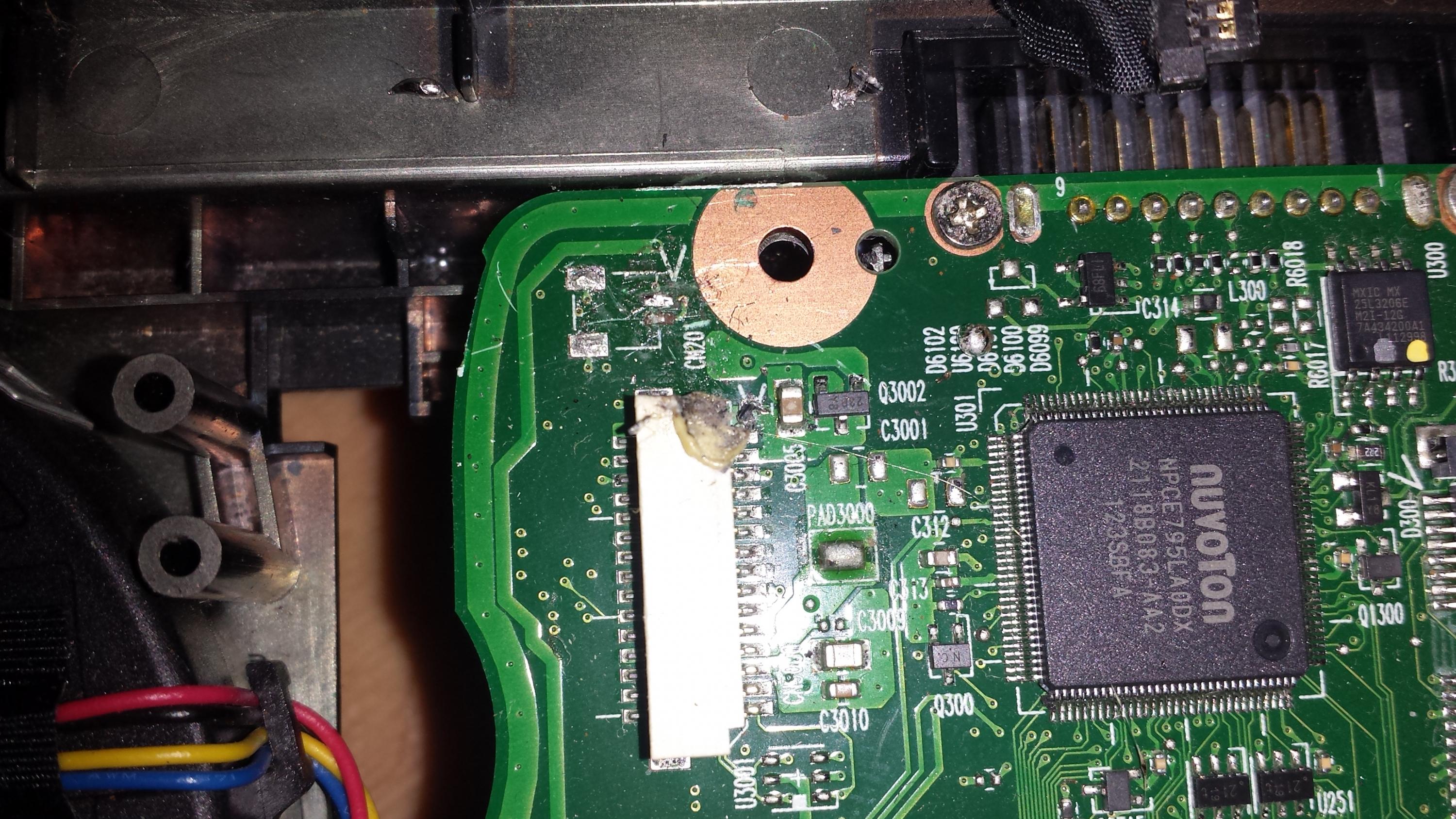

                                  #56
                                  Re: Toshiba Satellite C655 won't run off AC. Need schem.
                                  toshiba satellite c665
                                  Toshiba Satellite C665 broke off on off connector point ( CM20) to motherboard Any other points I can extend wire to solder to that will do the job ?
                                  • JakDac
                                    • Jul 2013
                                    • 5
                                    #57
                                    • JakDac
                                      • Jul 2013
                                      • 5
                                      #58
                                      now NO solder points on cm20 where else to connect on off switch
