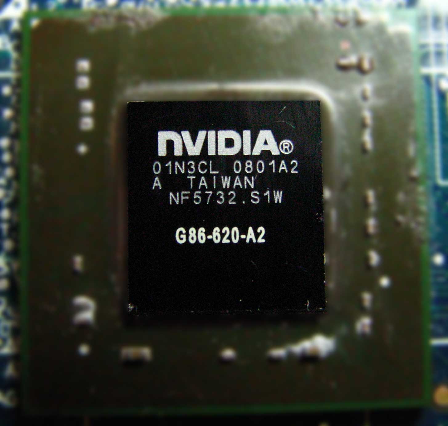

    Hi again. I got this laptop and after twice reball the G86-620-A2 chip, problem back again (no picture on screen)
    So I read, that all the chips of this series defected, on ebay I see new chips but I do not know which is not from this "bad" series.
    Is anyone to know better which exactly code must be on chip without this problem (overheating)
    Thankyou.

    Look under the 'I' in nvidia. The date code is the first two numbers - '08' in your picture. The ones that are not AS flawed (they still use lead free solder which will always be problematic) are the '10 and above series. I think there were some rare '09's that were also fixed but '08 and less are pure crap and have close to a 100% failure rate. I've been doing this 20 years and I've never seen anything like it. There isn't a day that goes by that an nvidia, ATI and now even Intel GMA laptop doesn't comes into my shop that the GPU has failed. I'm currently reflowing and reballing only when I have to but they all will eventually come back. Once this problem starts, there really isn't a permanant fix. I'm now seeing netbooks with Intel GMA's failing because of inadequate cooling. I don't know what they're doing in phones and tablets that they aren't doing in laptops. Good luck to you though. I feel your pain on the D630. These are a beast to fix. I've also had one recently that I've reflowed twice now - and I mean a proper reflow where the chip floats around at liquidous.

      Hi. So I must search for 10 or higher
      Thankyou for comprehensive explanation.

            Hi. I usually (in 98% cases) do reball, but in this case even this not help for long period, work month maybe two if.
            I use leaded balls, but this chip overheats even with proper cooling (arctic silver thermal compound and cooling pad with 2 fan) and updated bios on latest version I think is A18.

              Did you add epoxy glue after reball? That might help in this case. I also noticed that the heatsink is not parallell/flat against the Nvidia chip on all the d630 that I've worked on. I usuall have to bend it a little to make it more even/flat to the chip.

                Hi. I dont add any epoxy glue (like red HP epoxy) Is possible to give me some link where buy one of this glue ? Heatsink sit proper on chip and is flat with core on chip, but owner of this laptop tell me, that laptop is ON all day long for youtube videos and movies, and that and bad series chip in my opinion is cause overheating.

                  You'll drive yourself crazy with these, guys. I've spent so much time on these GPU problems over the years, it's not funny. In 2010, nvidia specifically increased their GPU ground plane (better internal heat dissipation) because I believe they went through a die shrinkage about this time. The newer chips coupled with leaded solder are really the only way you're going to "permanently" fix these issues. You'll find yourself in a constant cycle of reflowing / reballing these things every 6-12 months. I only do it with the customers knowledge that we're merely delaying them purchasing a new laptop. Still - this is only with the proper equipment and a ton of experience. Certainly not for the faint of heart. I reflowed GPU's for 18 months until I realized I was doing it all wrong the entire time.
