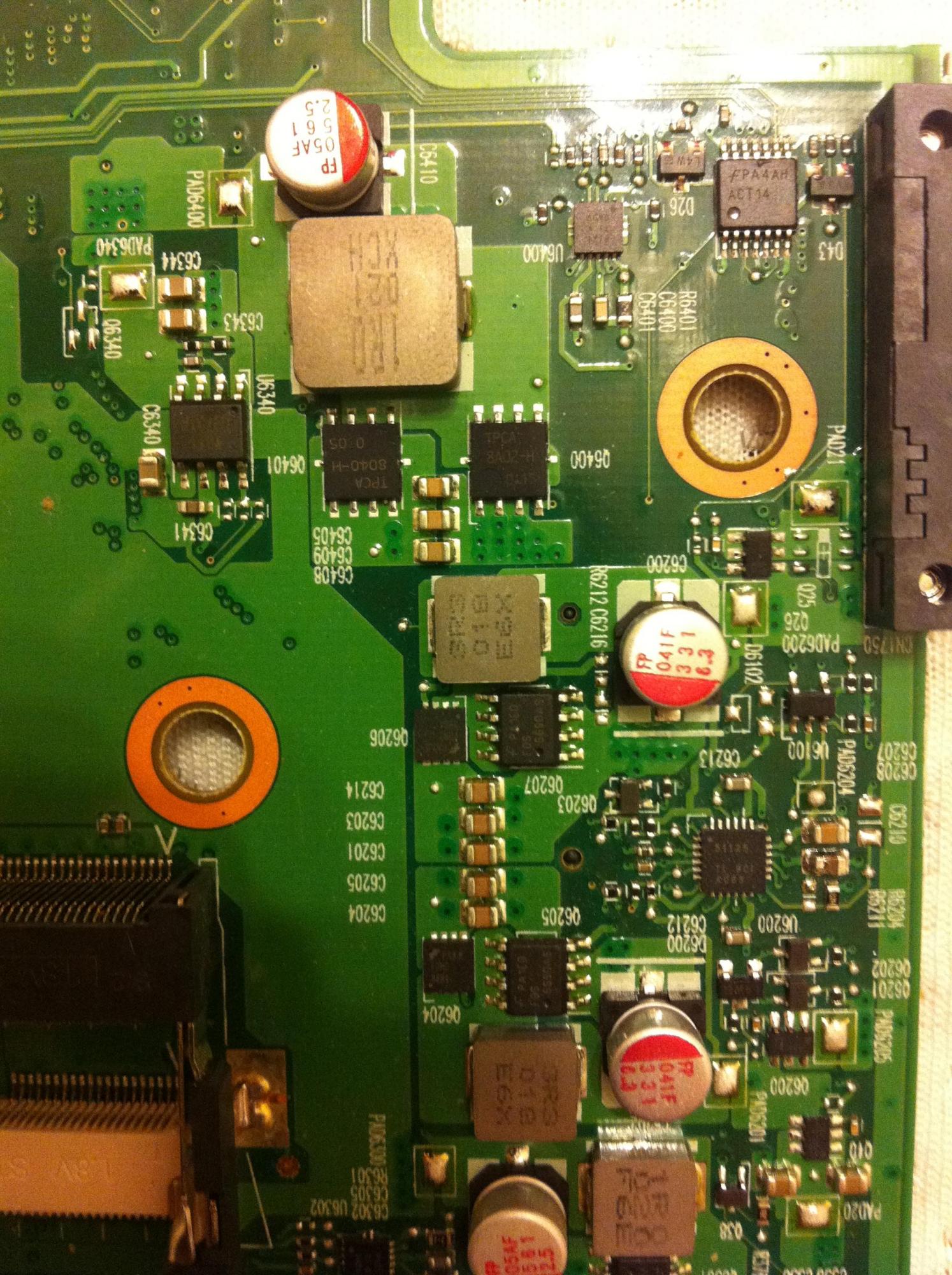

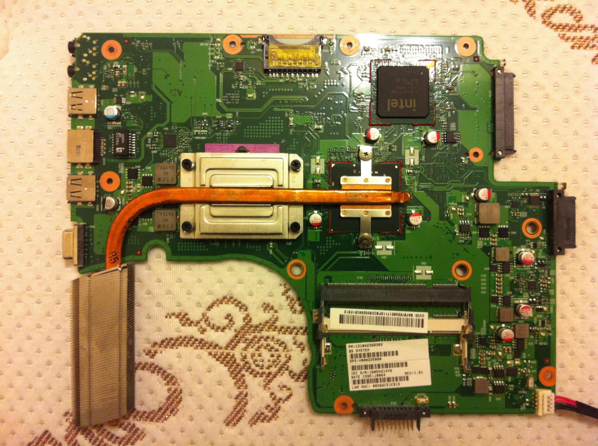

    Hi Guys, I'm new to this forum and have stumbled across it while in search to a possible solution to a problem I have with a Toshiba C650.
    One evening it was working... I shut it down and went to bed, next morning a new dvd drive arrived so I removed the screw, removed the drive and replaced it. I thought I have it fully pushed it but hadn't and while attempting to do the screw up the screw has fallen and my screwdriver has gone through the hole and hit the motherboard.
    There is some damage to a ceramic capacitor (seen of pic 3) c6210
    Since then - nothing. no lights on the laptop at all, either with ac in or out.(same with battery)
    I have opened the laptop up and over the past few days been running a multimeter across the board trying to see where about the power stops.
    I can follow the 19v's to a point but then nothing. Thing is I'm not sure exactly what should be giving me 19v and what shouldn't. I do know that both fuses are OK and the battery terminals are not giving out any voltage.
    I'm new to fiddling with motherboards and have accepted that this laptop is OK to be bin'd but I feel it's such a waste of a laptop if the faulty component can be identified and replaced. May6be not by me but If I can identify the problem then it was save somebody who can do the solder work the troubleshooting.
    Anyway, thanks in advance for any help & advice
    Paolo

    Obviously the damaged capacitor is the problem. It's actually C6208 (C6210 is not populated). The part number designations suggest OEM is Inventec. I haven't been able to find the schematic for your model, but from the L500's schematic (also built by Inventec) they use a TI TPS51125 there, which looks like the same chip you have as U6200. If that's the case you can use the reference design on TI's website to figure out what value of cap should go there.

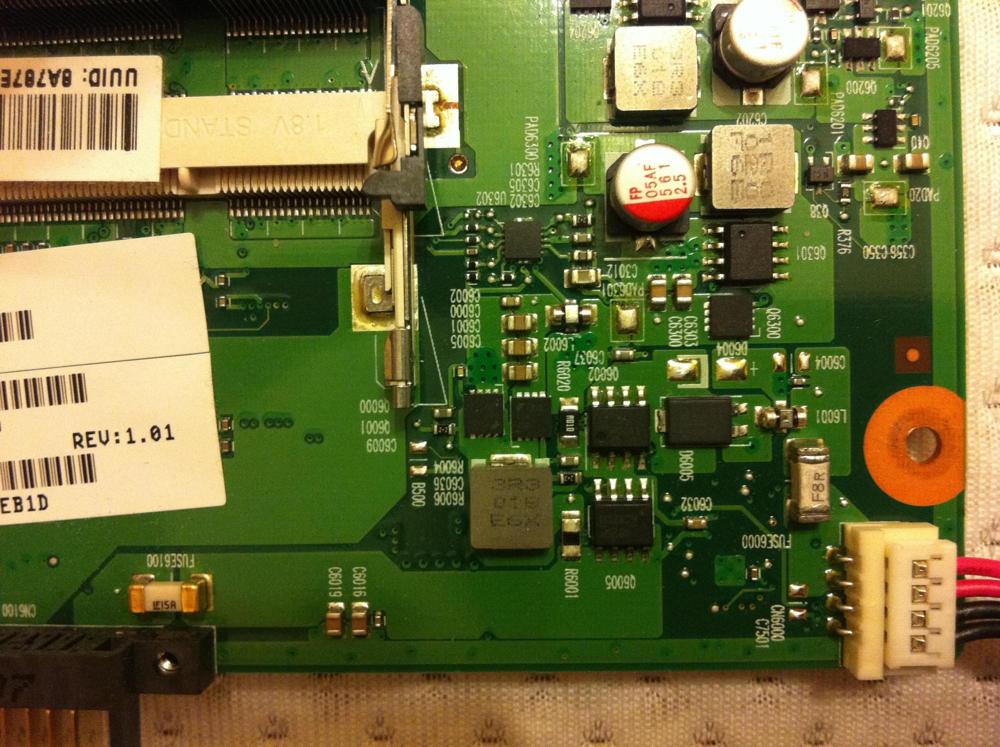

      With regards to the battery pins showing no reading do you think there could be damage elseshere also?
      I can follow the tracks up to q6002 (pic 2) and only have 19v on one side of this. The other side has nothing, as does the next chip in the chain. Does this mean something?

        Replace the broken cap first, then continue to troubleshoot...
        And do get the L500's schematic as a reference (although not exact), since it uses much the same circuitry.

              If that's a TPS51125 then that is the VIN pin and the damaged capacitor is for decoupling - the IC might not work without it, or work erratically enough to not produce the correct voltage.
              You may want to consult the reference design for the TPS51125 (https://cdn.badcaps-static.com/pdfs/...c3b552ae45.pdf ) and ensure that the 3.3v and 5v outputs are at the correct voltage, as well as the input voltage (5-28V according to the datasheet, probably 19V in your case.)

                        change U600 max17435 and your good to go.
                        before post the voltage from that IC
