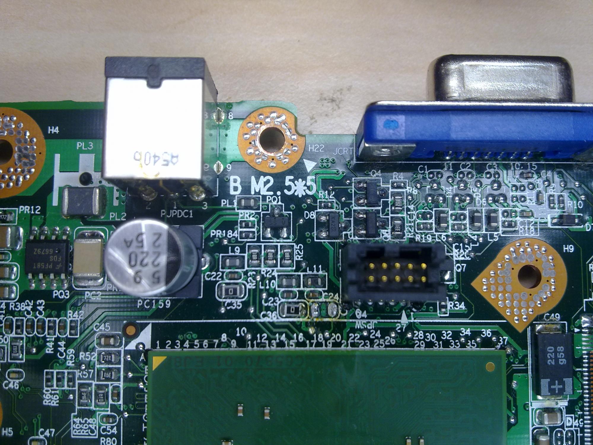

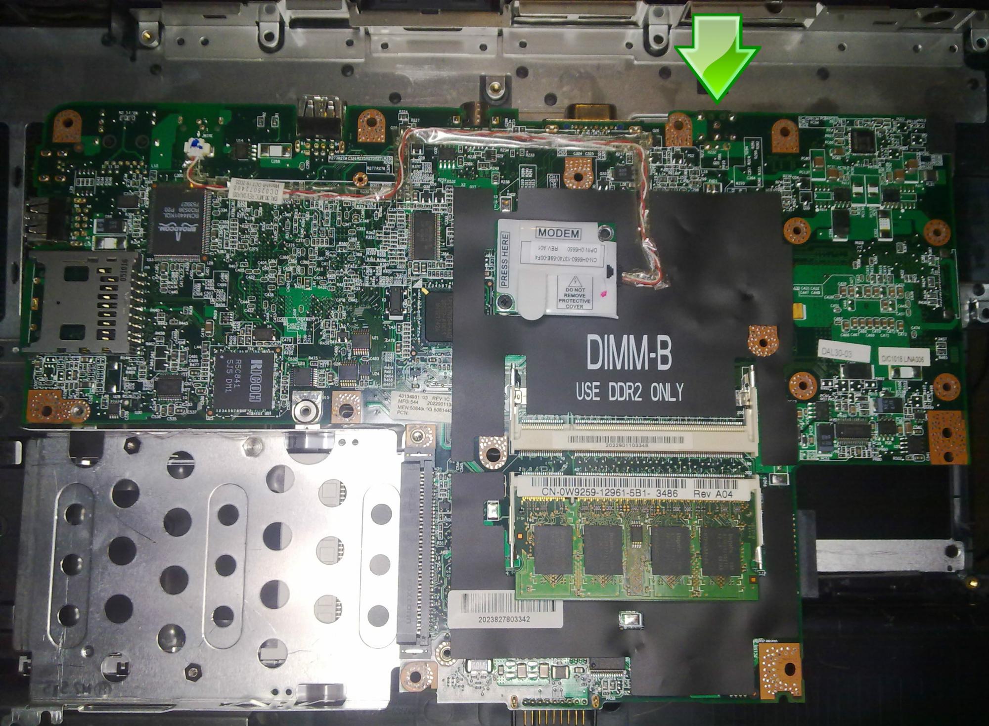

    Hello, hoping someone can give me a few pointers to help troubleshoot this.
    I was having issues with the original DC adapter and tried a universal one instead - unfortunately I got the polarity wrong. As a result the laptop works fine from a charged battery, but when using a genuine adapter (borrowed from friend with identical laptop) the adapter is not detected at all - no lights, no unknown adapter, no power, nothing.
    So I removed the motherboard and had a poke around with a multi-meter. The socket seemed ok, but I resoldered it anyway. I found one capacitor near the socket which seemed to be shorted (probably C37, next to C36). I removed it and confirmed it was shorted. I had read of a fix for a Dell Latitude D505 which suggested just removing a shorted cap, so I thought I'd try it - nothing.
    After a bit more poking I've realised that despite the labelling it's not a capacitor at all, but a 0 ohm "resistor". All others on the board marked with the 0 check out the same, plus it's black and the other caps are brown
    So I'm back to square one. Any thoughts?
    [Images attached of board front, back, front near socket and back near socket]

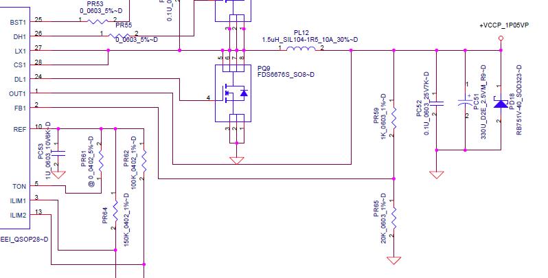

      Thought I'd found something. A diode, and 2 caps in parallel showing a short (PC52, PC51, PD18). For reasons I don't understand the schematic shows there is a link shorting these in the circuit.
      Found a mosfet apparently shorted (PQ29), circuit shows a diode (PD29) in parallel and on the PCB... no diode both pads deliberately shorted. On closer inspection pin 4 isn't shorted to the others.
      So, can't find any shorts in the "P" sections - caps seem okay and all mosfets and inductors.
      I'll have to try it with the power supply connected. Not sure what to expect. Hopefully the schematic will be my guide.

        You have to remove components from the circuit to test them properly.
        I don't see what link you're talking about shorting them (page 43).
        PQ29 is intended to control whether the DC_IN (from AC adapter) can be used to power the system, so that it's possible to run the laptop from battery even with the adapter plugged in. Maybe the designers thought that feature wasn't needed so they omitted it (pin 4 is the gate, that's why it isn't connected). This means the battery voltage should appear across the DC input while running on battery - you may want to check that.

            You're right that PC52, PC51, and PD18 connect to ground, but not pin 1 of the max1845. That only connects to the first intersection after the inductor PL12.
            Where are you measuring across that is shorted?

              Re: Dell Inspiron 6000 works via battery but not charger
              I thought pin 1 (OUT1) went to ground at the bottom of PQ9 before the intersection after PL12?
                Should look like this.
                That is a 1.05V rail that connects to the CPU and chipset, so it may look shorted. In fact, it is fine since you said the laptop works on battery. The max1845 regulates the PWR_SRC (either battery or AC input) down to 1.05V. The important thing is for there to be no short at the AC adapter input.

                  Almost 12 months to the day, and I'm back looking at this laptop. I now have a couple of other Inspiron 6000 boards to compare with (can't just substitute because the LCD isn't compatible).
                  I decided to measure some voltages around the power jack. Here's the an image from the schematic.
                  On the working board, the power supply supplies 19v to pins 2 & 3 of the connector. DCIN+ measures 19v. After PL2 I also get 19v - top of PC2, PR11 and pins 1, 2, and 3 of PQ3. PQ3 puts out 19v on pins 5, 6, 7 and 8. Pin 4 shows 7.7v. (PL3 is not populated on the board)
                  This is how it looks on the working PCB with the colours showing the different voltage lines:
                  On the faulty board the 19v drops to 7v right at pins 2 & 3 of the connector. So, I removed PQ3, PC2 and PL2 in turn, and only when I removed PL2 did the supply return to 19v (at this point the supply is effectively disconnected from the rest of the circuit). The two resistors PR11 and PR13 measure the correct values in circuit - they're tiny so can't easily be removed.
                  There was a little black mark under PL2 which might be a burn mark, but substituting with one from another board made no difference.
                  So, I thought I was in the right area with this but I'm stumped again. Any thoughts?
