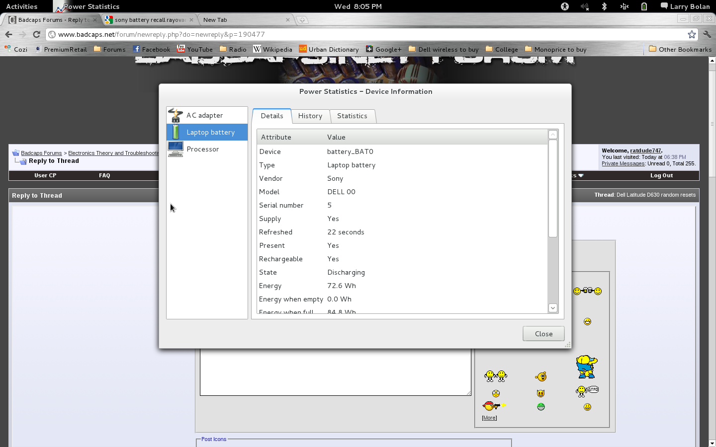

    Ok, this is annoying.
    my laptop keeps resetting whenever I am trying to read or write a file in a folder of libreoffice spreadsheets
    I am running fedora 16 beta.
    It happened all of the sudden, it has happened 3 times in my college class within 10 min.
    I recently Upgraded my battery to a rayovac made 9 cell unit from battieries plus. According to HW monitor (in vista), it uses sony cells. the battery was around 30% and discharging when it happens
    What happens the laptop will all of the sudden power off hard (complete power loss). after removing and reinstalling the battery, the laptop powers up.
    I doubt it is relavent, but my laptop uses an nvidia graphics chip.
    This is very bizzare... Any Ideas/suggestions?

        it did it again when I tried to copy something with 10% charge....
        connected to battery power, the problems are gone.
        me thinks it is a miscalibrated battery gauge.

          I am really thinking it was a calibration issue... I just remembered noting that the battery data last noight read that the battery had more capacity when full than it was designed for... that could indicate a calibration issue, right?
          also, if it is a calibration issue, running more full charge/discharge cycles will recalibrate the battery?
          also, I made a typo in post 1. it actually was around 10% when it went goofy...

              it was an honest error... the cells are new and safe. In fact, minus the recalled ones, sony cells are some of the best ones available. trust me, if this one were recalled, it would not be on the shelf (IIRC the batteries plus/rayovac partnership happened after the recall).
              want to know how to tell? for windows, It is in the battery properties. for linux (fedora 16), well:

                  on battery power @13% it did it again.

                    she did it again at 34%
                    I think it is a bad battery. anybody other than shovenose have advice? (SN- sorry, but I want a 2nd opinion)

                              actually, kc8adu did in anoyher thread... he says the same thing i was thinking- exchange it, and if #2 is bad, return it for a refund.

                                exchanged it, i will test the new one when i get home.

                                    they asked what went wrong, that was it. they gave me the other battery they had in stock. No problems (they will probably test the one I gave back and go from there).
