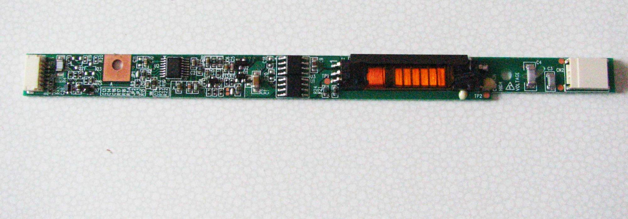

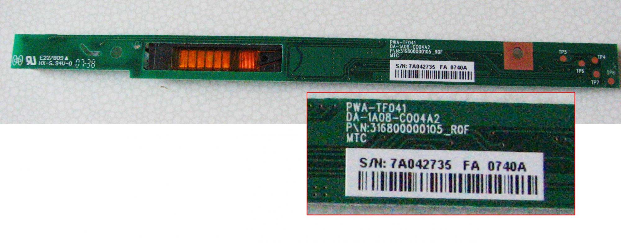

    Hi. I got this laptop, and turn on OK: work fine on external monitor, but on primary lcd just show logo and no light after 1-2 sec picture disappears.
    see video on this LINK
    I do reball the MCP67MV-A2 chip, and no changes. Maybe inverter is broken too, so I ask here, how can I test this inverter ?

    Re: Acer aspire 7520 no video -fixed-
    I fix this issue. LCD screen bulb is bad, I change panel and now work OK. In occasion I will ordered a new lamp with eBay and save old panel.

      for future reference, A tip for troubleshooting:
      use a flashlight and shine it on the screen if and when it goes blank... if you have a backlight or inverter issue, you will be able to see what is supposed to be displayed. if you get nothing, it isn't the backlights or the inverter.
