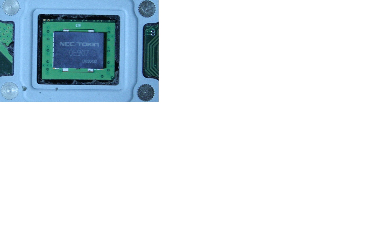

                Re: Toshiba Satellite L300 Wont work with charger
                Originally posted by incradibles
                I got the solution under cpu there is a square caps Market nec... remove it and put small tiny rectangular caps
                Hi I'm new to this forum and I have the same problem with my L300. I took a picture with the part labeled NEC TOKIN capacitor and I would like to confirm with you if this is the one? If so, can you show us how you soldered those smd caps on the board. This is to give me some guide once I desolder this part. If there is no need to remove this part then how did you solder those smd caps correctly? Hope you can enlighten me on how you did it. Thanks in advance from Manila, The Philippines.
                  you can find the instructions here:
                  https://www.badcaps.net/forum/showth...highlight=l300
                  I also successfully fixed my L300.
                    Thanks for the info. Really appreciate it. Now I can try it this weekend and hope it works.
