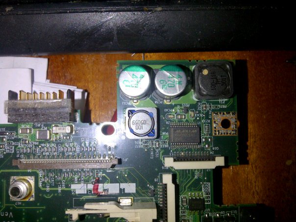

    Toshiba M35X clicking noise from mb
    The motherboard has a clicking noise coming from one of two transformers which are situated next to a maxim1902eai chip a Power-Supply
    Controller.
    Any ideas would be most welcome - thanks.

    Re: Toshiba M35X clicking noise from mb
    Photo of where the noise is coming from
      Get 2 or 3 foot piece of windshield washer tube. The soft rubber kind.
      Place one end in ear.
      Place other end on components until you find the noisy one.
        Thats a good idea - I have another laptop with the same clicking but have never been able to isolate the sucker.
        Forgot to mention the laptop in question does not power on at all, is it likely the clicking transformer to be the cause or is it the effect of something else thats gone bad?
        Whats the best way of removing these sm transfomers
          The clicking noise is a typical symptom of a power supply in protection mode. One of the mosfets forming the synchronous buck rectifier is likely shorted.
          Those are inductors not transformers. The best way to remove them is with a hot air gun. At the way they're packed, it's not likely that you'll have success via any other method anyway.
            Yeah thanks TH3 I felt it in my water it was something else causeing the faint clicks.
            On the reverse side of the board are 4x 8 pin dil chips two are branded
            4810
            BO and a delta sign
            W48A
            the other two
            4800B
            CD and a delta sign
            W49B
            Seven legs of each of the 4 devices are grounded.
            Will they be the mosfets if so does anyone have the data sheets for them I can't find them on google
              That's impossible. Sure sounds like a short to me. Remove CPU to be sure (CPU can cause false readings on vregs), but i believe they're toast. They're most likely Alpha & Omega devices (AO4810, AO4800), check this link and this link.
                    I agree its impossible, after taking another look. Its not the cpu removed that and it still clicks.
