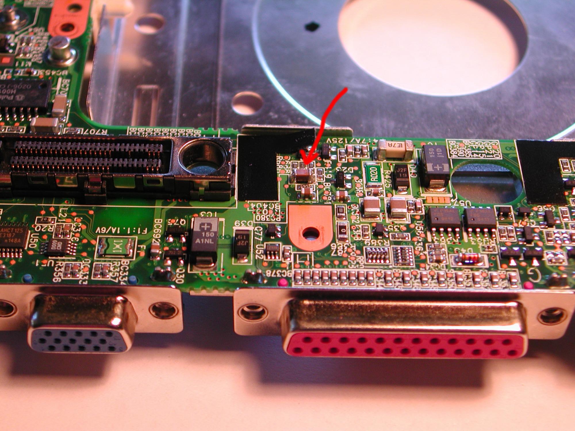

          See attached - check this Cap
          • Wizard
            • Mar 2008
            • 2296
            Re: Dead Thinkpad R30 and R31 series.
            I did google searches and I did find that one as well. This does not match the symptoms. That little cap prevents turn on. The two boards does turn on.
            Even I did mention that I used scope to look at signals, it is not running on memory bus that proves something major failed in northbridge or southbridge. I also did looked at bios chip for signal. Not there either.
            I also looked at the IBM service manual and carefully checked and these boards supports the configuration I desired.
            Cheers, Wizard
