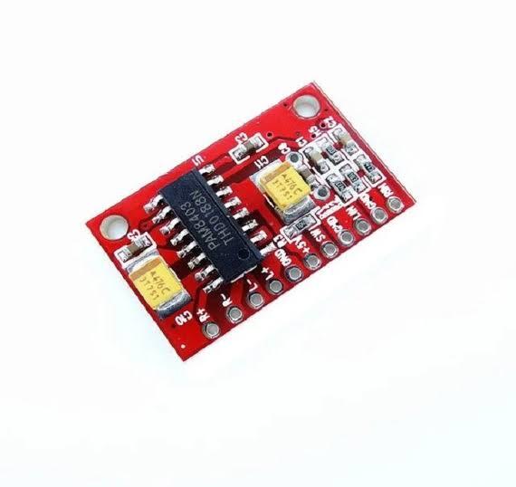

        PAM8403 Mini 5V Digital Amplifier Board 2 Channels 3W Class D Audio Speaker Sound Amplifier Board
        with any USB to audio card

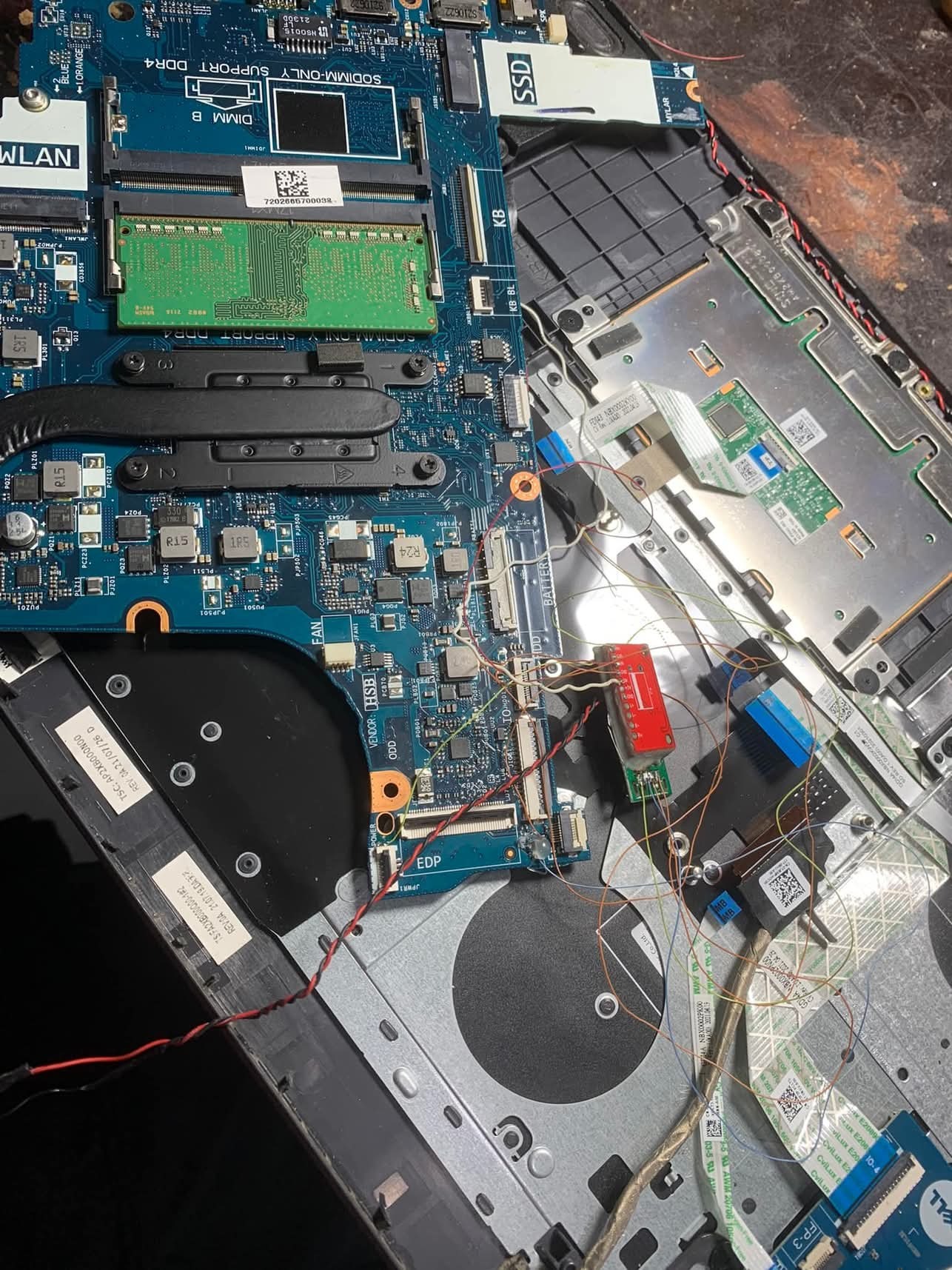

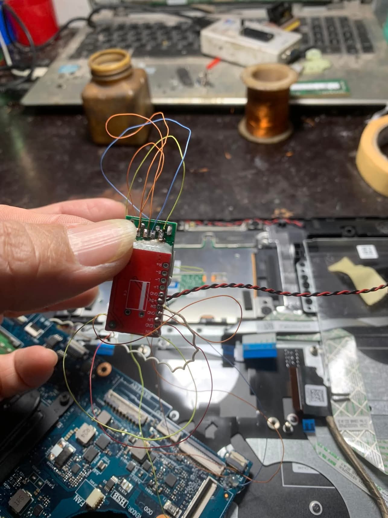

            Hi, I am planning to install this on la-k034p motherboard which has audio issues. Can you tell me if I should only use pam8403 or any other module as well. Lot of chinese and indonesian technician have solved using these boards. Attaching images for reference
