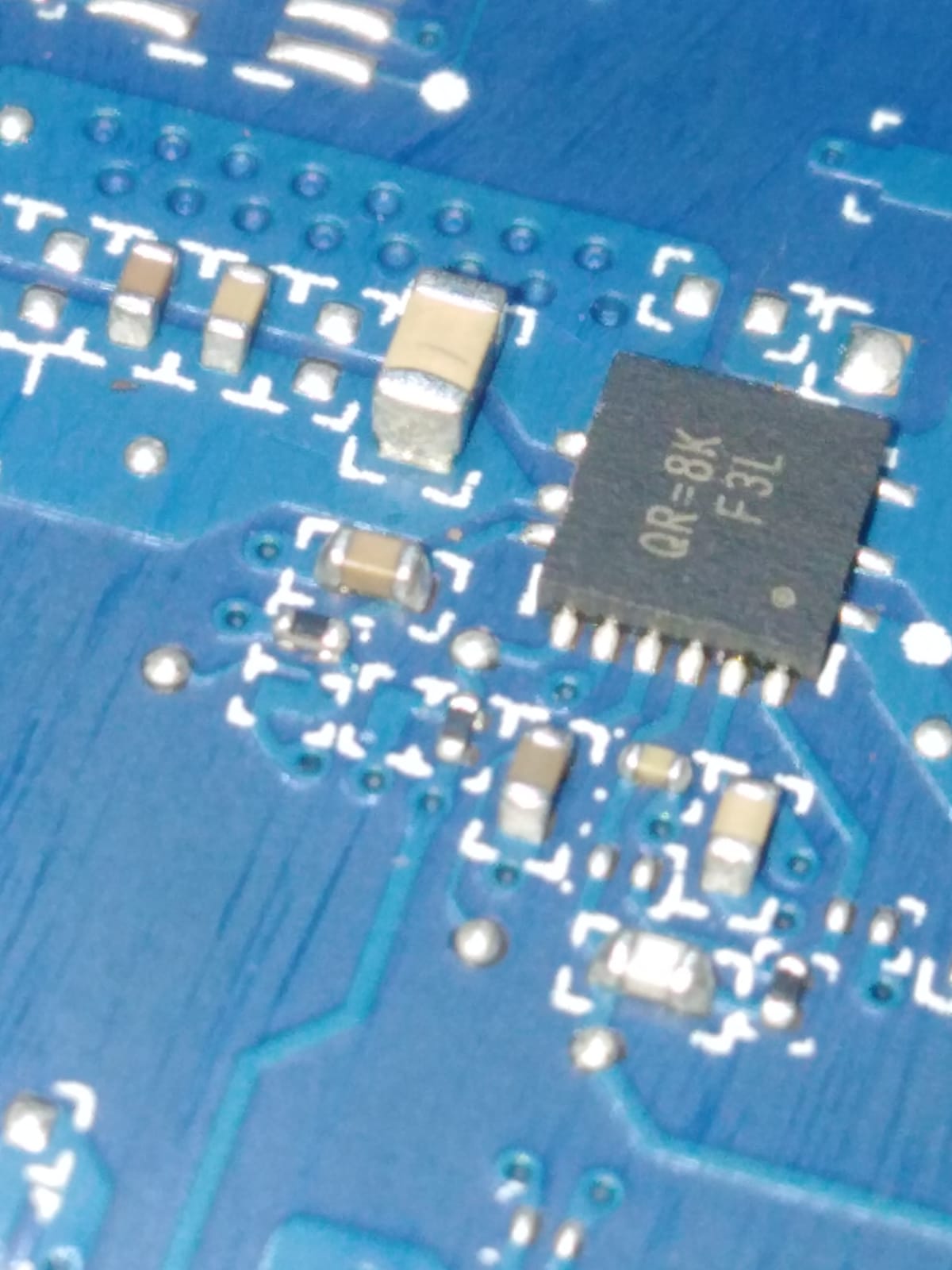

Need to identyfy IC code QR=8K
  • kusal
    • Jul 2021
    • 27
    • Sri Lanka
    hello can any one know what is the ic code QR=8K
    need to purches but cannoth find it

    Re: Need to identyfy IC
    Since there is a '=' in the markings, this means it is from Richtek.
    The hunt should be for 'QR=' since the 8K = datecode for the mfr of this batch build and is not relevant for the replacement.
    https://cdn.badcaps-static.com/pdfs/...47915841fd.pdf
    Richtek part # RT6316BGQUF
    https://www.digikey.com/en/products/...BGQUF/16377015
      thank you very mutch bro your kind answer and knowlage sharing
