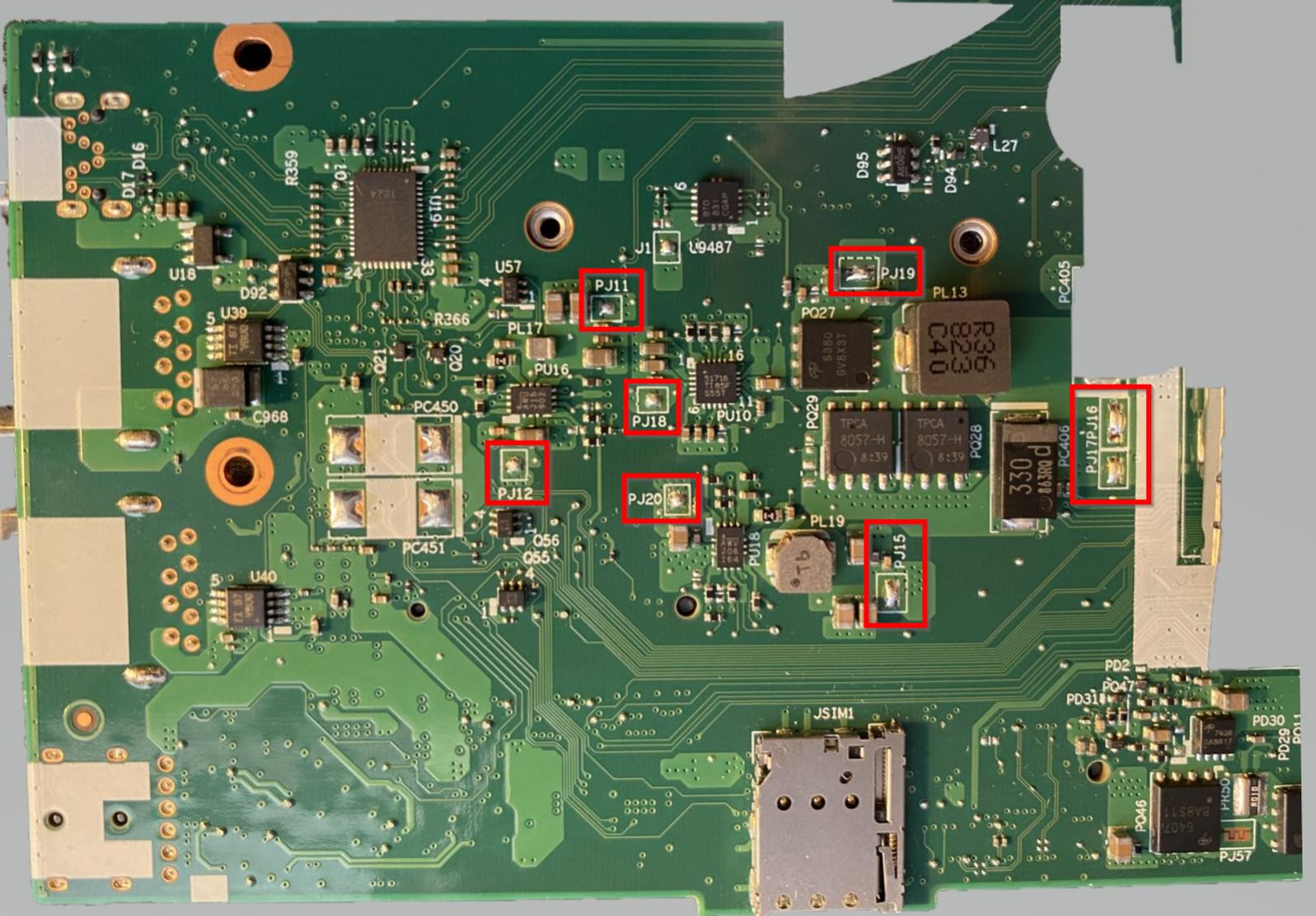

    Hi @all,
    I´m stuck in the repair process for a Lenovo P52, Model: 20M9001MGE.
    What was the problem:
    The problem was a boot loop, it started all over again and again.
    Unfortunately the internal display is missing, so I plugged a external monitor, but there was no output.
    I´ve then dissasembled everything and flashed the bios chip with a clean bios. https://www.badcaps.net/forum/showth...&highlight=P52.
    What´s the problem now
    The charging light lights up, when I connect the power cable and have the battery pluged in.
    The power button-LED lights 3 times, when I connect the power cable.
    But when I press the power button, nothing happens.
    When I´ve only insert the battery, there is just a very weak light on the power button-LED for a second, when I press it. There is no fan spinning or other signs of life.
    What I´ve tried already
    Reseated the RAM and try with a known good one. Power drain everything multiple times.
    Flashed a few other BIOS-Versions I´ve found.
    I think it´s not a BIOS problem anymore, there must be something wrong with the hardware.
    I need help to get a starting point where I should look. I´ve already watched a ton of videos, and checked a few things with the multimeter, but no problem described in the videos applies to this board.
    Update 1: Checked the voltage after the DC-Input, 20 Volts are present at the Power fuse 1 and at the current resistor, marked "R005".
    Update 2: Checked the 3,3 rail, and think it´s okay, but I´m not sure, can anybody please check with the schematics (see attachement)?
    Readings:
    PJ11 = 0V
    PJ12 = 5,19V
    PJ15 = 1,85V
    PJ16 = 0V
    PJ17 = 0V
    PJ18 = 0V
    PJ19 = 20,6V
    PJ20 = 5,2V
    Could someone give me a little help and point me in the right direction?
    thanks in advance

    Re: Lenovo P52 not powering up
    Check the voltage of PU201 pin 3 / 13 / 12 / 6/ 20 /7 Be careful not to short the pins & the voltage on PL5/ PL4 coils?
      Pl4 = 5,2v
      pl5 = 3,39v
      pu201/3 = 3,32v
      pu201/13 = 5,2v
      pu201/12 = 20,6v
      pu201/6 = 3,32v
      pu201/20 = 3,32v
      pu201/7 = 3,31v
        Work with correct bios-flash, see: https://www.badcaps.net/forum/showth...&highlight=P52.
