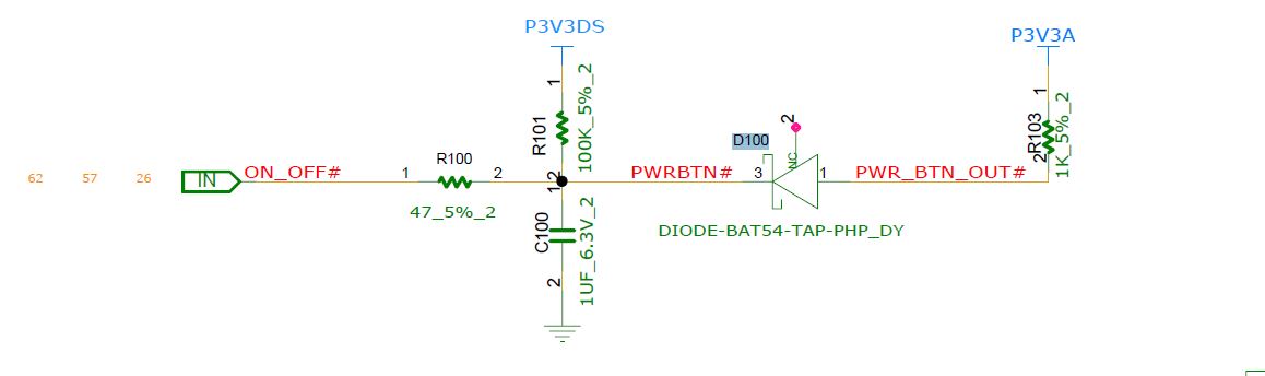

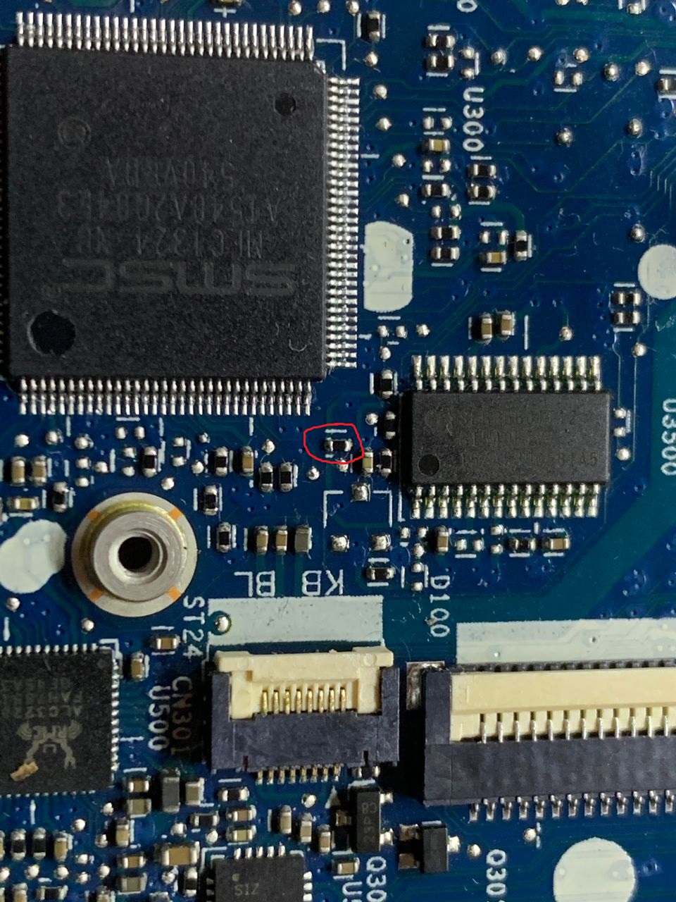

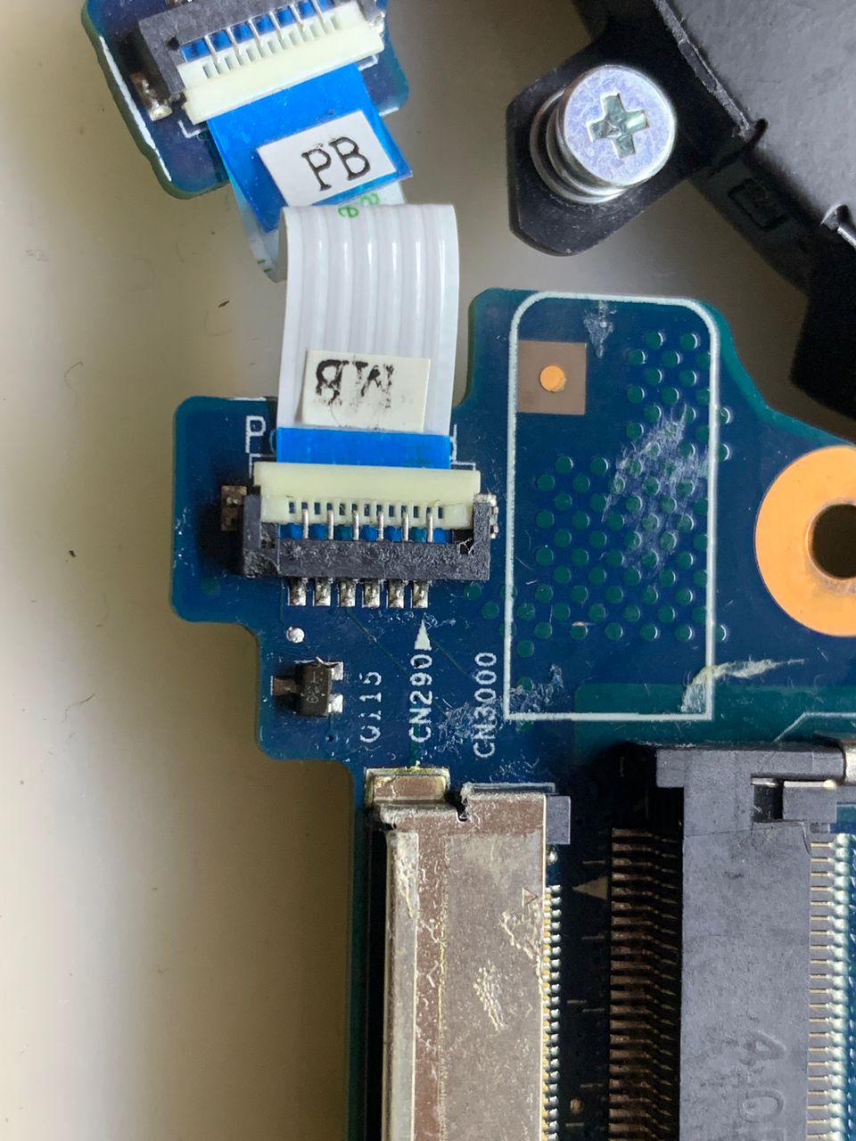

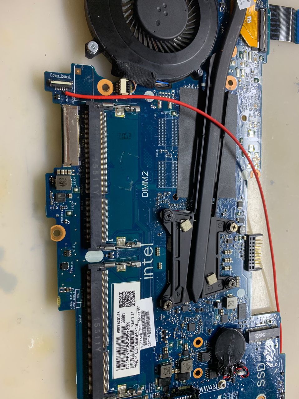

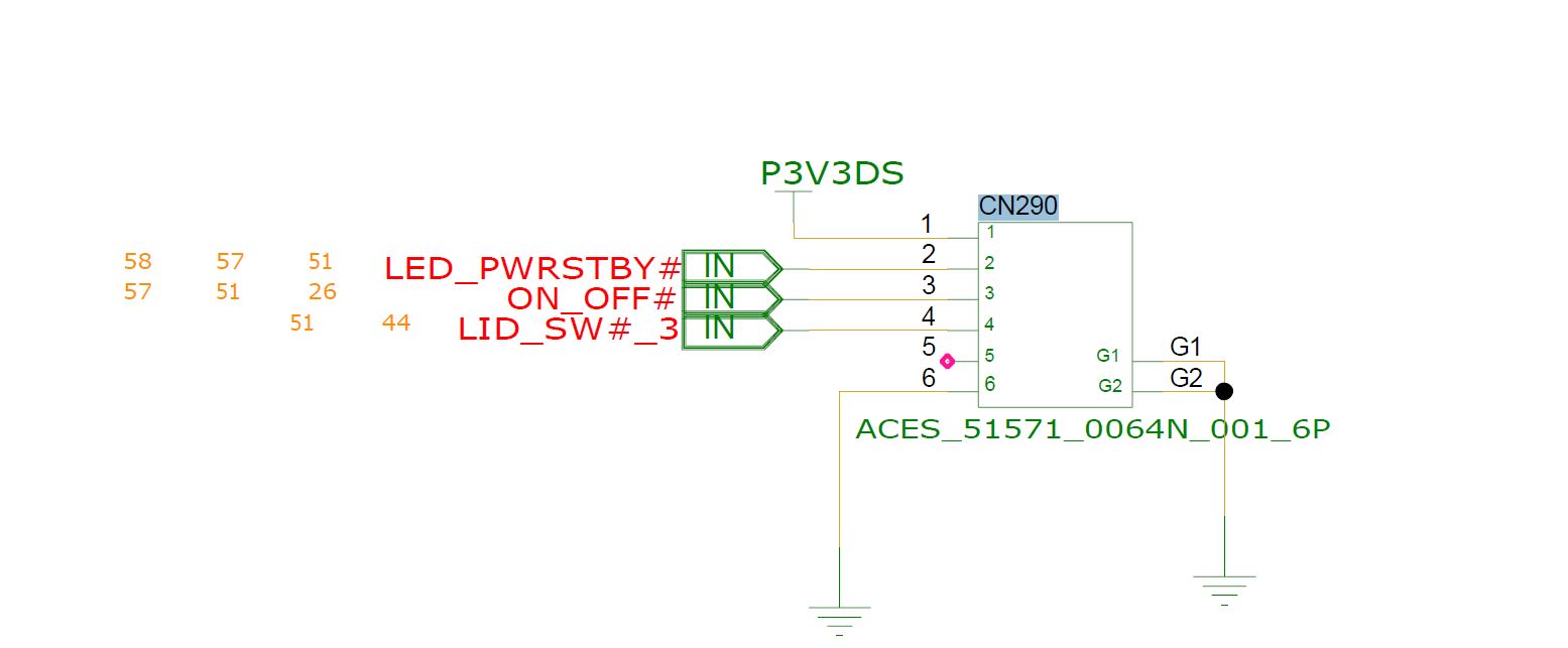

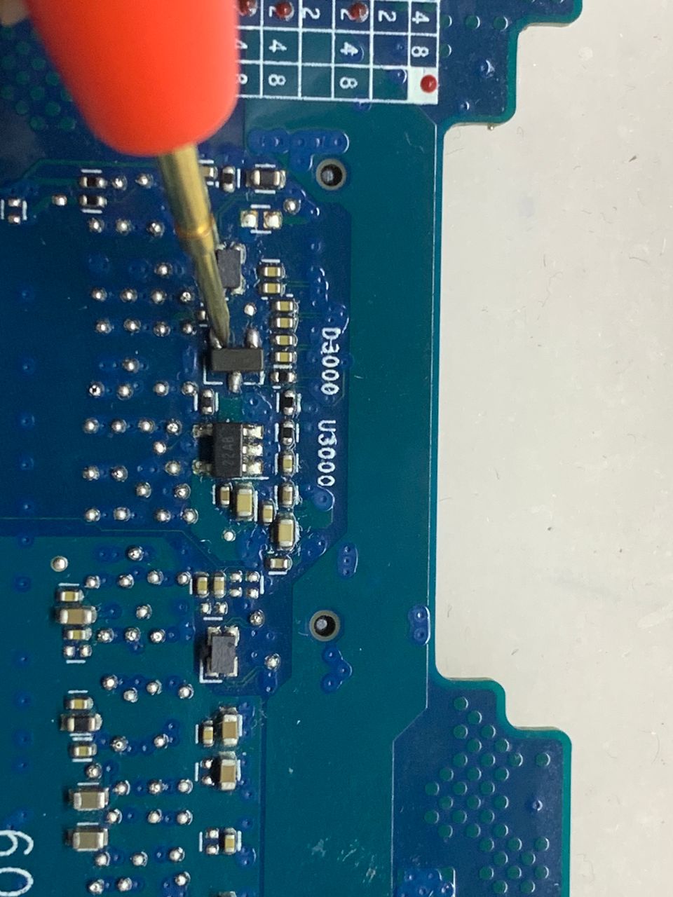

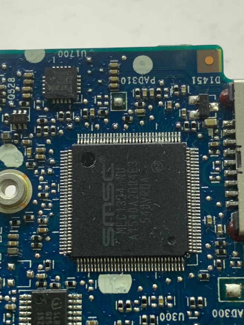

power button only read 1.8v instead of 3.3v....when i plugged in charger, this laptop will turn on it self for few second (current read normal over than 600+), then will stay remain only 20++...

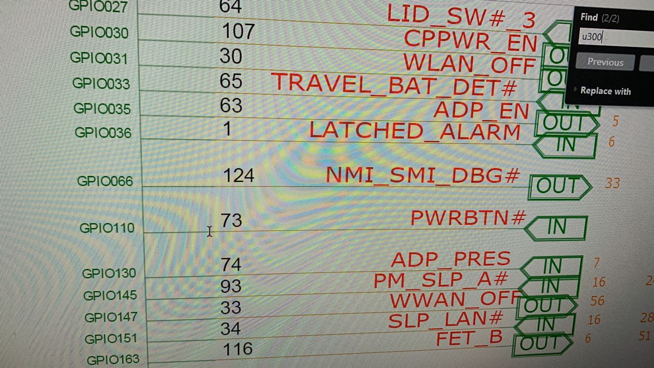

i've check on ec pin 73 (power button) also read 1.8v....is that could be faulty EC chip?
i have another motherboard same like this one and check on EC, pin 73 got 3.3v
