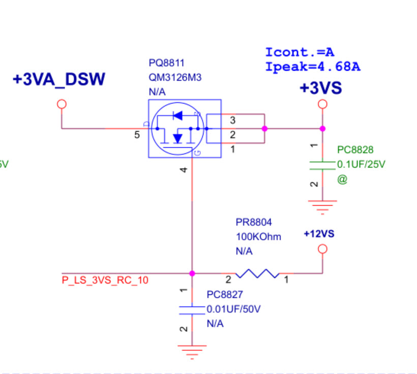

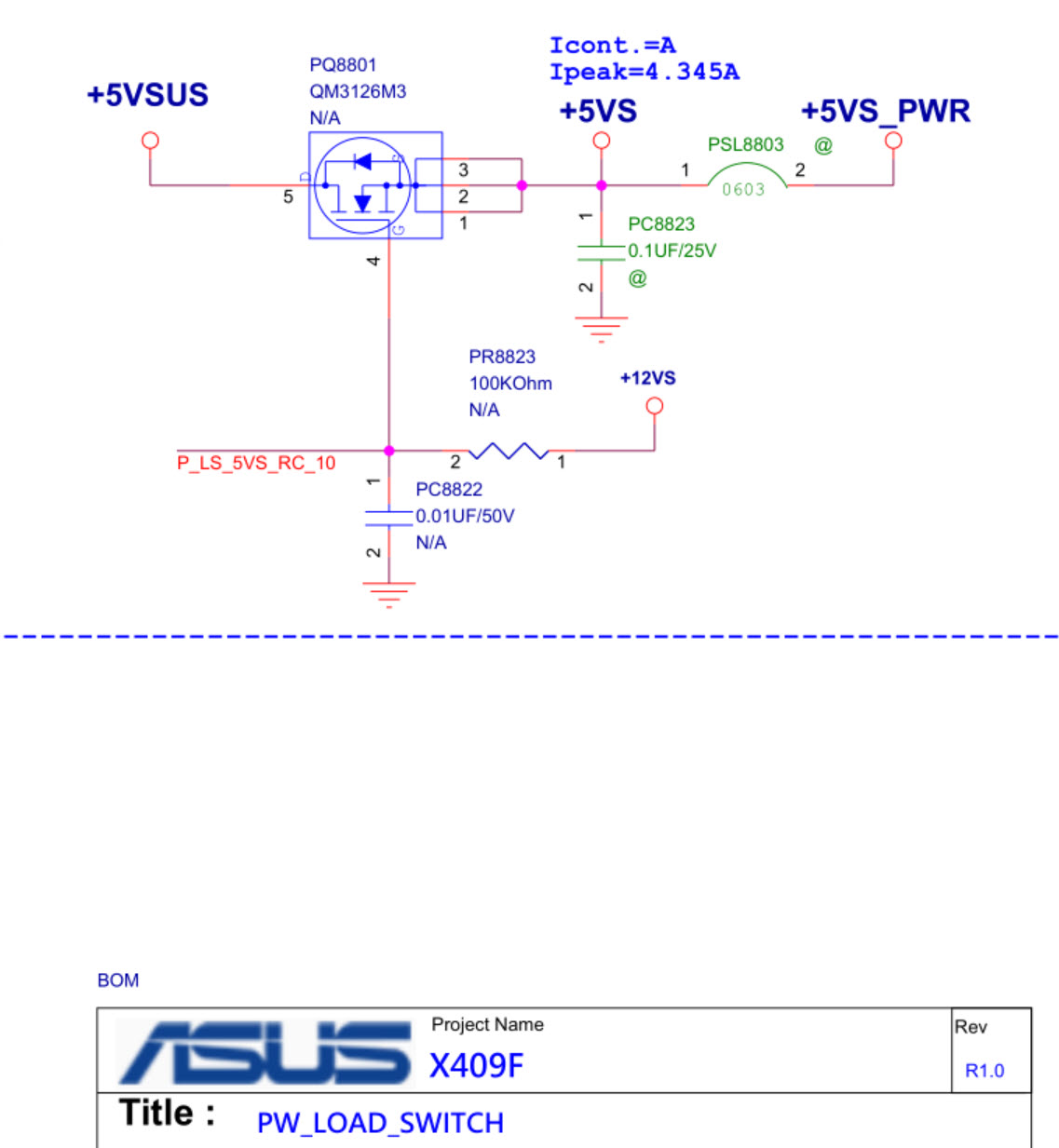

    have asus x409dl motherboard with no 3 vs and 5vs coming on pq8801 and pq8806.gate voltage is not coming on both transistor ans 12vs is not coming on pd8801 and pr8801,

        Remove all power. For each power rail that is missing, check their resistance to ground. Post each measurement.

          Thanks for reply 3vs to ground is 724 ohm and 5vs is 840 ohms .THE LAPTOP power on and 3v and 5v always voltage is present but it doesnt get converted to +3vs and +5vs.

            Check pin 5 PD8701, 12vs generated from here. Remove PC8724

              Attaching partial schematics of perhaps a similar logic board.
