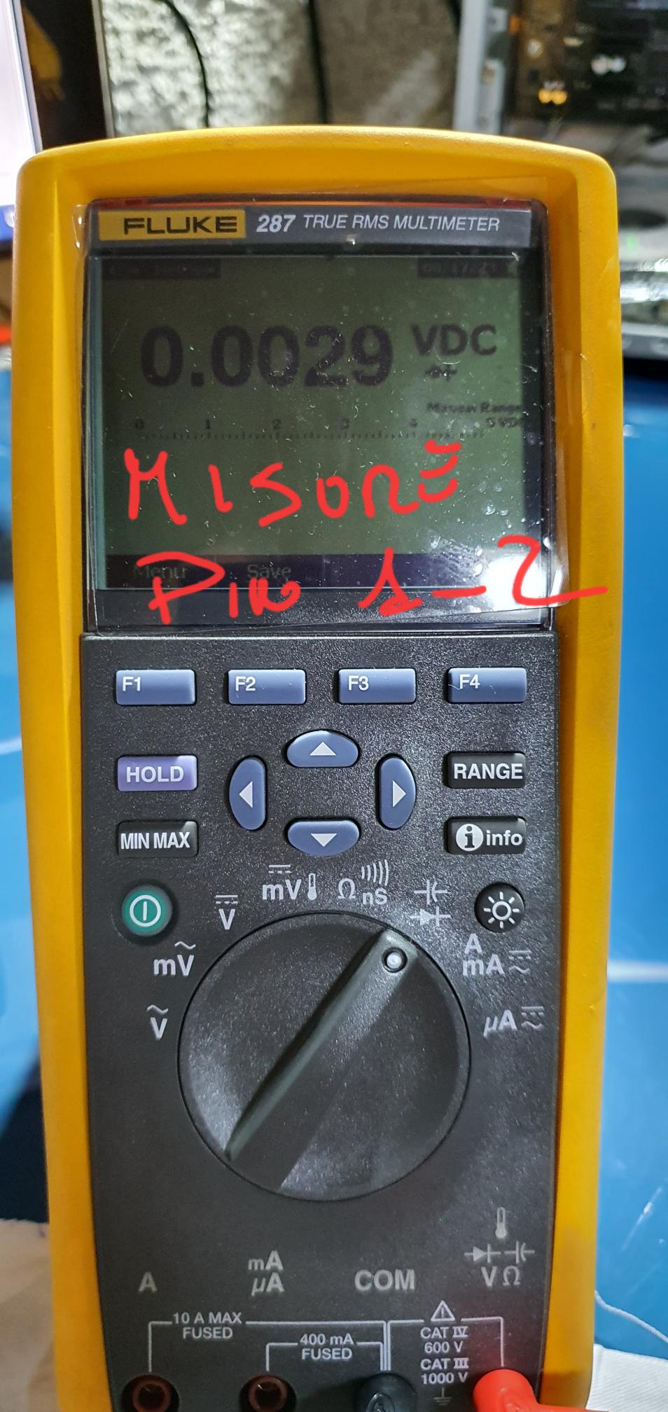

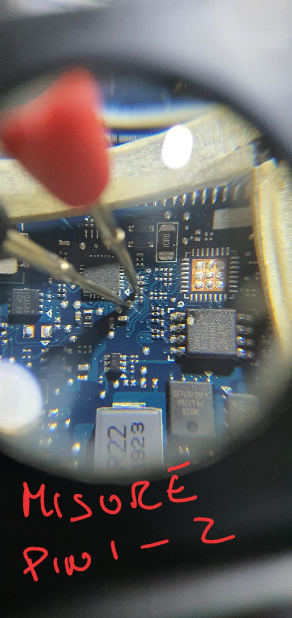

          Re: Acer A315-22 no power on
          1.....pin1-2 = 0.0029
          2....I can't confirm they are wrong .seee point 1
          3.....CMSRC ACDRV = 359 Kohm
          4.....0,5556 ohm
          the pcb tracks are all intact from the pu101 up to the pq103-105
          measurements performed with pr107 and pq107 unsoldered from the pcb
            PR119 is it on MB or have you taken it off ? If not in MB put the black prode to GND point and Red probe to pin 1 side then take resistance in Diode mode same way for pin 2 because the second picture do you have posted seems to be the probes are in pin 1-2

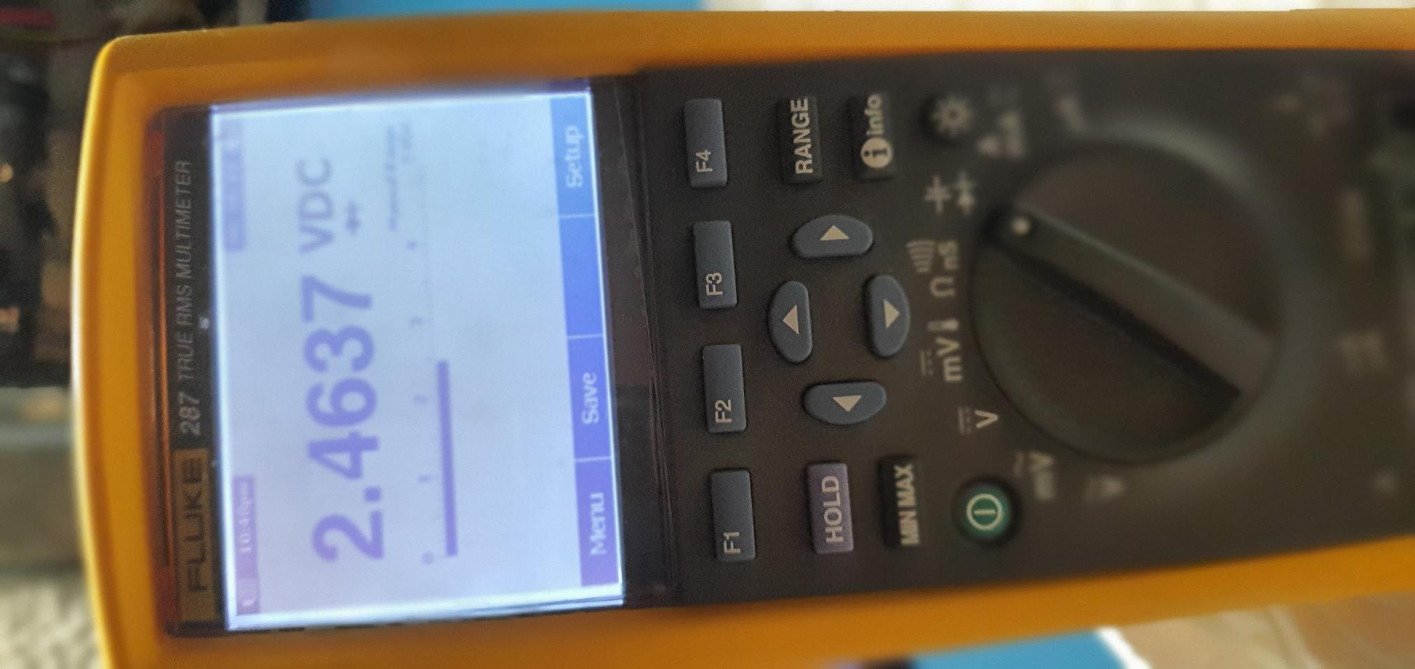

                Hi....I removed Pr119 from mainb, in diode mode I measured at pin 1=2.4637
                pin2= no measurement detected,...
                with the photo sent I re-measured pq103 and pq105 and they respect the indications you have shown me
                only measure detectable black tip on "D" and the red one on "S" 0.55 ohm
                Thank you
