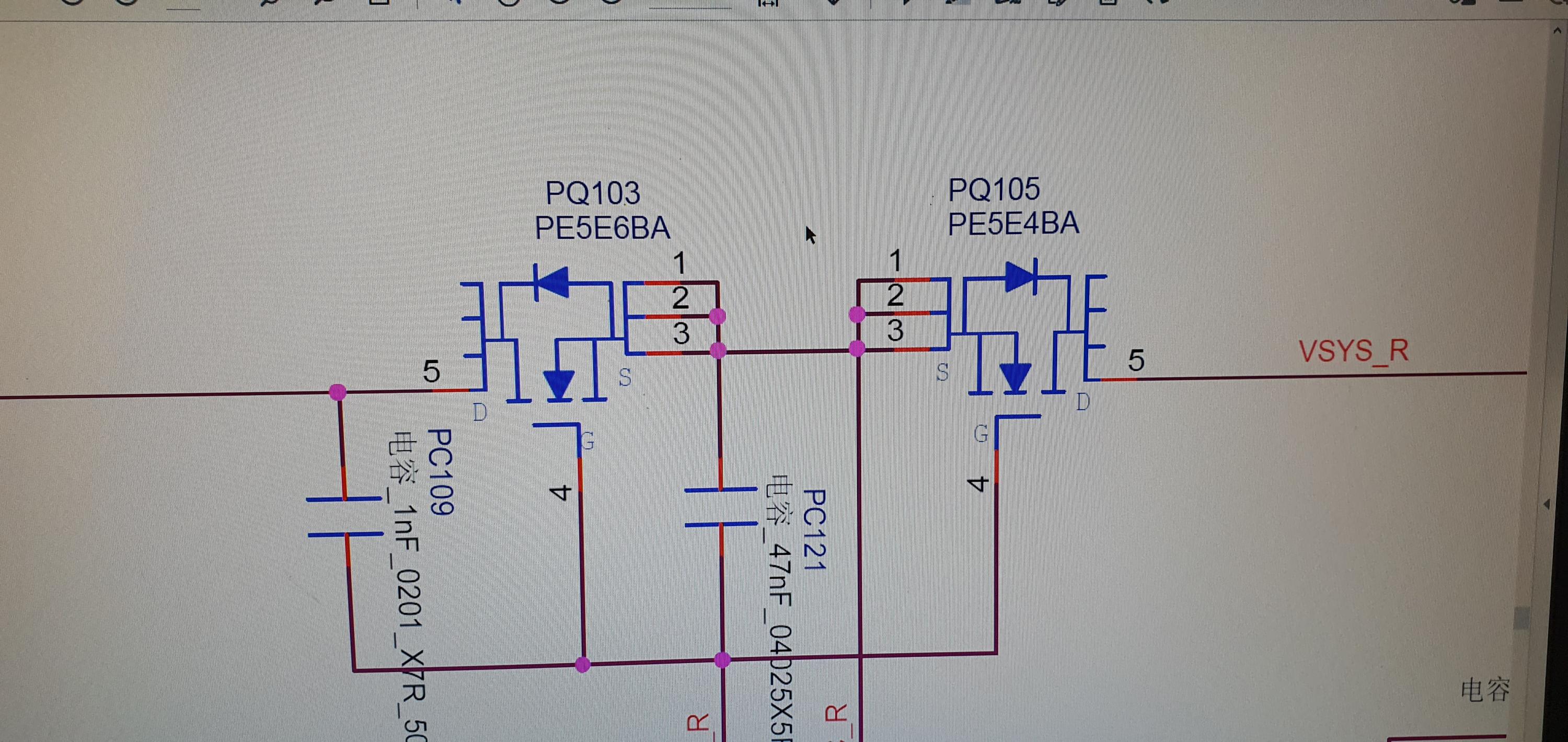

    Hi all .. I'm asking for help with a problem with an Acer A315-22
    connected to its power supply with the tester I detect the voltage up to the DRAIN of the PQ103 ... then nothing more
    I ran these tests
    with the mosfet still welded I activated the GATE of the PQ103 and PQ105 I detect continuity with the tester from the Drain of 103 to the Drain of 105 ... but after 10/15 sec the continuity is interrupted
    I can't figure out what it could be... can someone please help me
    Thank you

    Re: Acer A315-22 no power on
    Test your 2 first N-Fets with out power and uplode the reading after PQ105 you have the CLR ( if you uplode the Schematic we can pin point you it ) test the CLR with out power if short to GND , the Gate of the N fets need a higher V to bypass this supply comes from the for example BQ24725XXX ACDRV pin
      Hi @techtiger .. I'm a beginner and through you I try to learn as many things as possible and sorry for my non-technical language .... what does "CLR " mean?
      please use more basic language with me ...thanks.
      Another test performed: the input power supply of the "PU101" is 19 volts...but I can't measure with the "ACDRV" output tester (GATE 4)...Although it can be measured with the tester or it takes an oscilloscope?
      I performed this test before your instructions arrived
      any help is appreciated

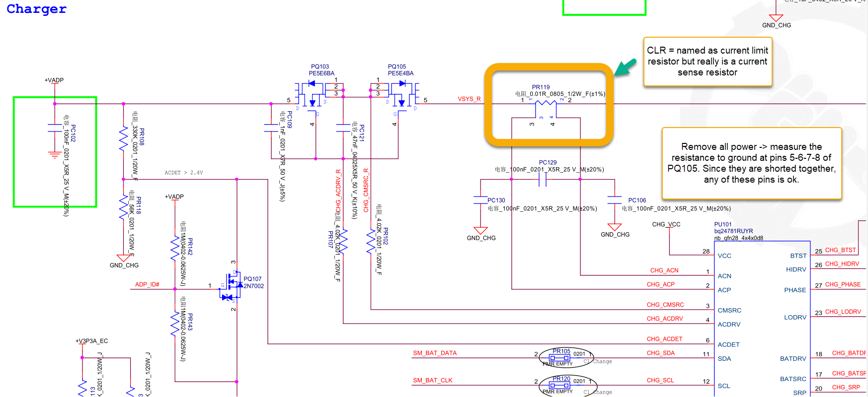

        See attached.
        CLR should really be CSR = current sense resistor. The charger IC @ PU101 measures the voltage going into this very low resistor value and then the voltage leaving this same resistor. By reviewing the voltage drop from input to output, the charger IC can calculate the current draw = 'load' of the main power rail.
        If the voltage drop is too high - for example if the trace is broken, then the charger IC will turn OFF the 2*DCin mosfets you see @ PQ103 and PQ105.
        Start with removing all power / no battery. Meter in resistance mode. Measure the resistance to ground of any of the following DRAIN pins 5,6,7,8 on PQ105. What is the resistance? If the resistance is too low, this may have damaged the 2nd DCin mosfet (PQ105).
        PQ103 and PQ105 are N-channel mosfets. This means that the GATE voltage pin # 4 must be HIGHER than the voltage being passed between source / drain pins to enable. Otherwise, these mosfets will remain OFF, unless they are leaking.
        Respectively, pin #4 = ACDRV on the charger IC and this driver pin should be ~25 volts if all is well. Often, the 2nd DCin mosfet gets damaged and must be replaced - see the very thorough article (sticky) above by @Piernov. It is a must read.
        If you do not see ~25 volts on ACDRV, then remove the series resistor @ PR107. Use flux and low air pressure to remove with tweezers. Do not lose this part.
        Then power up again. Now do you see ~25 volts at the PCB pad where PR107 was soldered? If yes, then at least one of the DCin mosfets is defective.
        Post your details of each measurement.
                    Review the voltage to ground of each pin on PQ107.
                    If PQ107 is enabled, then ACDET voltage will be shunted to ground.
                    Next, remove all power. Never measure resistance with power. Meter in resistance mode. Confirm the resistance across PR108. Then repeat to test across PR118. The resistance of each resistor must be close to the schematic values.
                    Next, meter in diode mode. Touch your meter probes together. Should tone beep. One meter probe between PR108 and PR118. Other meter probe to the ACDET pin on the charger IC. Should tone beep. We are checking to see if this voltage divider trace is reaching the charger IC pin.
                    Finally, meter in resistance mode. Measure the resistance of this required trace again. Should be ~0 ohms.
                    Post each measurement.
