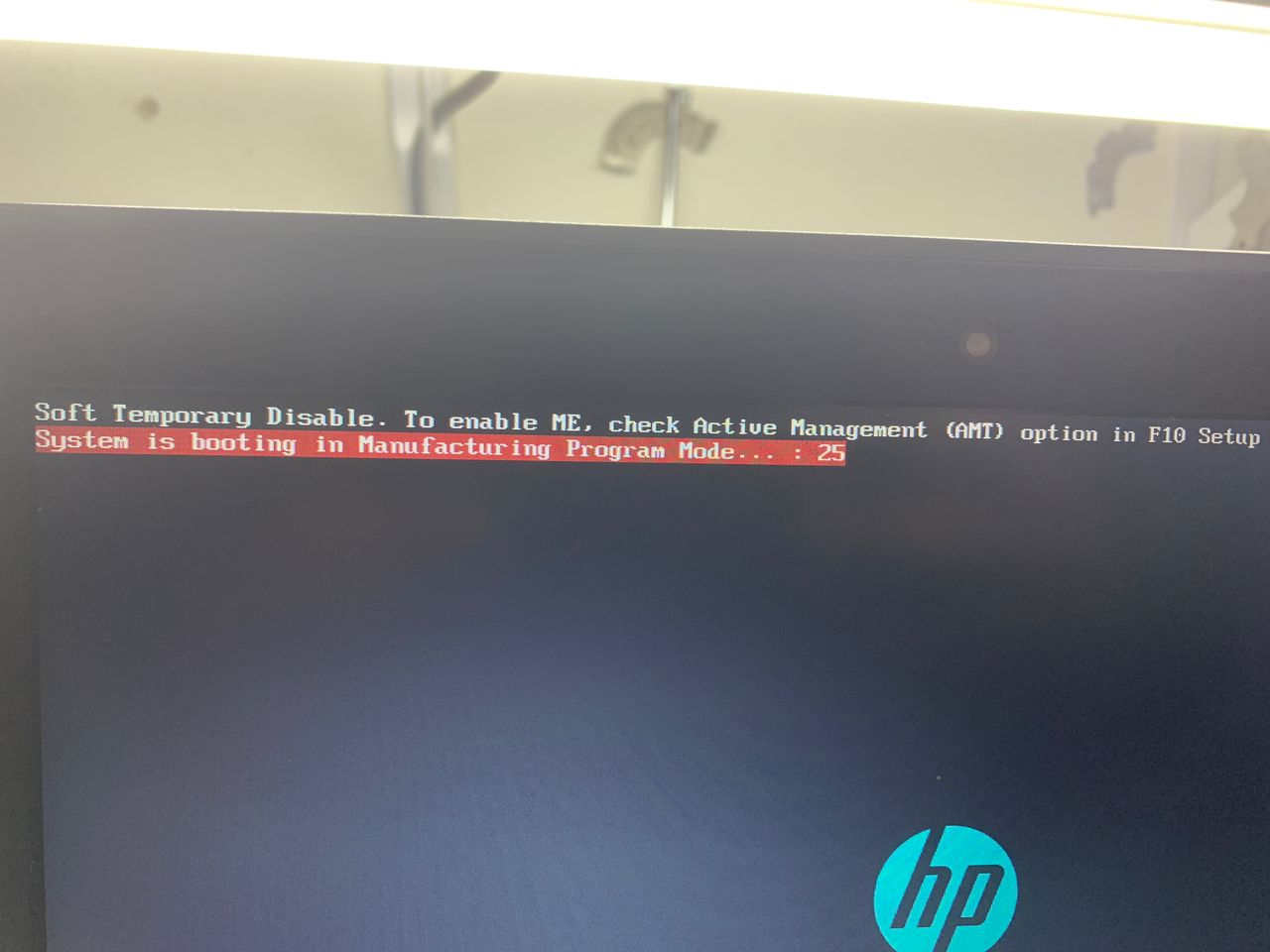

    hp probook 11ee g2 manufacturing mode
    customer said this happen after he sent laptop to another shop...how to solve this issue ya?

    Re: hp probook 11ee g2 manufacturing mode
    use BCU 4.0 or higher or restart laptop 25 times. Check if you have DMI in sys info, if not write them - you have a "set unique machine data" in Main tab.
      thank you sir...its working
