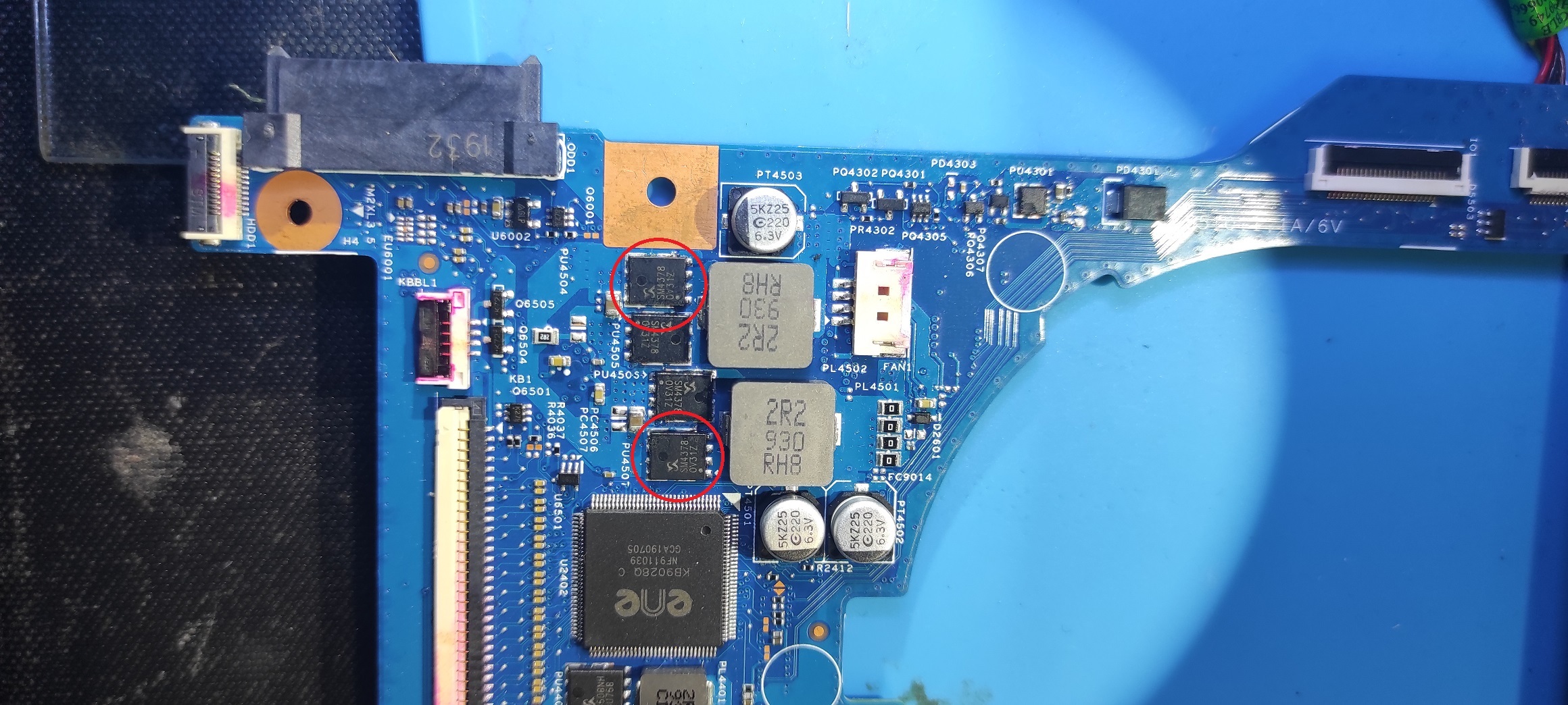

      I believe it is essential to find the schematic or the boardview of this motherboard. I can't even locate the main power lines. I observe that after removing the 3.2v/5v chip, which was heating up a lot, now there are two mosfets that heat alternately. That is, when I send current to the power connector, it's the one on the right that heats up first, and then possibly the one on the left. I'm a bit lost...

            No, you have not understood. "First do, then think" is the opposite of systematic troubleshooting.
            Meanwhile you made the issue worse two times in a row. The first time by injecting 13Volts into what I assume is a 5Volts rail and the seconds time you powered the device with High-Side Gates of 3Volts and 5Volts left floating. The Mosfets are heating up because you probably send 13(?)Volts through the High-Sides into the 3.3V and 5V rail (again) which most likely leave this board as no-fix from here.
            Curiously enough you did not took even one single resistance measurement so far.
            This all is no problem. That the first three or four boards you're trying to fix end up as no-fix is simply normal. However, i don't know who taught you to do how you do, but if you proceed like that with future repairs, you'll kill many boards without realising.

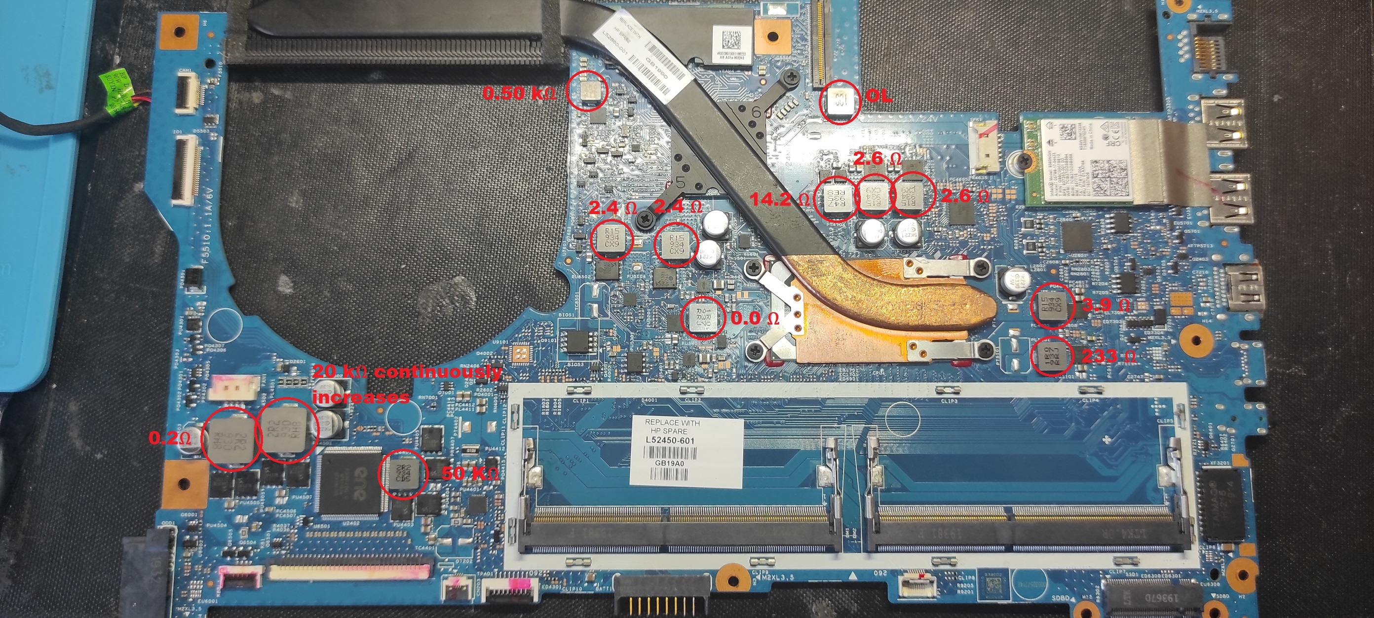

              That's not exactly the sequence of events. Originally, I had a problem with the main power supply, all my voltages were there, I had no short circuit and the computer was running only on battery.
              Without the battery and with the main power supply, it would try to start and stop after 2 seconds, looping 2 or 3 times then nothing. Then inadvertently, I took the probe that I used to power the computer through the battery connector (13v) to measure the 3.2v tension on a fuse. This was a big mistake, I admit, usually I don't connect my multimeter probes to the stabilized power supply, I have other probes for that! I don't know why I made this mistake, but it's too late. I'm not used to injecting current at random, I already knew that the computer was working on the battery, this was demonstrated by a partially charged new battery. Then yes, I briefly powered on with a 3.2v/5v chip desoldered from the board to check with the thermal camera which other component could be heating up, second mistake...
              Currently I'm waiting for your ideas before replacing the 3.2v/5v 1285B chip that was heating up after my unfortunate short circuit. Thank you for your attention and your time.
              Here are the measurements on the inductors.

                One coil with 0.2 Ohms to GND which I assume is the +3.3VALW and another dead short to the left of the CPU which I assume is the +1.05VALW.
                If this is true, and unfortunately this outcome fits pretty good to the history, then there is nothing to do for this poor board anymore.
