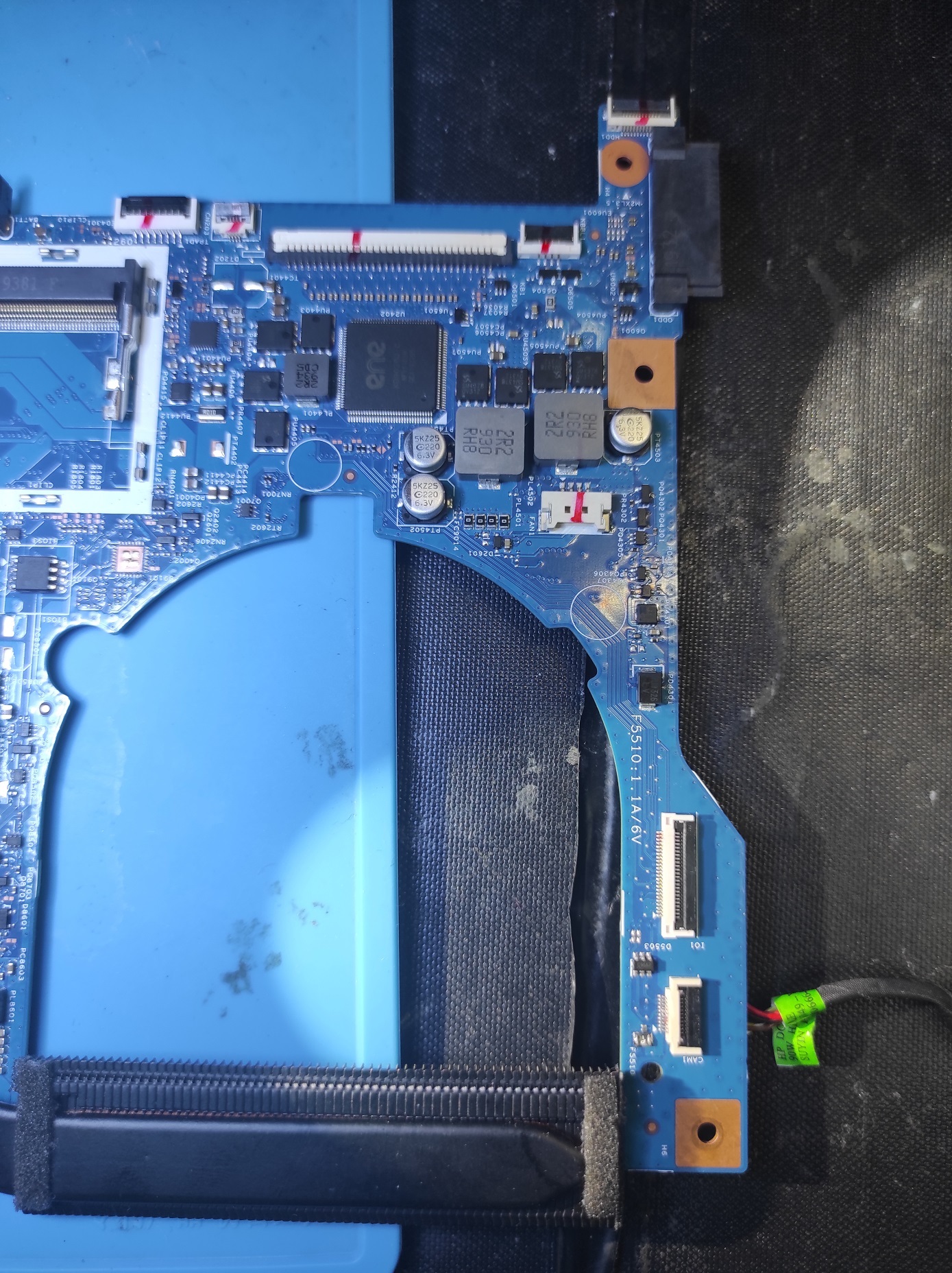

                                  Start with the DCin power connector and clear post pics of the top and bottom side of this region of the logic board.
                                  After the DCin connector will be the 2*DCin mosfets (8 pin) and these mosfets will be driven by the charger IC (often is the BQ series by Texas Instruments).
                                  Post the topside markings of each of these parts - the mosfets and the charger IC.
                                  With a multimeter, the topside markings of these parts and your eyes, we can review the position of this faulty logic board.

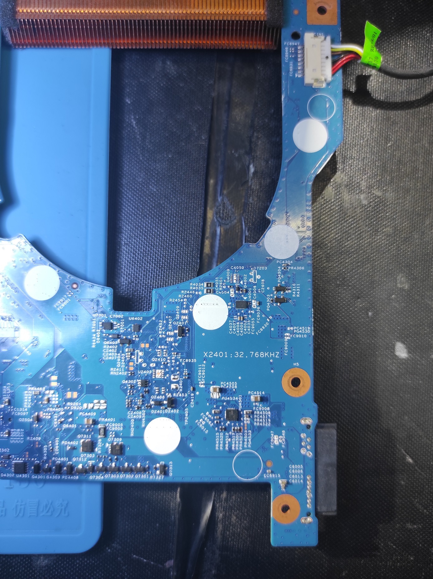

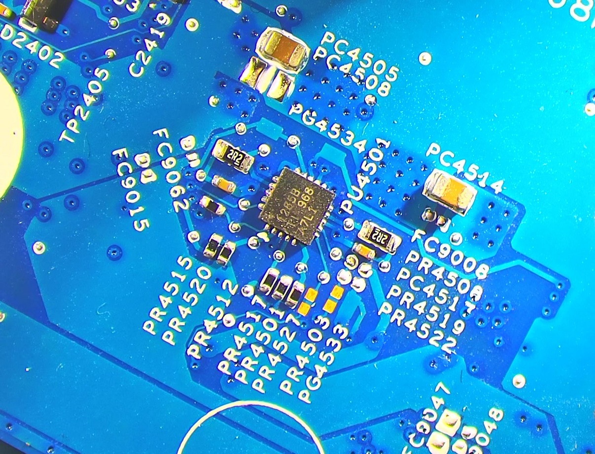

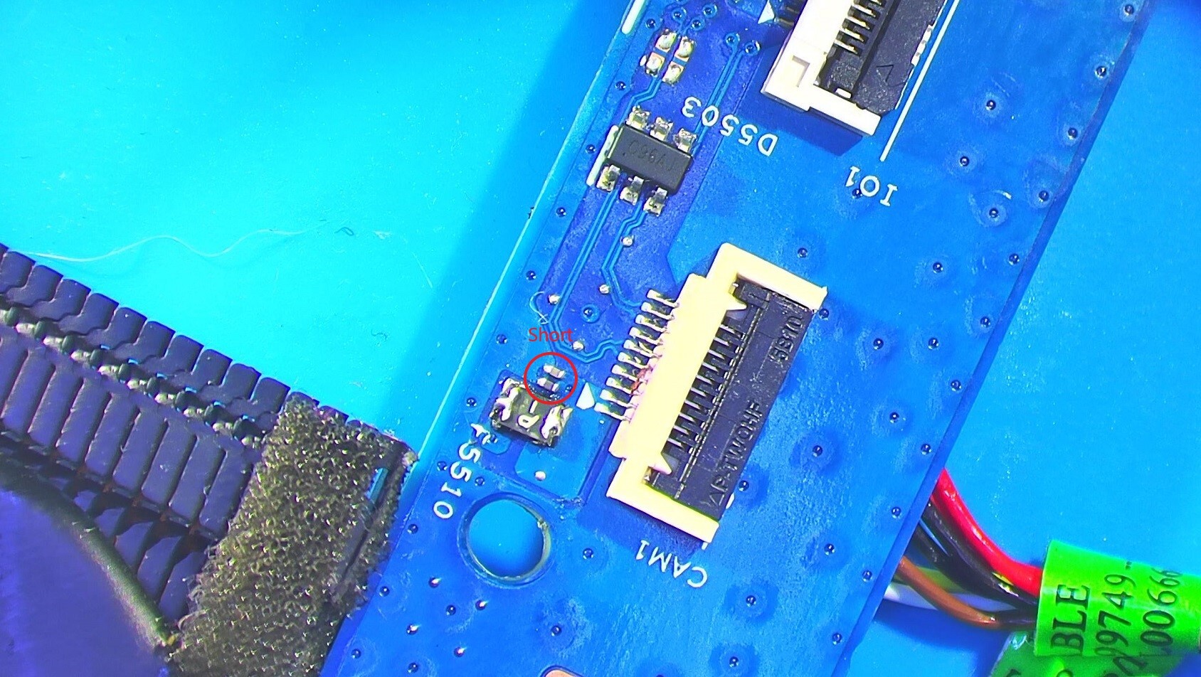

                                    In fact, I have a big problem, I made a mistake. I had placed my two current injection probes for tests on the battery connector (13 volts) nearby. A little later, I wanted to measure the voltage on the fuse that we see in photo 3 and, due to a lack of attention, I picked the wrong probe. Instead of taking the one from the multimeter, I took the one from the power supply! The result: a short circuit, the 3v/5v chip we see in photo 4, PU4501 ((1285B), is in a short circuit. With the thermal camera, it heats up to 100° (I have nothing else that heats up) and the board's power consumption in standby mode is about 0.250 A. Moreover, it is difficult to see on the motherboard the main Vin 19v line, I can't even find the shunt resistor.
                                    In the photo below, we can see two capacitors. This part of the board is short-circuited. After taking the photo, I removed them, but it's still short-circuited.

                                      Re: HP Envy 17-ce009nf laptop that won't start
                                      The second photo is a duplicate, here is the correct one.

                                        What are the top side markings of PU4401 ic in this last picture? This is the square ic with pins on each side and close to the memory socket.
