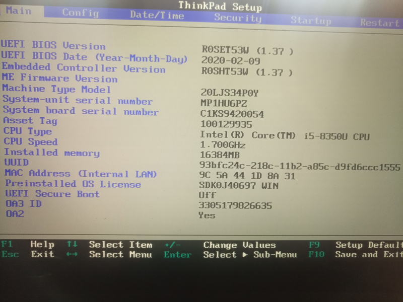

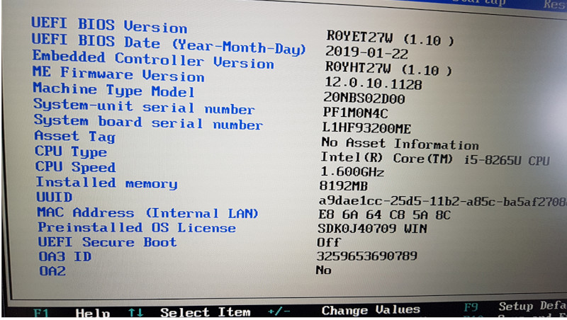

                Maybe the problem (Long time to boot until seeing the Lenovo logo) is related to this that I have discovered.
                ME (Intel Management Engine) firmware is missing in the BIOS
                This is a normal X380 yoga bios for comparison
                I have tried to install ME Firmware from Lenovo in windows but it gives this error:
                Error 8193: Fail to load MEI device driver (PCI access for Windows)
                Above error is often caused by one of below reasons:
                Administrator privilege needed for running the tool
                ME is in an error state causing MEI driver fail
                MEI driver is not installed
                And getting info with MEInfoWin64.exe
                Intel(R) MEInfo Version: 11.8.83.3874
                Copyright(C) 2005 - 2020, Intel Corporation. All rights reserved.
                Error 86: Communication error between application and Intel(R) ME module (FWU client)
                Error 81: Internal error (Could not determine FW features information)
                Could this have anything to do with flashing the BIOS?

                • Sephir0th
                  • Oct 2020
                  • 1289
                  Re: Thinkpad Yoga X380 with melody at boot
                  It needs a "Clean ME" in addition. Nothing more

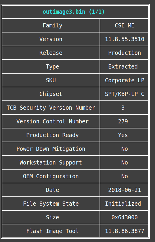

                      I cannot generate a image with cleaned ME.
                      MEAnalyzer says:
                      Family CSE ME
                      Version 11.8.55.3510
                      I have found these two possible ME firmwares from Intel:
                      11.8.55.3510_COR_LP_C_NPDM_PRD_RGN
                      11.8.55.3510_COR_LP_C_YPDM_PRD_RGN
                      I am using Intel Flash Image Tool version 11.8.86.3877
                      I generate a new image following instructions on
                      https://www.badcaps.net/forum/showpo...41&postcount=3
                      But when I check with MEAnalyze outimage.bin:
                      it Says Type Extracted and Initialized. I was expecting for type Stock.
