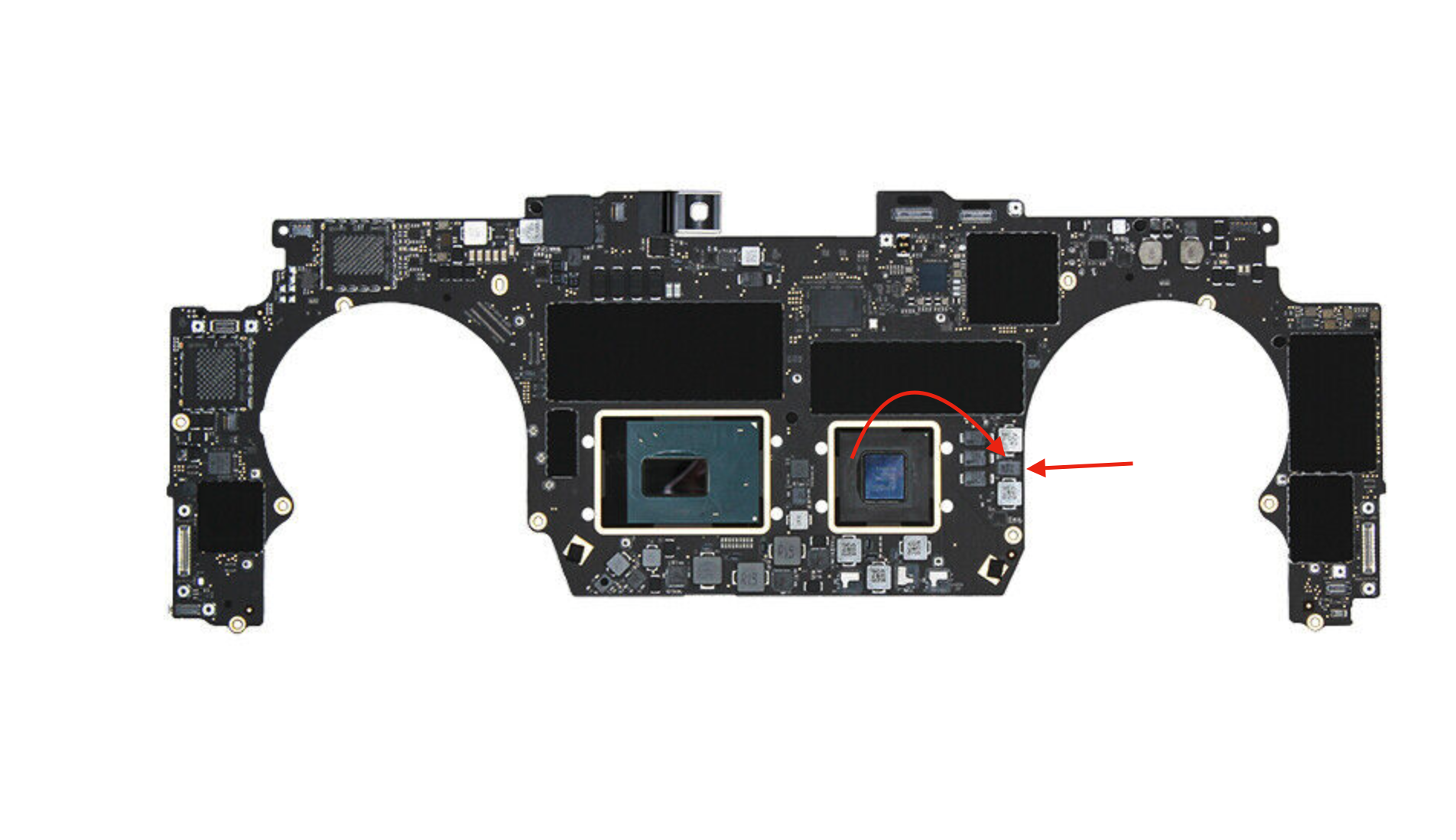

    Re: Macbook 820-01814 PP3V3_G3H short
    Hello I had the same problem , today I solved it was W710 in short
    • MacMazel
      • Aug 2023
      • 3
      • Czech republic
      here is the position of bad component
        Thanks for the fast reply! Unfortunately, that appears to be a different model board and I can't find W710 on the schematic for my board to try to locate a similar part.
        Thanks though for your help, appreciate it.
