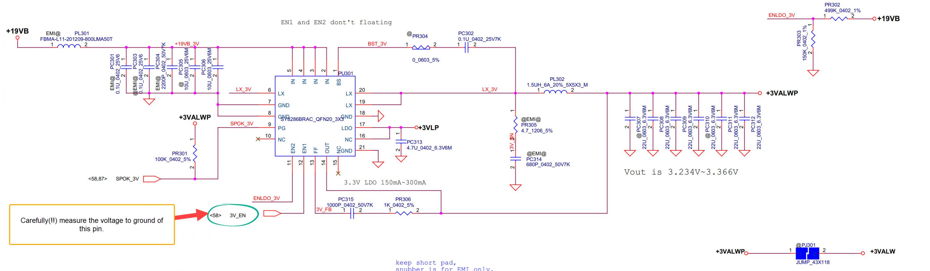

Have acer laptop motherboard la-k092p 3v always not coming but 5 v always is available.no shorting on 3 v coil and 3v enable is not coming how to solve this problem
La-k092p acer motherboard no power

1) schematic is here:
https://www.badcaps.net/forum/showpo...69&postcount=1
2) Remove all power. Meter in resistance mode. Measure the resistance to ground of the same enable pin (3V_EN).
Next, meter in DIODE mode. Red meter probe, yes red to ground. Black meter probe to 3V_EN.
What is the measurement? -

Remove RB7/RB1 & DB1. Check resistance to GND on DB1,pin2. If its not showing low resistance, just jumper a wire between pin1-2 of DB1. Hope this will solve your problem.Comment
Re: La-k092p acer motherboard no power
In theory,thats how it should be. But it wont happen as thermal protection has kicked in. This is just my method to bypass thermal protection on Acer's.I've even replaced SIO,programmed it but thermal protection remains on acer. may be someone here knows another way out. Will look for such suggestions. Lets learn from each other.Comment
