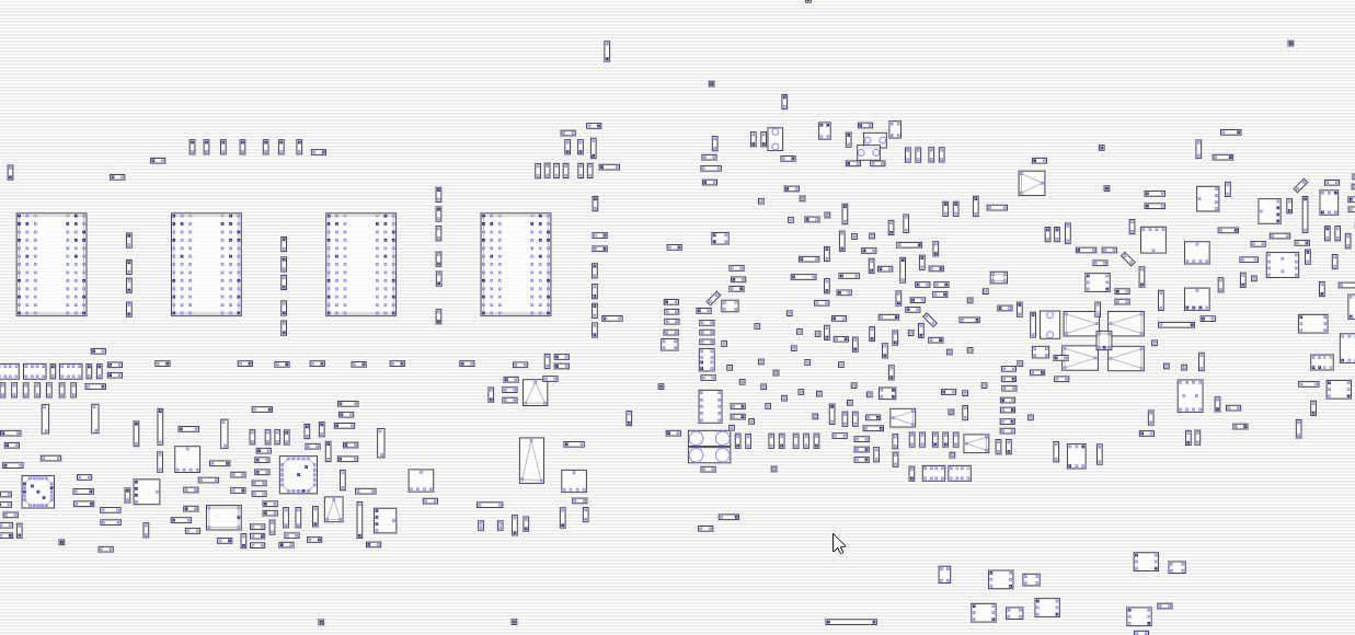

    Hi, can someone help to provide the way to disable onboard RAM for Asus S400CA Rev 3.1?
    I tried Rev 2.1 way, to switch 2 resistors but not working, board still recognise on board RAM.
    What I switched :
    R2425 -> R2423
    R2424 -> R2422
    Thanks.

    can you post a picture of this secion?

      Nvm, already fixed, on board RAM have no problem, resoldering one of the resistor fixed the problem on board RAM, already tested and past back to customer. Thanks anywhere.
