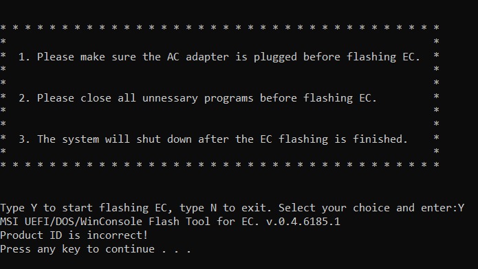

          Now I'm facing another problem.
          I need to flash the P65 9SE "EC firmware" to the GS65 9SE mainboard EC chip but the software complains.
          So I need to change the headers of the EC firmware file but don't know how to do.
          https://www.badcaps.net/forum/attach...1&d=1686774006
          If there is someone who can tell me how this works please let me know.
          Regards, Geert
