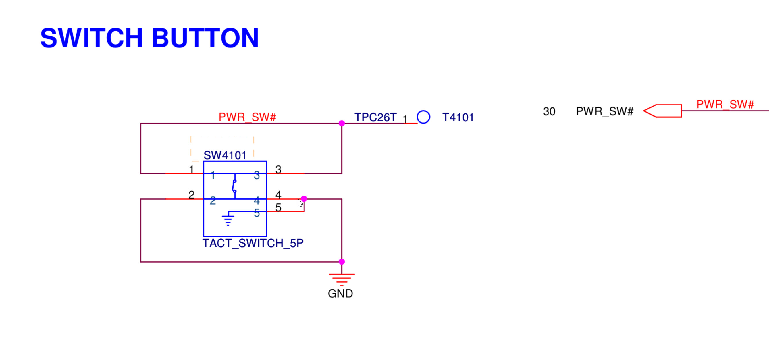

    k50ij main board rev 2.1 it wont turn on
    Hi i got a same problem on my k50ij main board rev 2.1 it wont turn on .�� .i just used yesterday everything is Good.but now it wont
    No lights or total dead.i need guide were to look ��

      I notice the power switch wont turn on or it doesn't work .
      is there a way to make it auto on while i plug my charger?

        Re: k50ij main board rev 2.1 it wont turn on
        Does Anyone had an idea to auto startup a k50ij asus laptop ?when i plug my charger? Cause power button is not working.
          Is that the only fault with the board?
          Will check against the schematics once at the office.
            See above. Locate and confirm if there is a pushbutton switch on your board to mimic the on/off function.

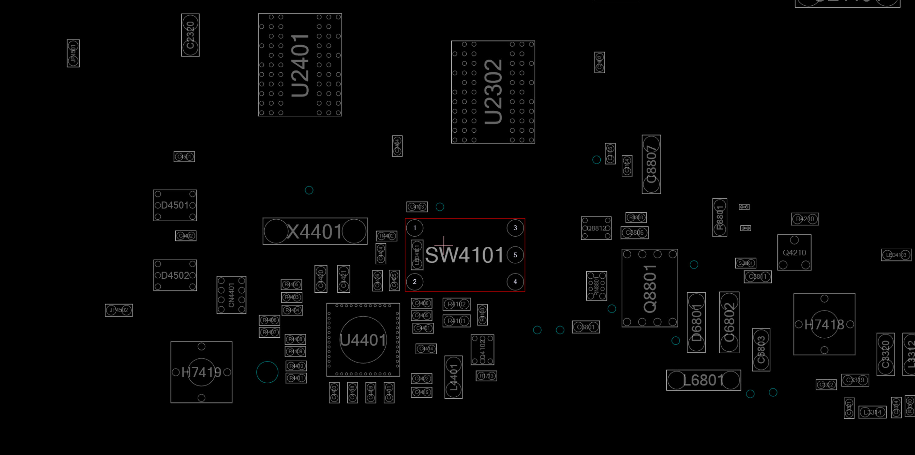

              Yup thats it on boardview .im now quite confused 😶😶😶what is negative and positive to make it turn on .also i try buy the button for my laptop but its not available on my hometown.can u gave me a switch type i should used,?
                Measure the voltage to ground of pins 1 & 3 (either is ok as they are the same).
                If you use tweezers or a piece of wire between pins 1 & 2 OR 3 & 4 (either pair is ok), this should act like your ON/OFF button.
                That is, when the ON/OFF signal line is brought to a LOW level, you should be able to turn ON the logic board or OFF if it is ON.
