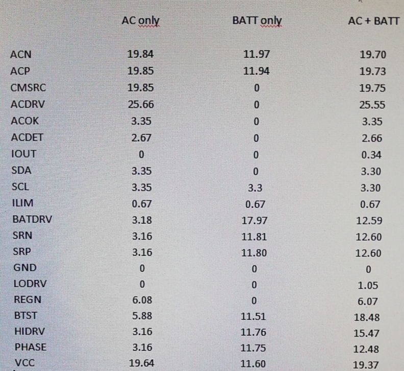

    Are you sure about your measurements. With adapter only and with battery only-ACOK cant be of same value.
    • zioricci
      • Jan 2023
      • 125
      • Italy
      #42
      Re: Toshiba Satellite P855 charger disabled after a while
      You're right, sorry..between translations, measurements and acrobatics I uploaded the wrong image, that image refers to BATT + AC. This is the correct image. Battery voltage is 12.30V and Windows reads 85 %.
      • mon2
        • Dec 2019
        • 14636
        #43
        SDA should not be 0v with the battery only case. Confirm this voltage again.
        • zioricci
          • Jan 2023
          • 125
          • Italy
          #44
          You're right too, I didn't touch the multimeter tip properly.
          SDA 3.34 v
          • mon2
            • Dec 2019
            • 14636
            #45
            These readings (with the SDA correction) look good. The battery should be charging with the battery & power adapter connected to the logic board.
            Do you see video and a normal boot with this unit? Windows showing the charging icon?
