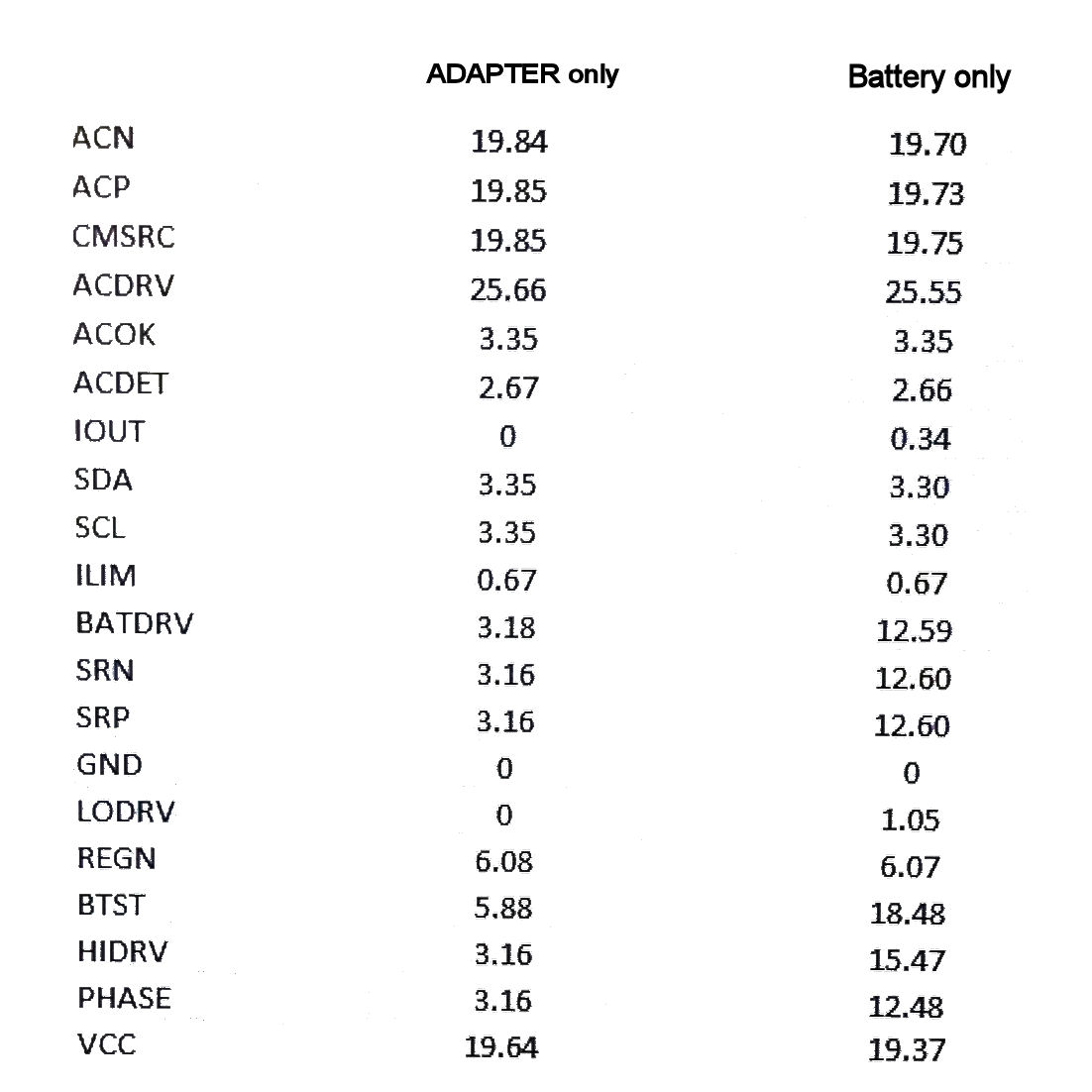

                              Given that ACOK is high, the charger deems the adapter to be OK. Based on this status and that REGN is 6 volts, the ACDRV must be boosted and kept boosted to power the board.
                              Sounds like an internal failure of the charger IC.
                              After the ACDRV is OFF, after the xx minutes of use. Measure the voltage to ground of REGN. Confirm that ACOK remains high.
                              Time to replace the charger IC.

                                        Today i did a reflow on BQ24725 but without success and then i re-soldered all the pins of bq24, they were dull.
                                        I also re-welded PR221 and magically the battery started charging again, and the charging LED became amber but, as already happened, after a while the charging LED went off (100% charged, a coincidence ?).
                                        The evidence is therefore:
                                        charge LED off (charge interrupted or reached 100%), to turn it back on i can do 2 things, either i remove and put back the adapter plug, or i shut down the laptop, in both cases the LED turns on again and battery charging starts again .
                                        If, on the other hand, i abruptly remove the battery while the laptop is on and the charging LED is off, the laptop suddenly shuts down.
                                        Note:
                                        For more than half an hour, the charge has stopped at 99%.

                                          While waiting for the charger IC to arrive, I measured again the voltages on the charger IC and I think this time they have quite normal values ( see photo ),
                                          but i have this problem:
                                          when the battery is 100% charged the LED remains orange and does not turn white.
                                          What could be the cause, again the charger, or on the Super I/O, since in the motherboard schematic there is the BATT_FULL_LED# signal coming to the Super I/O, or could it depend on the battery itself ?
                                          thx
