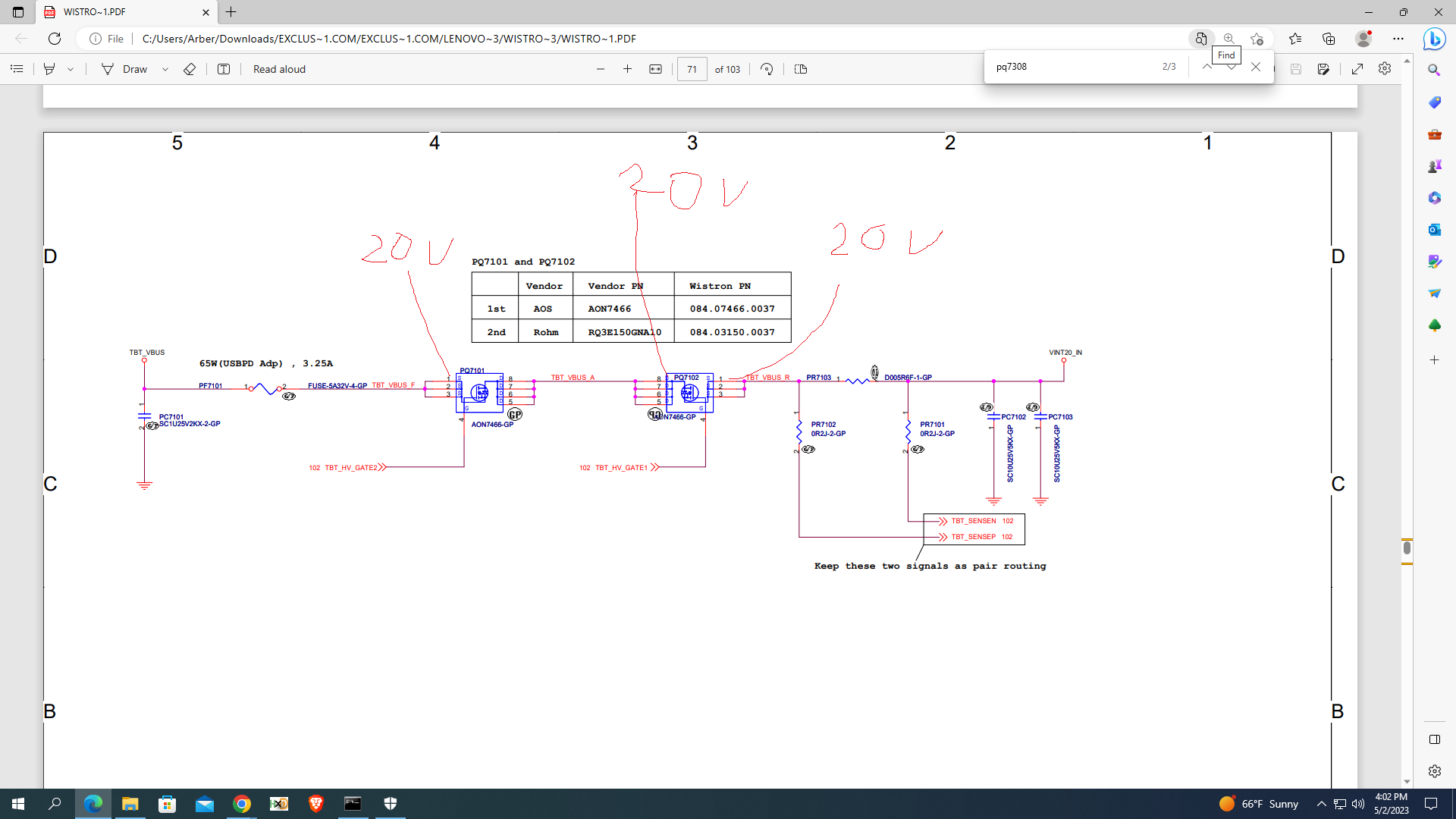

    hello I have a lenovo t570 laptop that has water on board. I cleaned the board well with solutions for the board, dried it well and tried to turn it on, but it didn't turn on. I made some measurements 20v is the voltage in dc in and in the first mosfet I miss VSYS 3.3v and 5v
    Laptop have 2 dcin i use type c charger i try and lenovo charger with with a yellow head
    THIS IS SHCEMATIC

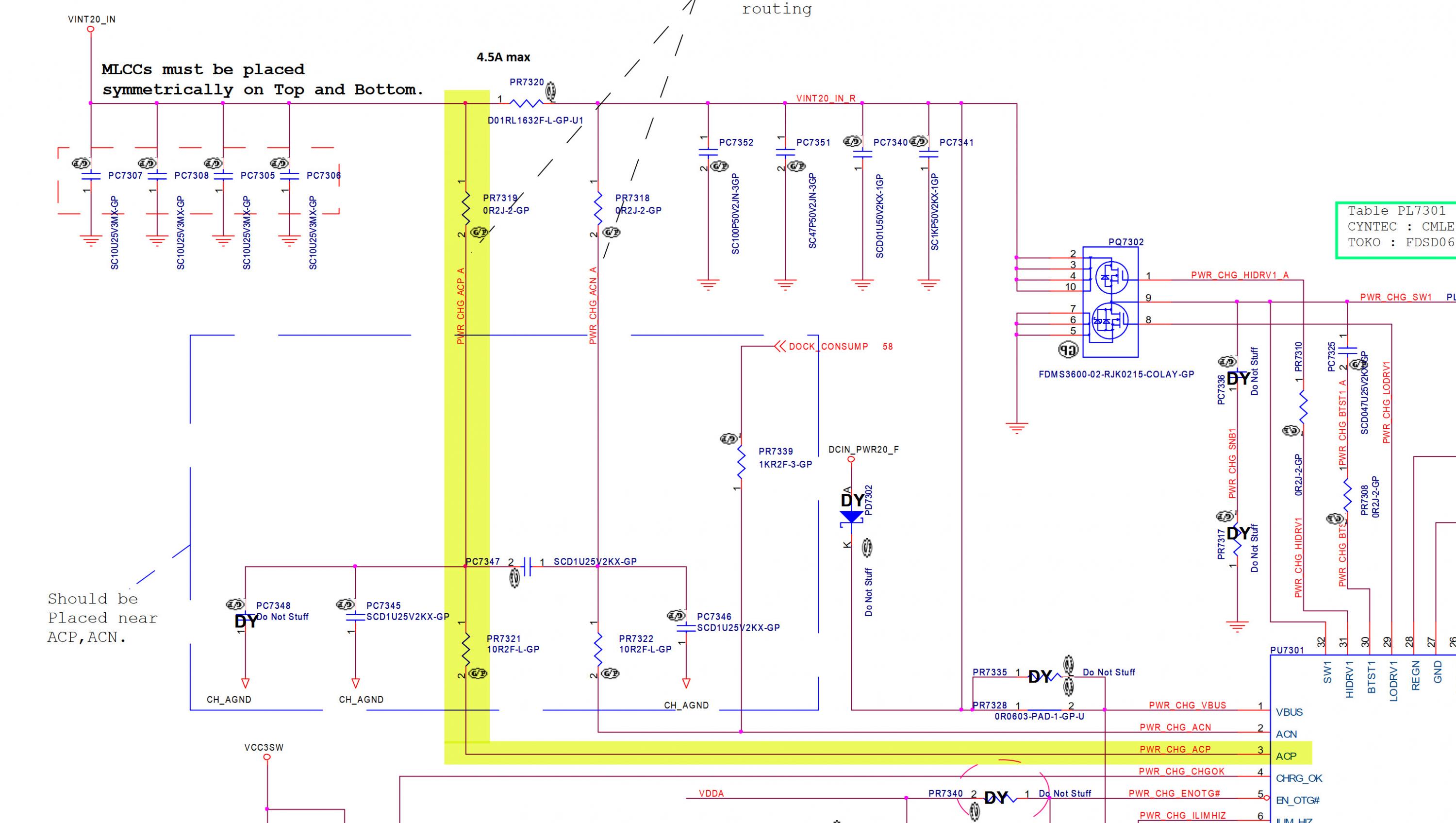

    Check the voltage to ground of PU7301:
    pin #1 (VBUS)
    pin #2 (ACN)
    pin #3 (ACP)
    pin #4 (CHRG_OK)
    pin #28 (REGN)

      Re: Lenovo T570 not turn on
      pin #1 (VBUS)=20.23v
      pin #2 (ACN)=20.23v
      pin #3 (ACP)=0v
      pin #4 (CHRG_OK)=0v
      pin #28 (REGN)=6v

        pin #3 (ACP)=0v
        Confirm this voltage to ground measurement. It should not be 0v unless there is a trace break or a resistor is missing between pin #3 of the charger IC and the current sense resistor @ PR7320 (pin #1).
        To check the resistance, remove all power -> meter in resistance mode (lowest scale).
        Measure the resistance with one probe @ pin #3 of the charger IC; other meter probe @ pin #1 of PR7320. If you do not see a low resistance (~10 ohms), there is a fault in this trace.
          yes is 10 ohms

            Then the voltage on pin #3 should not be 0 volts -> confirm it. Should be the same voltage as the ACN pin.
              I measured it now with a device with thinner pins and the voltage is 20v

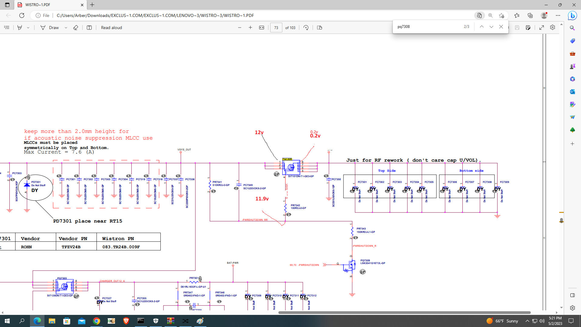

                Measure the voltage to ground of VSYS (pin #22) on the charger IC.
                Measure the voltage to ground of RTCVCC.

                  i see in this place is not normaly can you confirm it ?
                    VSYS 12.36v
                    RTCVCC 3v is battery bios ?
                      The mosfet is a P-channel so this means that the gate voltage must be lower than the voltage being passed between the source / drain pins to ENABLE.
                      Since gate voltage is the same, this mosfet is OFF.
                      Take a piece of wire and connect one side to pin # 4 (only) = GATE. Other side of the wire to ground on the logic board.
                      This act will force this P-channel mosfet to turn ON.
                      Test it.
