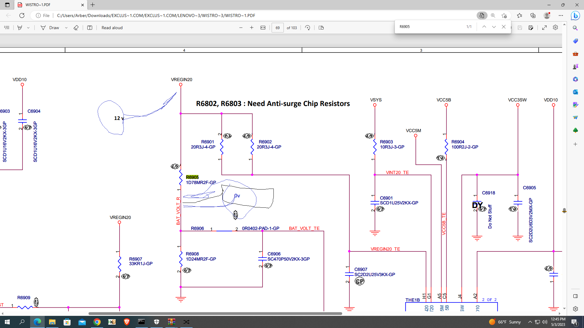

    Re: Lenovo T570 not turn on
    i not understand what you need
    Is normal to heve 0v in other side R6905?
    I see VCC3M missing in board
      No it is not. Confirm that R6905 is onboard.
      Remove all power -> meter in resistance mode -> check the resistance between the 2 pads for R6905.
      This missing voltage is used to power THE1B core.
              R6905 (pin #2) to VREGIN20 should be ~0 ohms, according to the schematic.
              R6905 value - not sure. DO not bypass R6905 till we know the value for sure.
                Yes from VREGIN20 to pin 2 R6905 is ohms

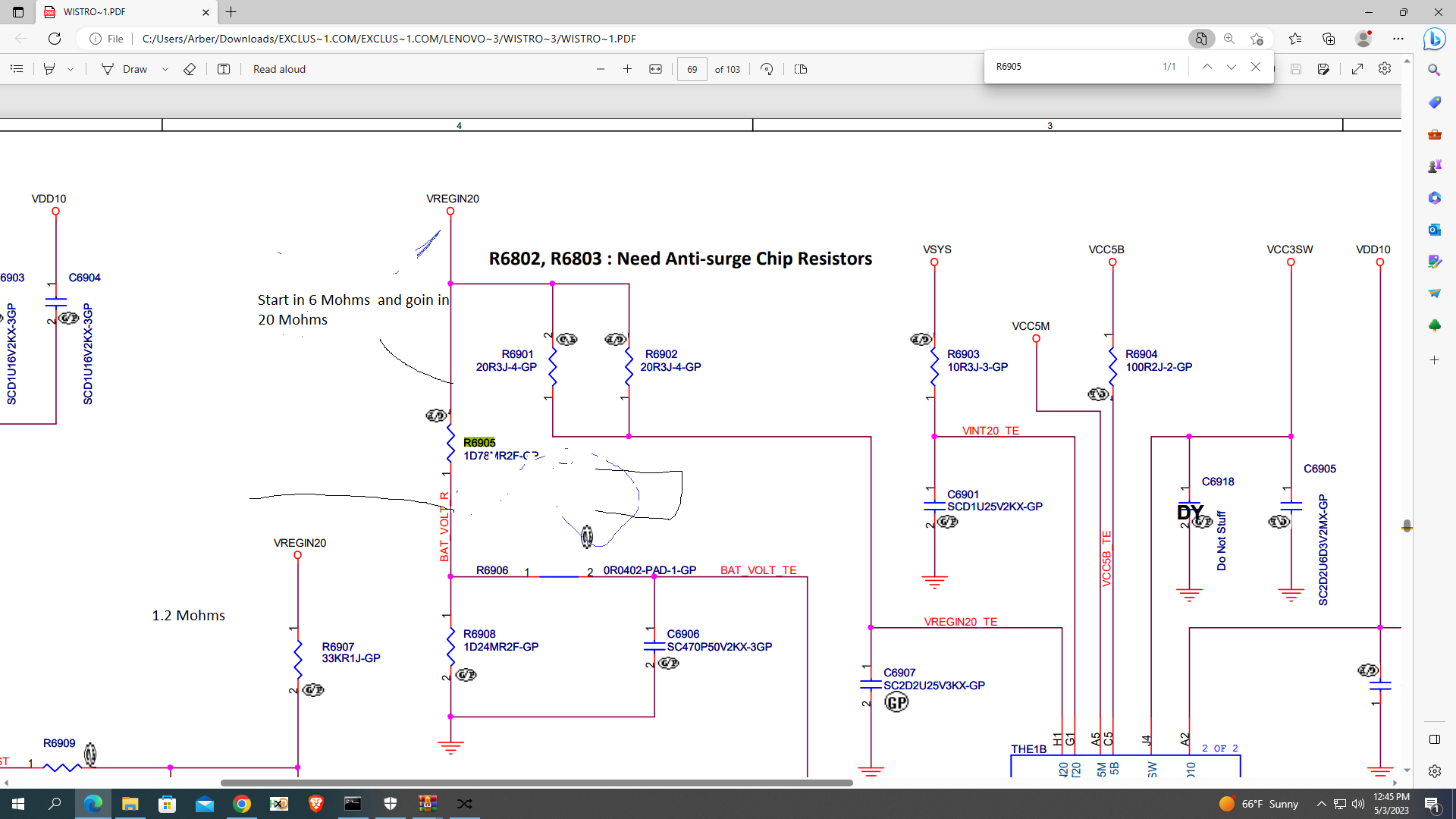

                  What resistance do you measure for R6905? Remove all power. Measure across the R6905 pads.

                    #29
                    Value change is not stably start from 10 Mohms

                      #30
                      This is not a good value for this resistor. This resistor and the one below it work together to lower the adapter voltage. Acting like a voltage divider.
                      What is not known at this time is the true value of this resistor.
                      Is the resistor below this one in the schematic stuffed on the logic board?
                      At this time, we do not want to bypass R6905 till we know more about this design. The target chip can be damaged if the power rail of ~19v (adapter) is applied.

                          #32
                          What about R6908 resistance ?
                          R6905 & R6908 work together to build a voltage divider to lower the main voltage rail to a safe value for THE1B.

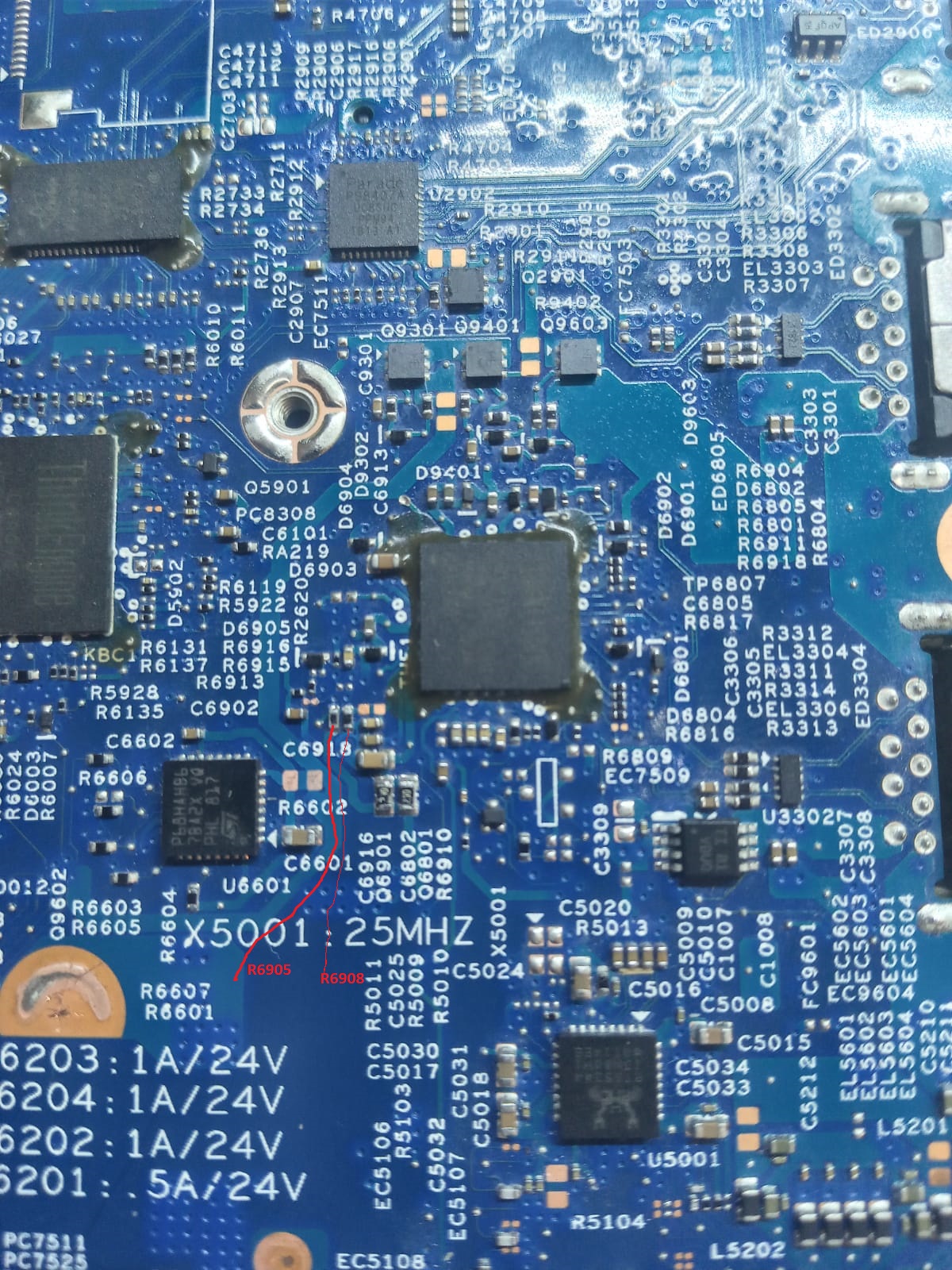

                            #33
                            R6908 is 1.2 Mohms

                              #34
                              Then r6908 cannot be a voltage divider resistor with such a high resistance value. If this THE1B is able to support a high VCC power rail, only then we can consider to short the missing resistor. Is this a part on the logic board or a pcb trace? Can you post a clear pic of this area?

                                    #37
                                    when i replace R6905 with R6908 laptop turn on . on side R6905 is 12 v an other side is 7.5 v . I remove R6905 and resistor is bad not value . Can i replace R6905 with value 1.2Mohms ?

                                      #38
                                      R6908 is too high of a value.
                                      Can you post a pic of your meter face while you are measuring r6908?
                                      To me, at 1.2 mega ohms, this circuit leg cannot function.
