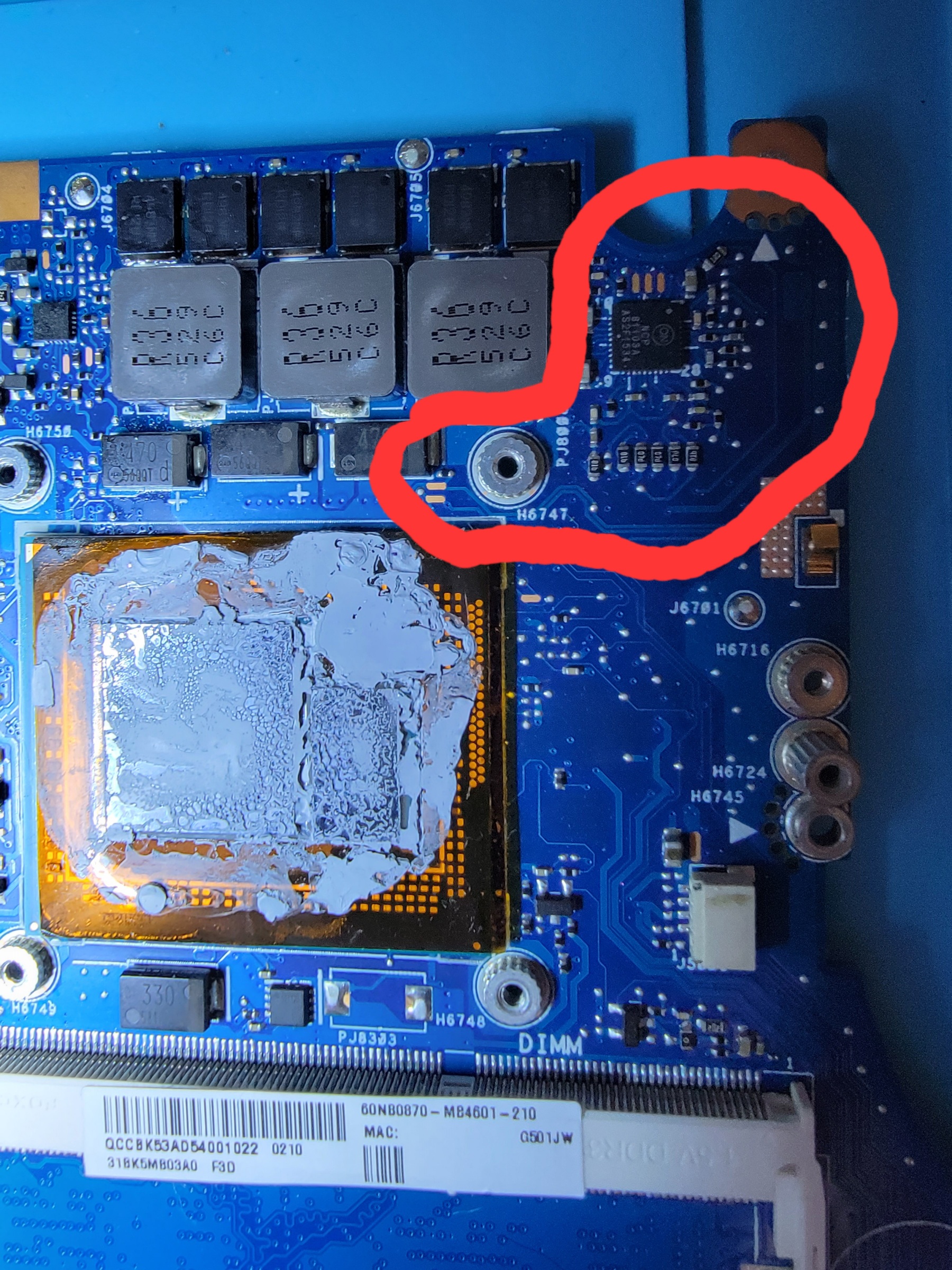

    Going to probe around and check the 1.05v rail like Reformatt suggested. Got side tracked yesterday. Will post results. But the rail i was checking below that i found the short on is posted below. There is a controller chip on that rail. I will be checking that today for restistance to ground.
    P_VCORE_VSP_10 - *Shorted*
    1. PC8012
    2. PC8055
    3. PR8051
    4. PSL8006
    5. PU8000
    Picture of the area in question please where you measured the "short". I don't like to drive in circles...

      #62
      Re: Asus Model G501j , Board N501jw short at AC_BAT_SYS
      Yeah sure thing. Totally understandable. Otherwise we are just at a Nascar race. Drive fast turn left! Haha Here is a pic of the shorted area. Thanks again.

          #64
          i finally realized you refer to the boardview without mentioning it. So now i want to understand why you randomly measured Pin 34 of the VRM controller without any reason? And when you do so, always share EXACT resistance to GND. Except you like, when the people here have to ask again, again and again.
          So what value did you find at VCCSENSE Pin...?
          Edit: Same for the +1.05VS rail ofc.

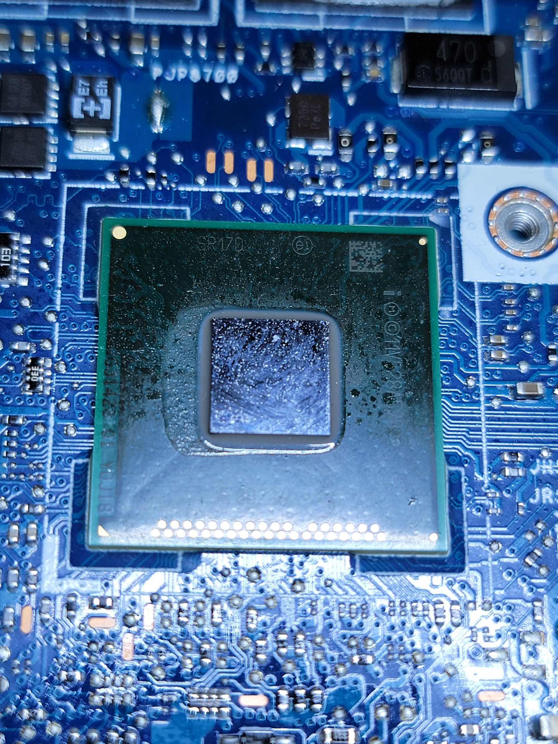

                      #70
                      And now we want to inject 1V into pin2 to confirm a shorted PCH.
                      FairRepair on YouTube
                        #71
                        I have the wire connections ready. Just waiting on phone battery to charge. I need to get a straight up thermal camera and sell this ios Flir One pro. I will report back asap.
                          #72
                          Okay injected 1v @ 1a on pad 2 of PL8200. The board pulled a 1 amp draw. But nothing got hot on the board. At least not visible to the thermal cam. I tested front and back of board for heat.
                            #73
                            1Amp might be not enough then. Concentrate on the platform controller hub (PCH). I'm pretty convinced it is the culprit.
                              #74
                              Try 1v @ 1.5 amps? Is this the PCH?

                                U2001 = PCH not GPU haha

                                  1v injection @ 1.5 amps. Nothing noticable on thermal cam.
                                    #77
                                    It is. It seems you need more current or a better thermal camera.
