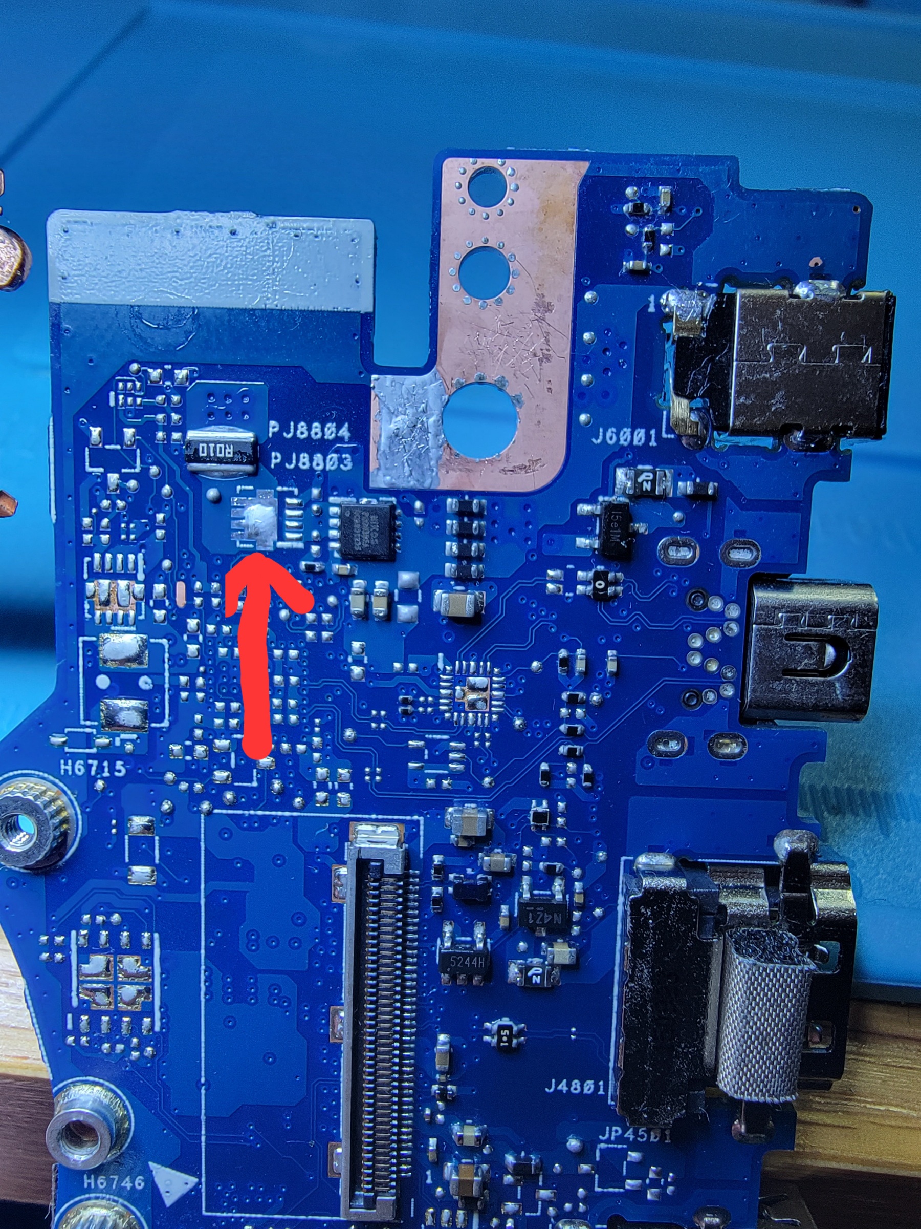

                                Here is a picture pointing to pin 5 of the second mosfet. Which is where I first notice the short.

                                      Generally, if you're not getting volts past the first two MOSFET's, first thing is you check resistance to ground at the current sense resistor and you troubleshoot from there. Most charger IC's detect the short and remove the drive to protect the laptop.
                                      With any luck, being an ASUS, it's just a shorted cap on the main +19V rail. But can also be a shorted high side MOSFET for the CPU/GPU. Quick check is to measure resistance between the CPU/GPU coils and the current sense resistor for the +19V rail. If you get low ohms, you have a shorted high side FET and your silicon is probably toast.
                                      • TheWizard
                                        • Feb 2015
                                        • 190
                                        Re: Asus Model G501j , Board N501jw short at AC_BAT_SYS
                                        Reformatt,
                                        Resistance to ground from current sense resistor is 1.5. What is considered low ohms from current sense resistor to CPU/GPU coils? Mon2 is also assisting me. Thank you to you both. I appreciate it. This one has been a headache. Normally i am the first one to open up a device. This one not so much haha
