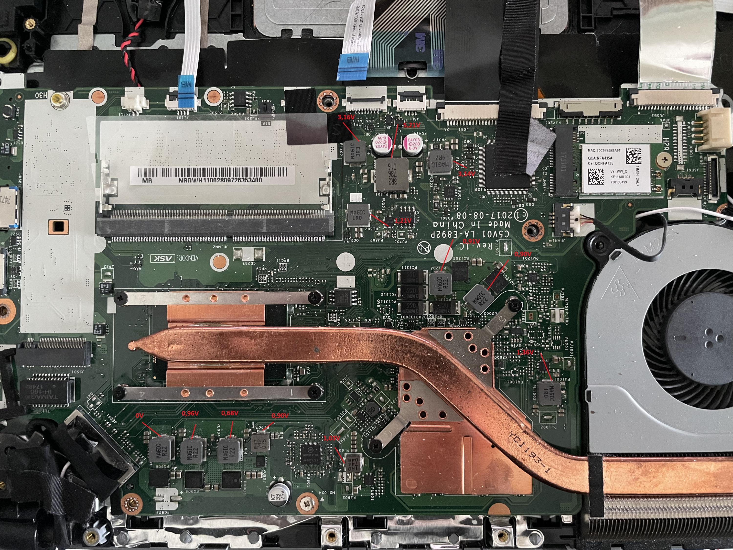

                        PLT_RST 3,35V
                        for the moment I have made the measurements on the coils (see photo)
                        it seems that PL096 has no voltage so also +VCC_GT

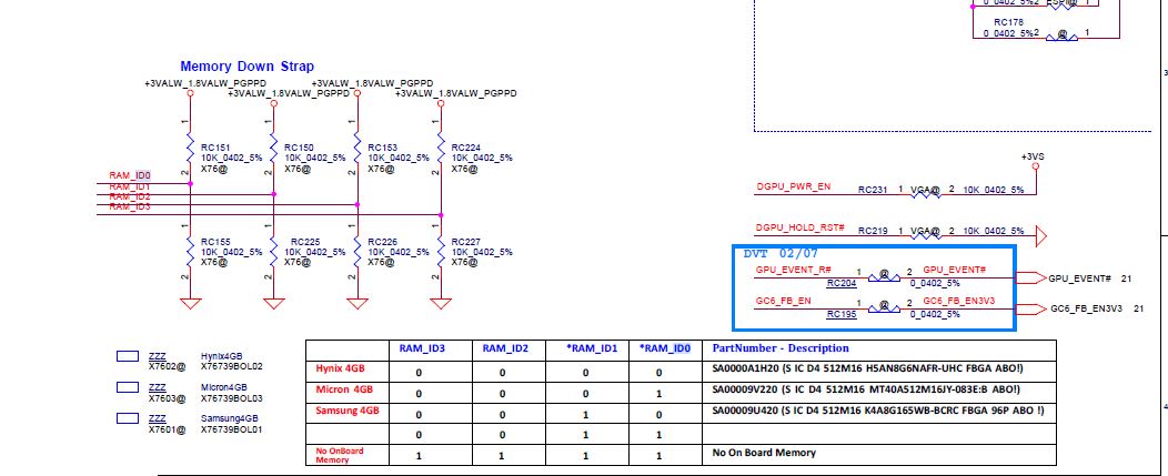

                          Can you tell me how do I disable the internal ram module on this model?
                          thank you!

                            Re: Acer Aspire 5 A515-51G power on but black screen
                            Look at page12 of diagram. Its detailed there. Shifting of resistors depends on which brand of onboard ram you have. The concept is to pull alll the ram id's to "1" to make it no onboard memory. If you dont understand it still, tell us the onboard memory details.

                              I wanted to ask if I'm thinking right:
                              the ram module is samsung so i should move the resistor that is on ID1 to the left, right?
                                Correction: ID3, ID2 and ID0 must be moved to the right in my photo, is correct?

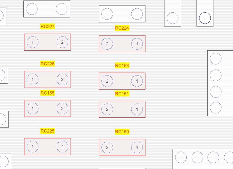

                                • mcplslg123
                                  • Jun 2015
                                  • 7262
                                  • india
                                  RAM ID_0/2/3 needs to be pulled to "1" This means shifting
                                  RC155 to RC151
                                  RC226 to RC153
                                  RC227 to RC224
                                  Boardview will help you locate these resistors.

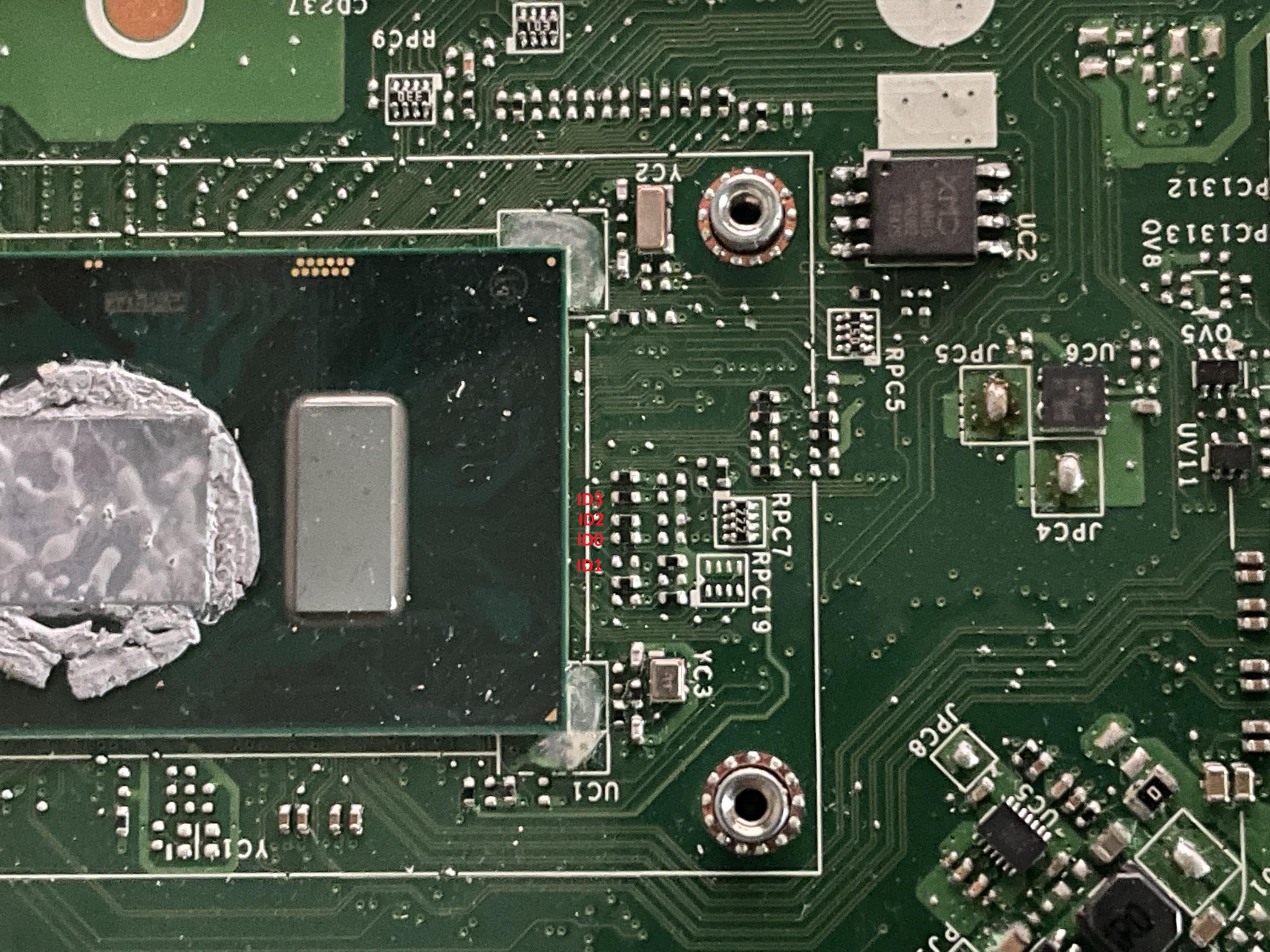

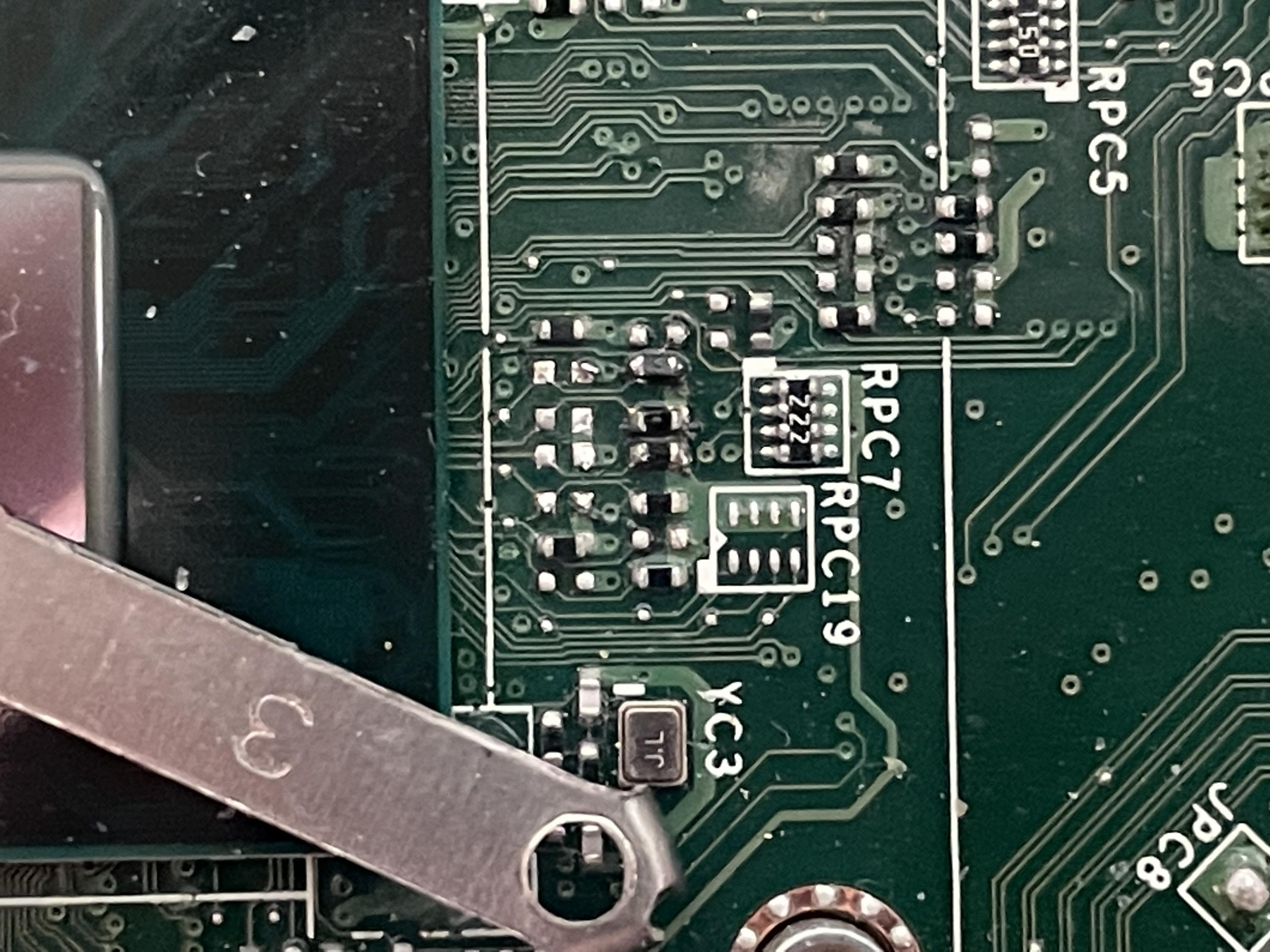

                                    I moved the resistors but I still don't see anything on the screen, I only noticed that the slight flashes are gone, only one when I press the power button
                                    can i do some other measurements?
                                        You are sure you moved the correct resistors. Double check them with boardview. You put a ram stick on the slot-right?
                                        yes, I moved the resistors correctly (see photo), I also tried to put another ram module but nothing
