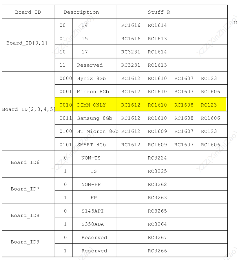

              if somebody is strugling like me with resistors, this will show position of resistors for memory disable

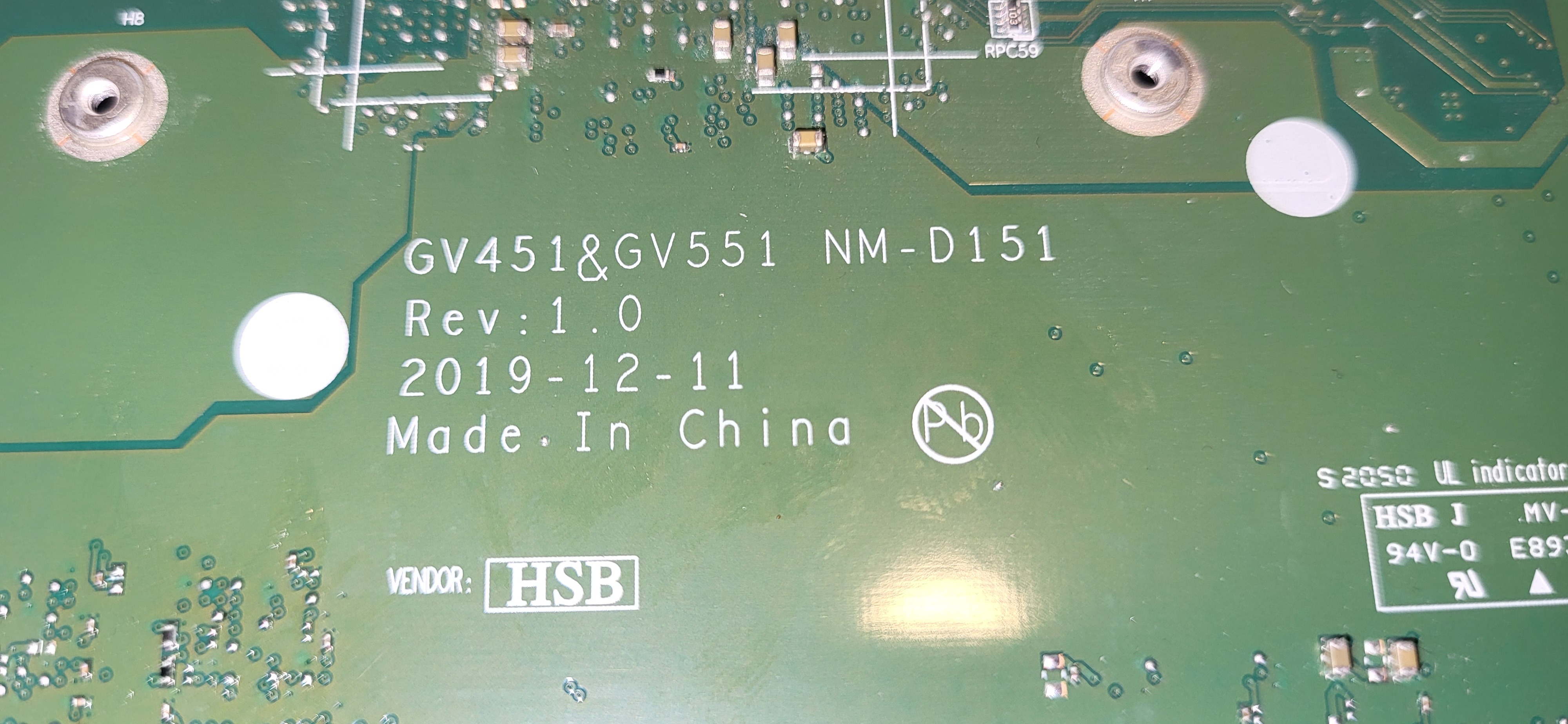

                • Jan Svidek
                  • May 2024
                  • 5
                  • Slovensko
                  I have this board:
                  GV451&GV551 NM-D151
                  Rev.: 1.0
                  RAM on board its bad (Samsung)
                  I moved RC1606 to RC1608 and nothing
                  I added RC123 (2kohm - (serial 1+1k ohm)) and nothing
                  maybe I need new bios ?
                  LCD still black, without battery using 0,39A
                  I searched the internet and here on the forum, but nothing works.
                  can someone help please​
                  • mon2
                    • Dec 2019
                    • 14850
                    #29
                    Double check the strapping of each resistor. With no power, measure the resistance of each position. Compare with post # 26.

                    • Jan Svidek
                      • May 2024
                      • 5
                      • Slovensko
                      #30
                      Click image for larger version  Name:	dimm_only.png Views:	18 Size:	101.9 KB ID:	3276151
                      I have everything as it is on post 26.
                      It still doesn't work​
                      maybe the BIOS is also damaged or? If somebody have BIOS pls upload, or Im try find in forum..

                            Originally posted by ktmmotocross
                            Re: disable unboard ram lenovo ip3 nm-d151
                            This tutorial works 100%
                            Like all the others who give the same instruction only in a different way.
                            It doesn't take much to philosophize.
                            With the BRD scheme and the brain, it is solved without problems.
                            If the motherboard still doesn't work, then you have another problem.
                            My board had symptoms of drawing around 750mA and climbing slightly as the CPU warms up.
                            As soon as I failed with reprogramming the EC and Main bios, I went to disable the RAM memory.
                            Immediately after the first startup of the motherboard, the current began to work variably and the image appeared without problems.
                            So the instruction is checked and works.​
