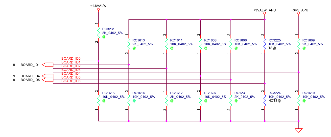

                      which memory placed?
                      • LKB
                        • May 2023
                        • 4
                        • Ukraine
                        Re: disable unboard ram lenovo ip3 nm-d151
                        Originally posted by gs84
                        use boardview to do this
                        What should be done with these resistors?
                        Подскажите что необходимо сделать с этими резисторами?
                            Attached.

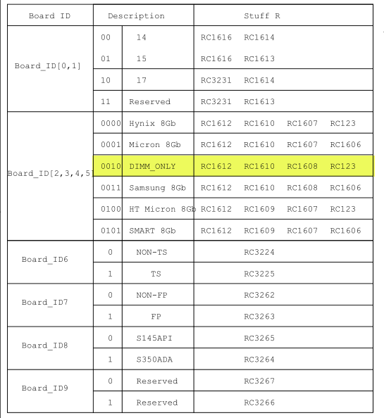

                              Originally posted by mon2
                              Attached.
                              Resistor 2 KOm - 0?
                              Resistor 10 KOm - 1?
                              it is necessary to put : Dimm ONLY 0010
                              RC1612 RC1610 RC1608 RC123
                              2k 2k 10k 2k

                                  • mon2
                                    • Dec 2019
                                    • 14673
                                    More (from the same schematic v1.0 as posted earlier).
                                    • Vesko356
                                      VIP Moderator
                                      • Aug 2018
                                      • 4386
                                      • Bulgaria 🇧🇬
                                      One resistor must be moved only.
                                      RC1606 (10K) ---> move it to RC1608 position. That's it.
